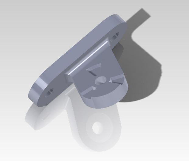

S1000RR Mirrors rendering for HP2 Sport
Ok so last month I posted the photos of the S1000RR mirrors that I purchased and then disassembled to see what it would take to change the mirror base to match the existing hole pattern of the HP2 Sport fairing. It has taken a lot of time between other projects, but I was able to get the design drawn and ready for the 1st test piece hopefully in the next week or so. The bracket will be hidden under the rubber covering and probably can use the stock bolts. I am thinking that it will be better to use nuts on the inside and a small black backing piece due to the increased leverage of the longer mirror. Will post a pic of the test piece after it is grown on the mill.

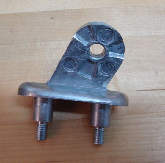

I abandoned all of this for my current solution as it is more appropriate for the masses and looks good, reasonable costs and no mods to the bike.
We made the first S1000RR / HP2 pivot out of plastic today before doing one out of aluminum to see how the design worked. A few more slight changes and I should have it sorted out. I also get 20% off on stockers so can pass that on for those interested, and will proably sell some of the brackets alone and modified new mirrors for those less handy with doing the mod themselves.

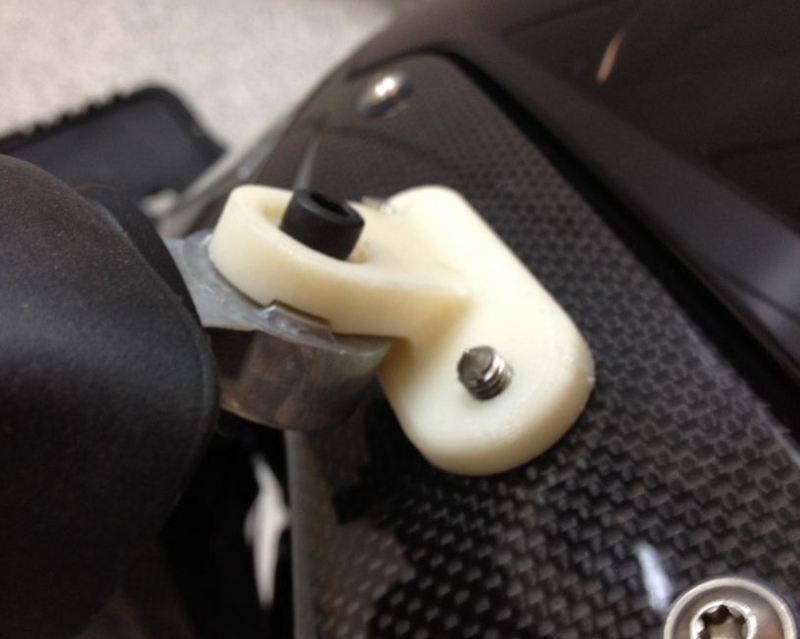

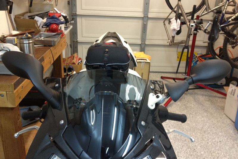

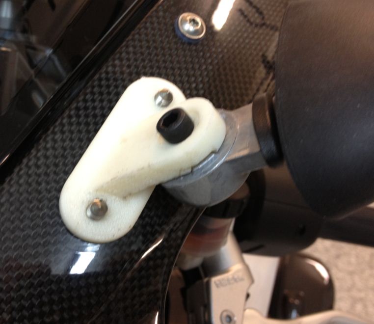

HP2 Sport Mirror update
Sorry for the delay in communicating the progress of these mirror mounts. Had to do some jobs that were necessary to pay the rent and buy a bag of groceries. So here is the latest picture after making about 4 prototypes and making slight adjustments to the CAD file each time. It was made using the quick prototype machine. It is machined out of plastic to save time and money, but the final piece will be out of aluminum and might have a slightly different shape to ease the machining process. The point of the quick prototype is to get all the important dimensions in the correct locations and then it can be transferred to aluminum. Still have another change to make with the female slots to maximize engagement but almost ready for the metal version. Next update will not take as long.
