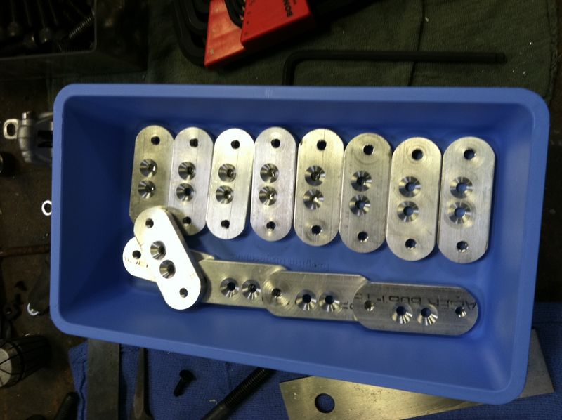

I have recieved a lot of PM's and the mill is running making parts. I am going to add backing plates for the fairing and new mounting crews after my testing. The new mirrors have more leverage being longer so it seems prudent to add stiffness. After testing with the backing plates there was less fairing vibration.I was very happy with the mirrors performance with the angles and stiffness. Mirror vibration is less than the original mirrors. I have ordered some new mirrors for those who want them complete. Should be able to ship some parts next week. Cost wise I am thinking $150 + shipping for the mirror brackets, backing plates, and all the hardware and instructions. For those who want completed assemblies, $150 brackets and $170 for 2 new mirrors converted ready to bolt on.

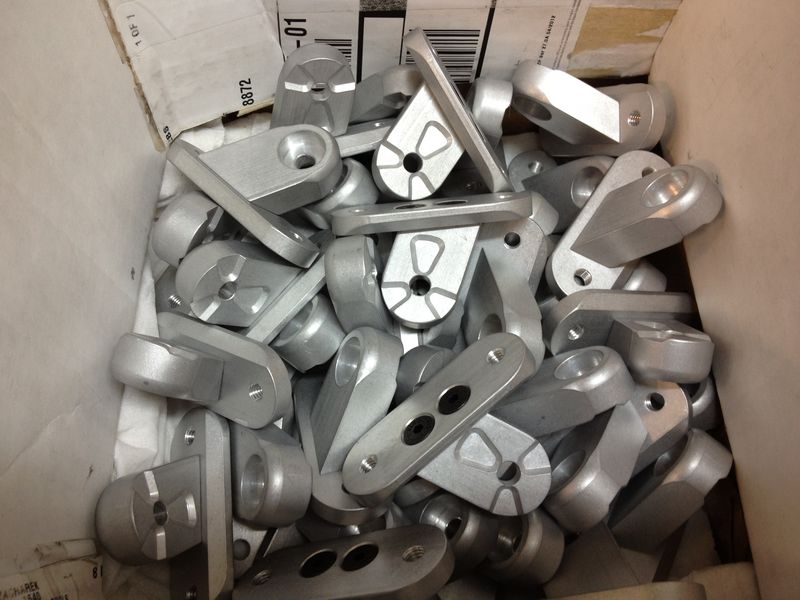

Ok here is the latest update. Finished 19 sets today (would have been 20 but broke a tap) 3 sets of mirrors have arrived and several more on order. Used a tumbled finish but have decided to clear anodize them. This will be completed by the end of next week. This was because I am anticipating some environments will have more humidity and these are under a rubber boot. Probably not necessary but can't hurt. Another production run next week.
