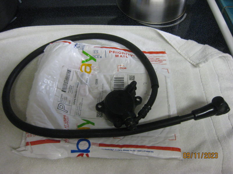

Got my used eBay clutch slave cylinder today - sucker is in very good condition! Also a new gasket and some speed bleeders, so am ready to continue with the job.
Question - do you guys use these speed bleeders or not. Thanks!

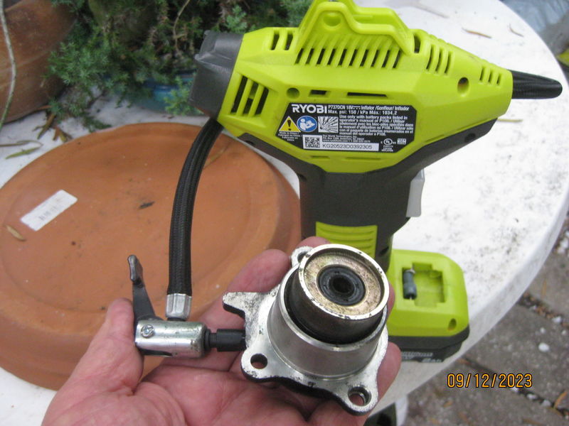

Was a little concerned about getting the piston out but man that puppy popped right out with just a quick shot from my Ryobi inflator!
Talk about good fortune. To obtain a used slave cylinder in this good a condition - I gotta buy some lottery tickets tomorrow!
It won't even need a rebuild - just a little cleaning up!

Yeah, I'd clean that up real good and finally use something like 0000 steel wool, at least, to try to get that bore smooth. Then I'd (of course) use a new rubber rebuild kit and I'd coat everything with Dow Corning 111 or 112 silicon grease. Especially that square-section o-ring that goes into the groove in the piston and rides against the bore.
