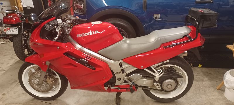

As far as RED versions.....they began in 1990, the first year of the Gen-3 VFR.
I currently have this one - and have another just like it scheduled for transport soon. This was the first model with a single rear swing arm and only came in this colour the first year and also had the White wheels.
My lower fairings are not attached at the moment. Also, you can see another of my Blue versions behind it. I need to sort out a fuel issue with it - otherwise it would be my 4th running Blue one. Hopefully will get to it soon....

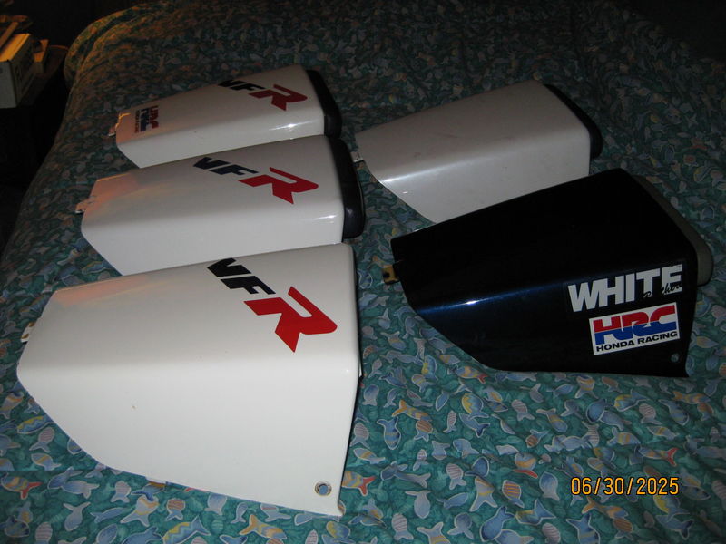

To add to all this....they make a seat cowl that goes over the passenger part of the seat and a lot of the guys like those. I personally like the bikes without the cowl - because I'm weird that way...lol. But have to admit when the cowl is attached it does change the look. And I have a stash of them available for use if I want, too.
Here's a Blue one I just got last week.....and a bunch of others I already have collected......
And how one would look on a Blue bike with a less faded Gray seat.....

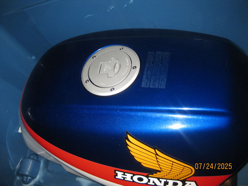

Treating a fuel tank with Evapo-Rust. My latest technique is to put it into a 45 gal. tote while the ER does it's job......
I like to leave it for a week or so.

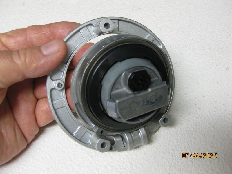

Put a cap on her tonight. The EvapoRust is working great so far!
This cap was NOS! They've been NLA for years so this is kinda a big deal.....

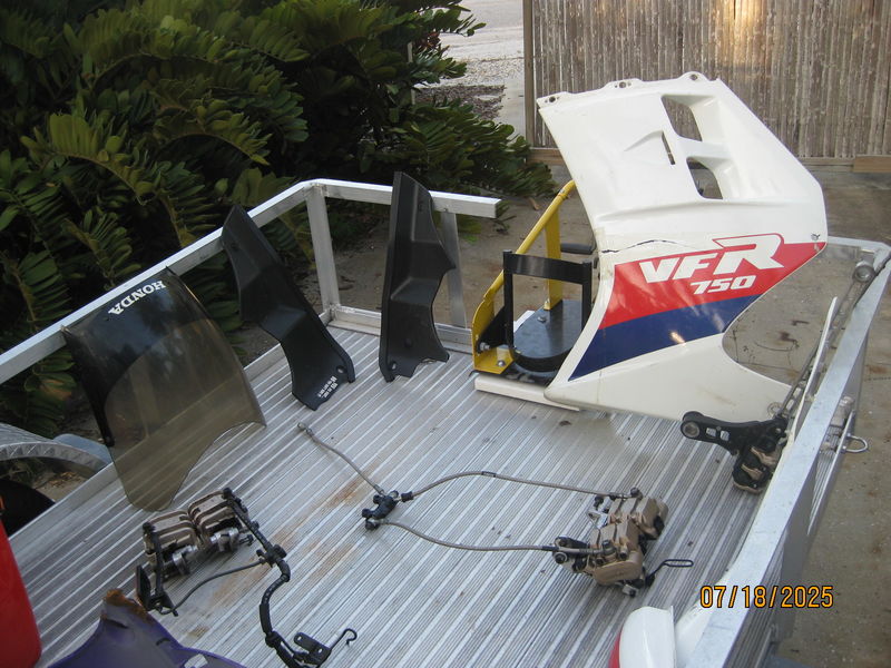

Along with all the parts I got a few weeks ago was this lower RC24 fairing with a huge crack along the middle. Luckily it was still in one piece. I had set it aside for a later repair and last night I decided to at least get the crack stabilized to avoid escalation of the crack.
Here's the fairing on the day I was washing all the parts.....
And what the repair looks like on the rear side of the fairing. I sanded off the white paint along the crack - just on the inside. Then placed aluminum tape along the front side of the crack. Then used a plastic welder to melt both sides of the crack together. Then melted one stick of white ABS flat stock along the crack. Sucker is pretty solid now so will set it aside until the day comes to continue. Probably sometime this winter or next spring when I have the time.
