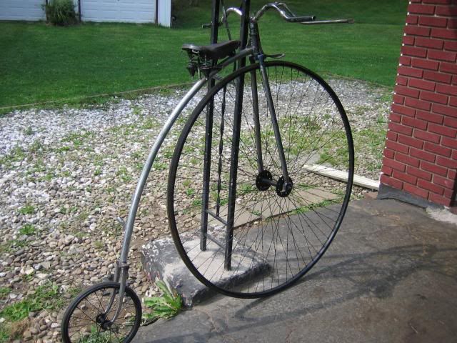

almost done building my penny farthing
Old 08-22-2013, 04:44 PM
  Pelican Parts Catalog | Tech Articles | Promos & Specials    Reply With Quote #1342 (permalink)
Model Citizen
herr_oberst's Avatar
Location: The Voodoo Lounge
Posts: 20,232
Cool! Could you favor us with some details? Scratch built? Where'd you get the wheels?

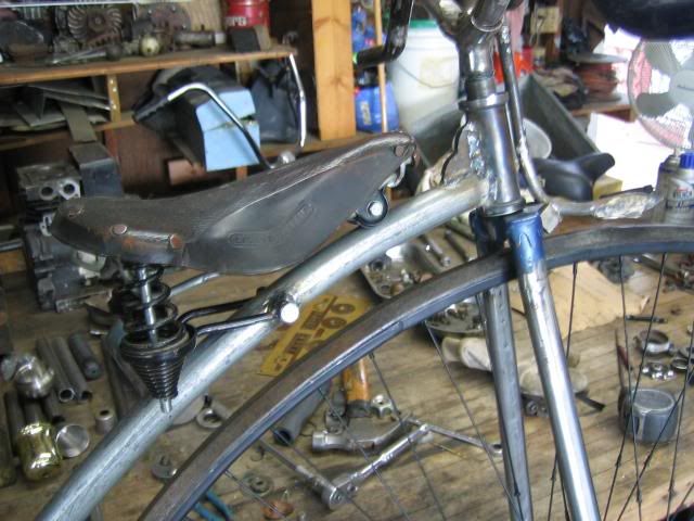

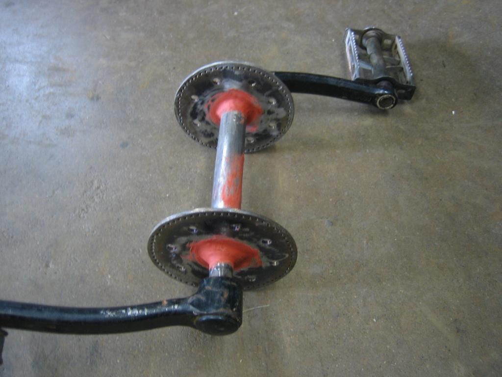

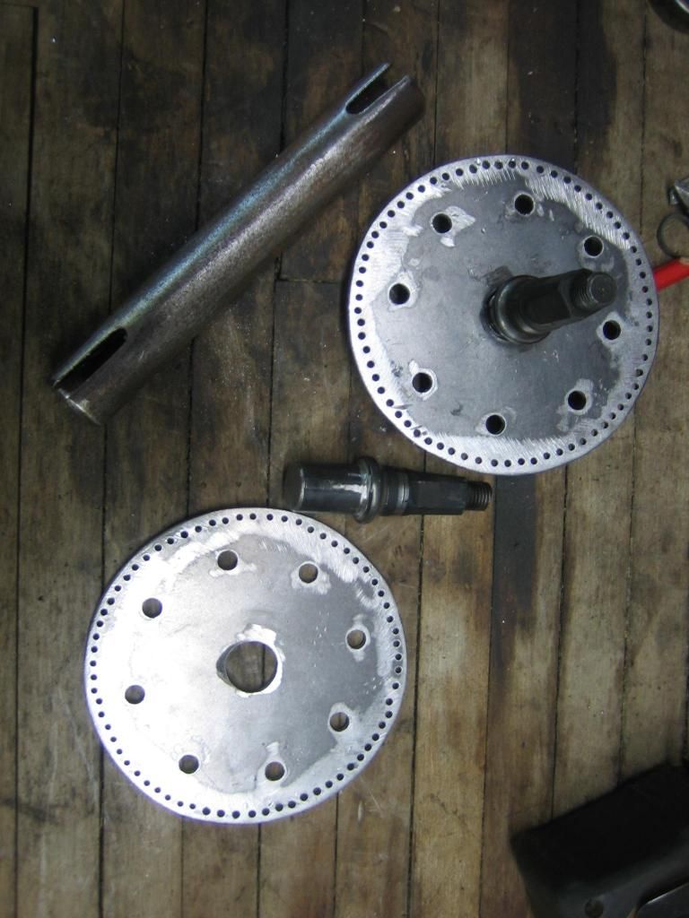

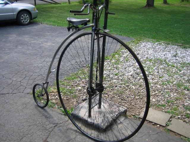

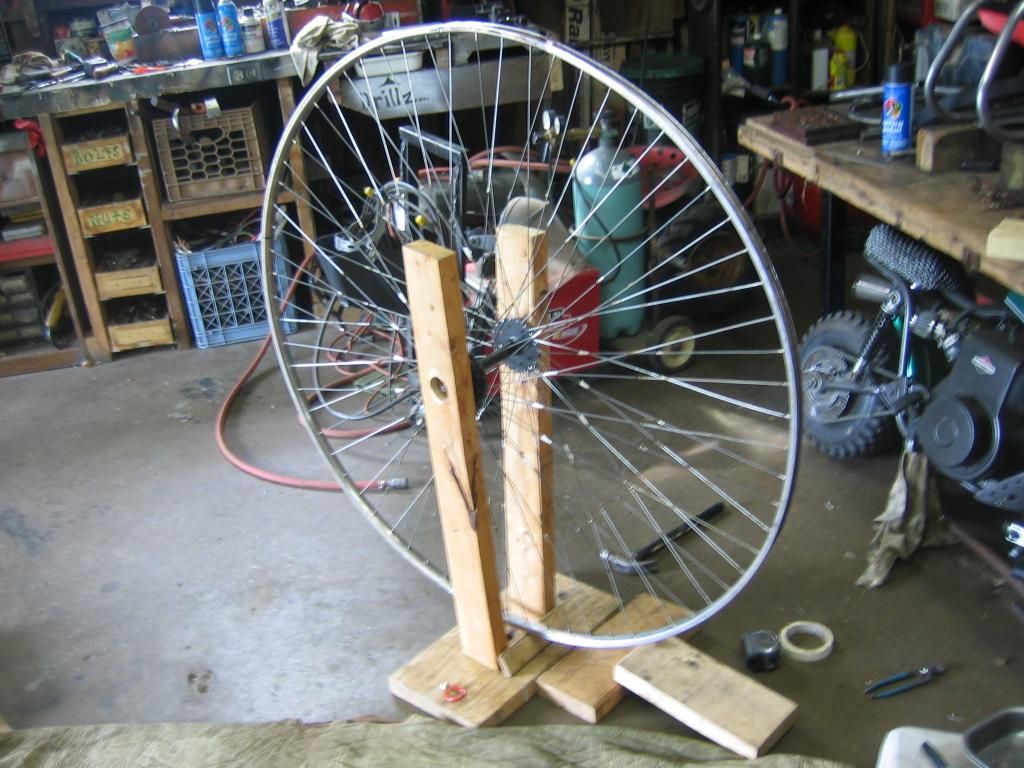

Posts: 7,672
completely from scratch the front wheel is two 26" mountain bike wheels stretched out i used the spokes from those wheels i just double threaded the outer ones to make up the difference. the hub i made from scratch. drilled twice as many holes as i had too. doy.. the tire is solid tires from a wheelchair. it took two and a chunk since they are 24". the rear is a 16" kids bike wheel that i made a tire for. shortened the rear fork and extended the front. after I figured out the front wheel everything else was just a matter of making it how I see it in my head. Lot of work for a bicycle but its worth it for a bike like this . Cant wait to ride it
Old 08-22-2013, 07:39 PM
  Pelican Parts Catalog | Tech Articles | Promos & Specials    Reply With Quote #1345 (permalink)
That is going to be so fricking cool, let me know when you tire of it
You have huge talent Sir..
Now, that's a truing stand. I wonder if that's how they use to do it? Way cool.
