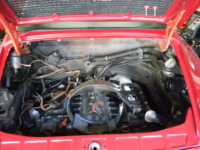

Step 1
Out with the bad air........

al lkosmal's Avatar
Location: mt. vernon Wa. USA
Posts: 8,759
ITBs
Making progress...........stock intake and Motronic controller and associated wiring is gone..... new controller/wiring, etc underway...Fan/shroud cleaned up nicely and ITBs in for trial fitting....A ways to go, but starting to look real....

Old 03-24-2021, 06:11 AM
al lkosmal's Avatar

Old 03-24-2021, 09:48 AM
al lkosmal's Avatar
Posts: 8,759
Originally Posted by mikedsilva View Post
looking good as always
How do you mount your vacuum collector block?
Mike,
Greetings.......I use tall Hex standoffs off of the front breather cover mounting holes and then I make a simple Stainless sheet metal mounting bracket that mounts to the standoffs and the bulkhead......this provides a sturdy platform for the vacuum block and IAC valve.....
