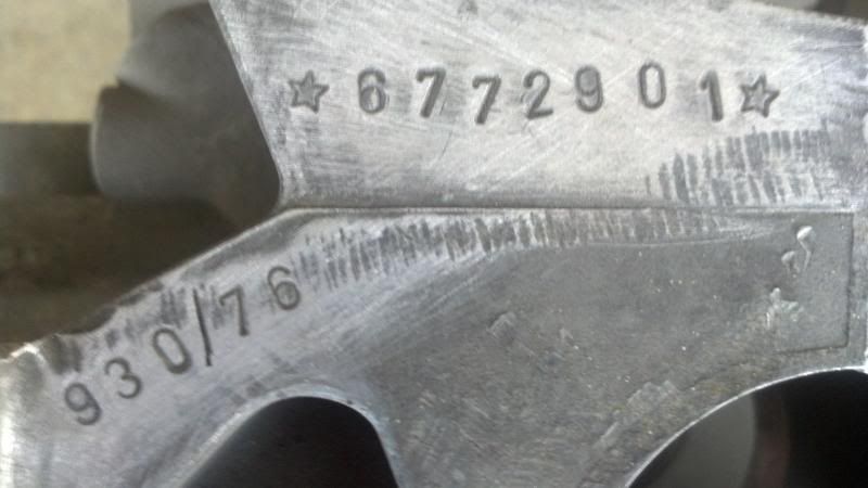

Anyone want to take a crack at this one I found in my loft?

Posts: 419
930/76. 6772901
1977 935 3.0 litre?

Originally Posted by jrbennett View Post
930/76. 6772901
1977 935 3.0 litre?
Looks like we have a winner!
I just looked it up too... I was not sure when I dug it out but according to Bruce Anderson's book the 930/76 ( 3.0 twin turbo) replaced the 930/72 in the 13 built customer cars in 1977
A bunch of old race cars
