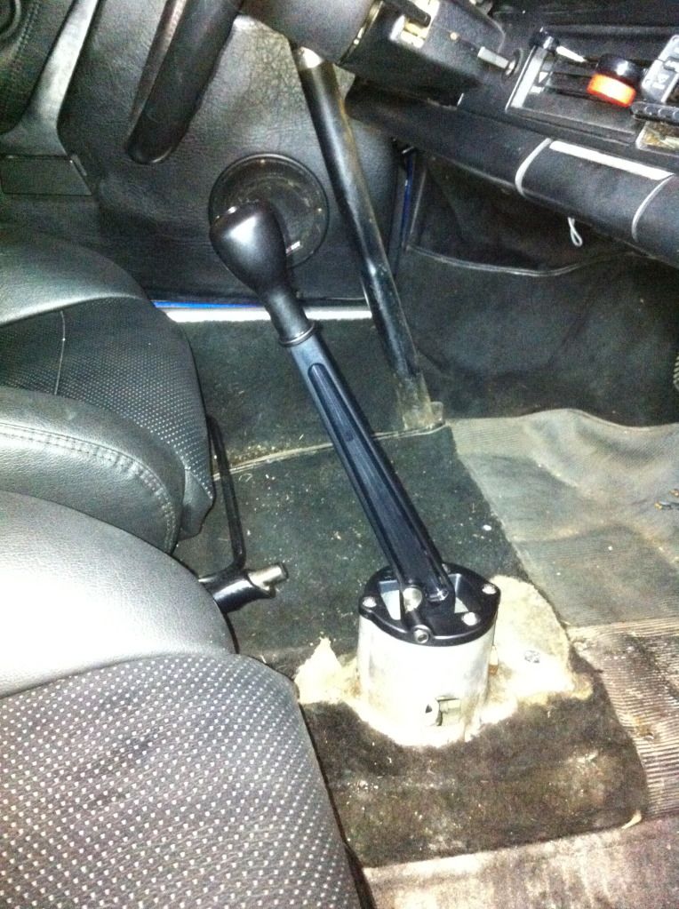

I have a Wevo shifter and am very happy with it. $600 happy hmm yeah prolly. The feel is good and the quality is there in the parts. Easy job to do along with the coulpler bushings. If you set it up right you will be very happy.
I got the "tall" as I like to keep both hands close to the wheel.
Just after insall before the centre consol was put back in.
Ex Porsche Cup car with some boost and stuff.
