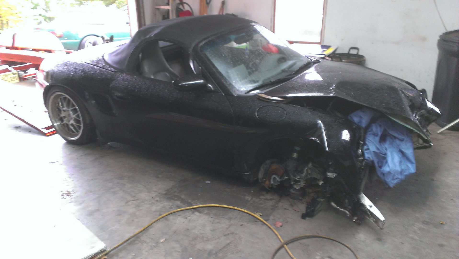

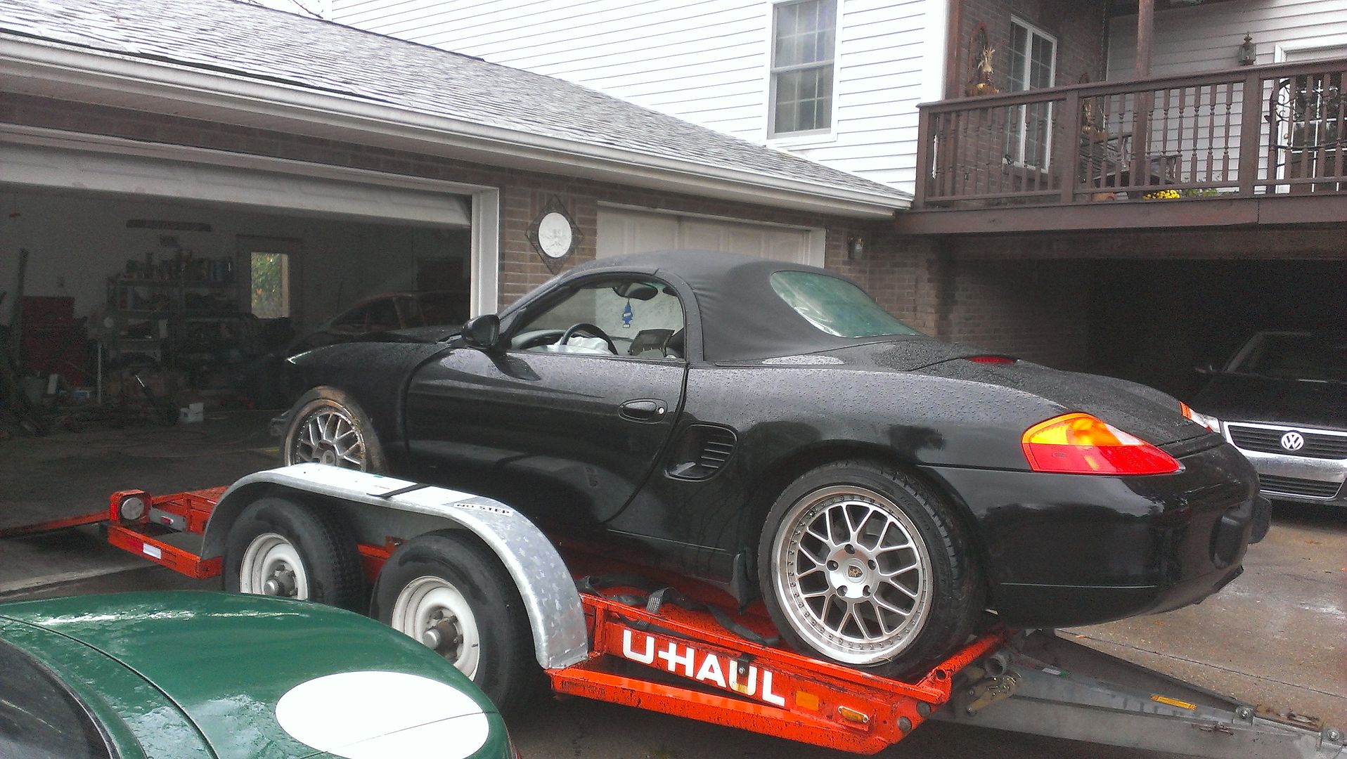

911 long hood restomod mid engine or awd?
I'm in the middle of my restomod build and i'm trying to decided it if I rather go mid engine than AWD. The car is a 1970 911E rust bucket. I my original plan was to build a awd long hood. That would be reliable handle good and something I could drive year around rain or snow and take it to the track on the weekend. My plan consisted of using 996 c4 drivetrain and floor pan. However I got a great deal on a totaled 01 boxster with a clear title, it runs but is not currently drivable. My plan with the boxster was to use the front front suspension buy 996 c4 hubs use all the mounts and floor pan use the engine and sell the trans and buy a 996 c4 trans and front diff, then sale the rear suspension and buy 996 suspension and fabricate the rest.
That said I have been considering converting it to mid engine reusing most of the boxster. Any thoughts on this?
The 911 getting ready to go on the rotisserie.
The boxster

Since you scored the Boxter and have a usable drivetrain, my gut would be to go with what you got and do the previously mentioned electrical mods to regain control of everything. Could even entertain the idea of going with an aftermarket EFI setup and run a MegaSquirt, or something to that effect.
I'm always going to recommend to keep it all P-car, but that's for my own selfish, Porsche enthusiast reasons.
With the tub you're starting with, this is the ideal opportunity to also reiterate my original suggestion of doing a tubular chassis to replace the compromised structure you're working with on this car.

It would be the easiest if I just went mid engine reusing all the electrical and most of the chassis. it would keep it a porsche, but i'm still worried about the engine.
