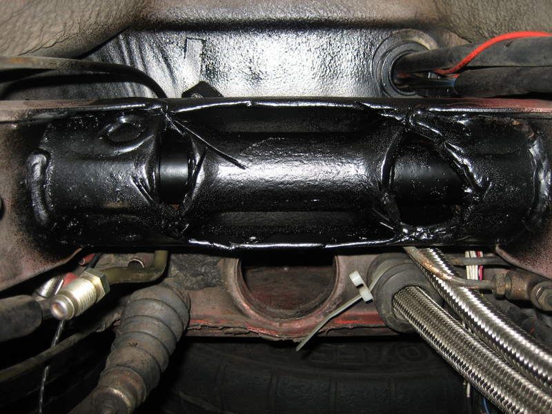

Originally Posted by ALEX P View Post
would really like to not have to cut into the torsion tube
You may still have to at least cut the cover away to get the extra half inch you need. My '77 did.
There's a one photo on this thread that'll give you an "oh, OK" moment: http://forums.pelicanparts.com/porsche-911-technical-forum/440191-verify-g50-shortened.html
The welded cover is just a welded cover. It's OK to cut some of that away.
Some cars don't need it; I've heard of earlier ('74) and later (SCs) with G50's that didn't need this, no-one seems to know quite why some do and some don't....
It’s funny isn’t it – you would think they were all the same!
So if you cut the torsion bar cover away as in the photo below then do you just leave it open?
Does it have any adverse affect on the strength? If it literally is just cutting a window in the tube and treating it to some rust prevention then that’s not too bad but didn’t really want to start breaking out the welded as it always seems a slippery slope!
