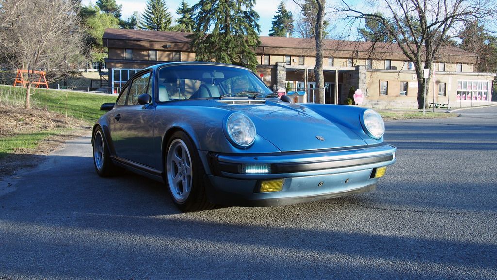

All that is missing from spoke's package are the rear flashers.
I recently ordered the front position lights/flashers, 3rd brake light, rear brake lights and rear position lights and must say that I'm very happy with what I received and spoke's service.
The only extra I had to do is purchase and install an EP36 relay, which corrected the hyperflashing.
Here's a pic with of the front end with the new position lights/flasher combo.

Question,
In order for the new position lights to be illuminated, did you have your parking light switch on or are they pulling power on their own?

I manually pull the switch whenever I want them on.

...The only extra I had to do is purchase and install an EP36 relay, which corrected the hyperflashing.
Luigi, the fronts look good.
About the EP36, Luigi found out the part number "EP36" is an old number being reused for LED applications. The first EP36 he purchased was an old, non-LED compatible flasher. If you buy an EP36 flasher, make sure it says "LED-compatible" on the package or part.
