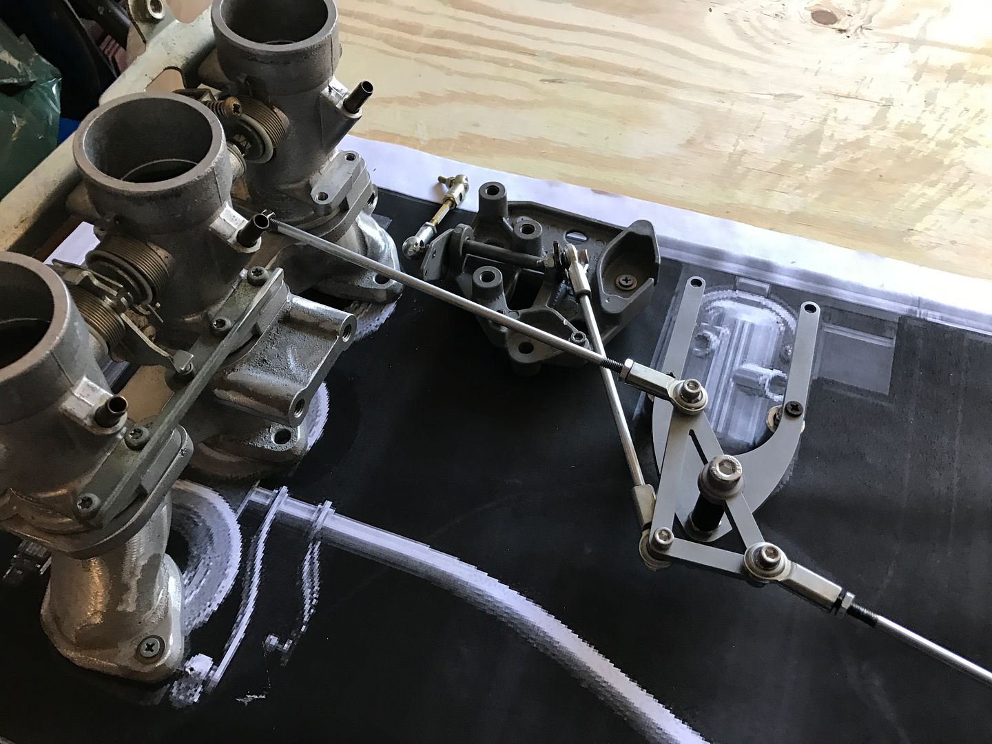

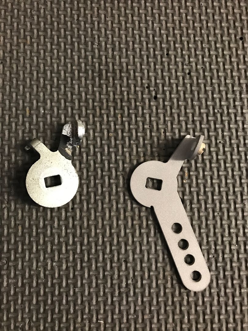

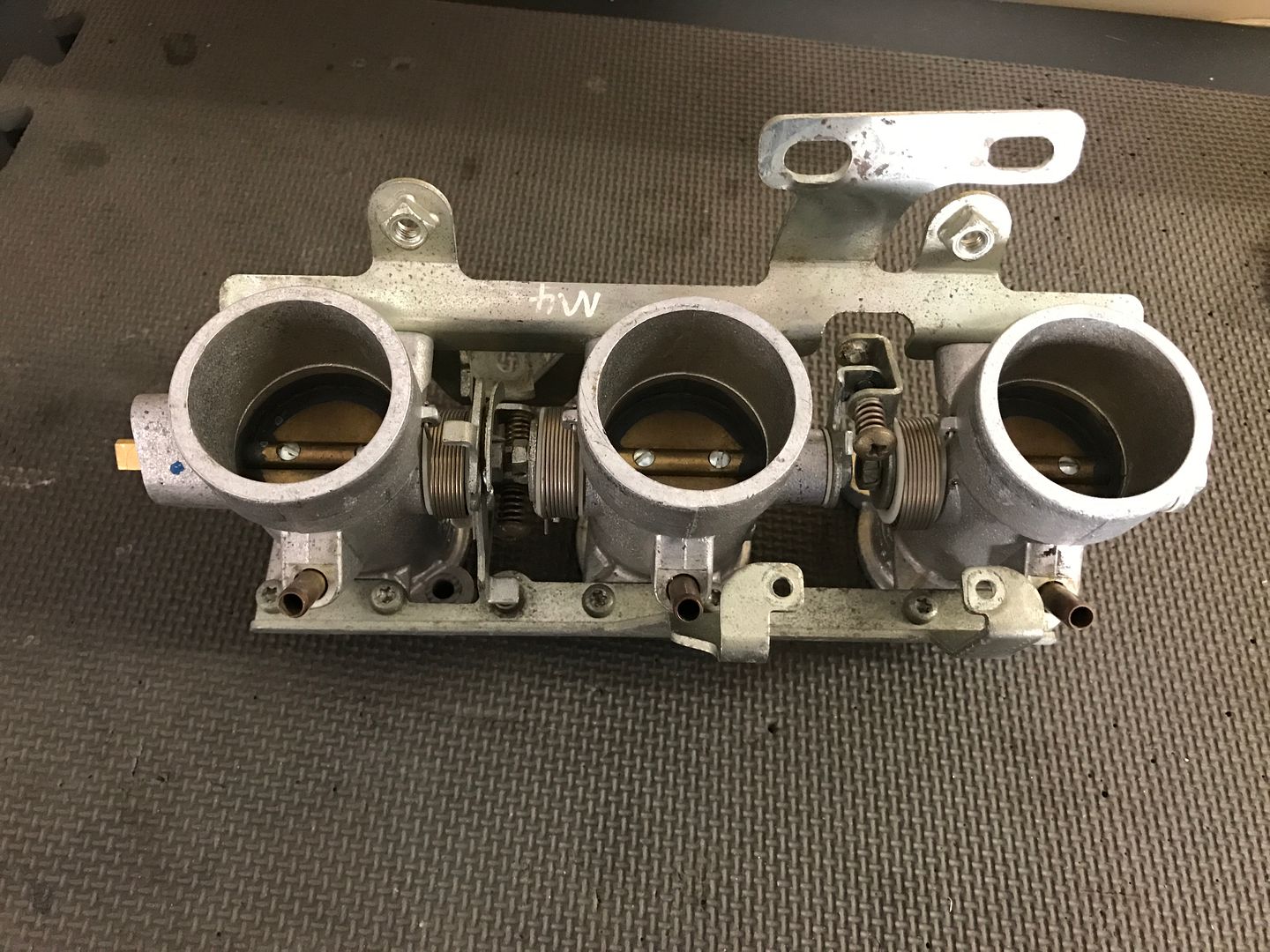

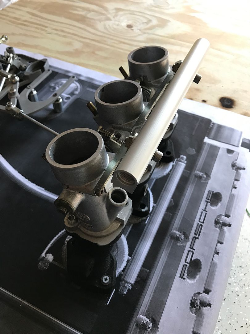

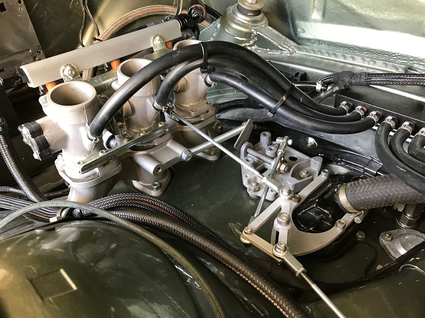

It's been awhile since i've updated this thread, but I have continued to tinker with my setup.

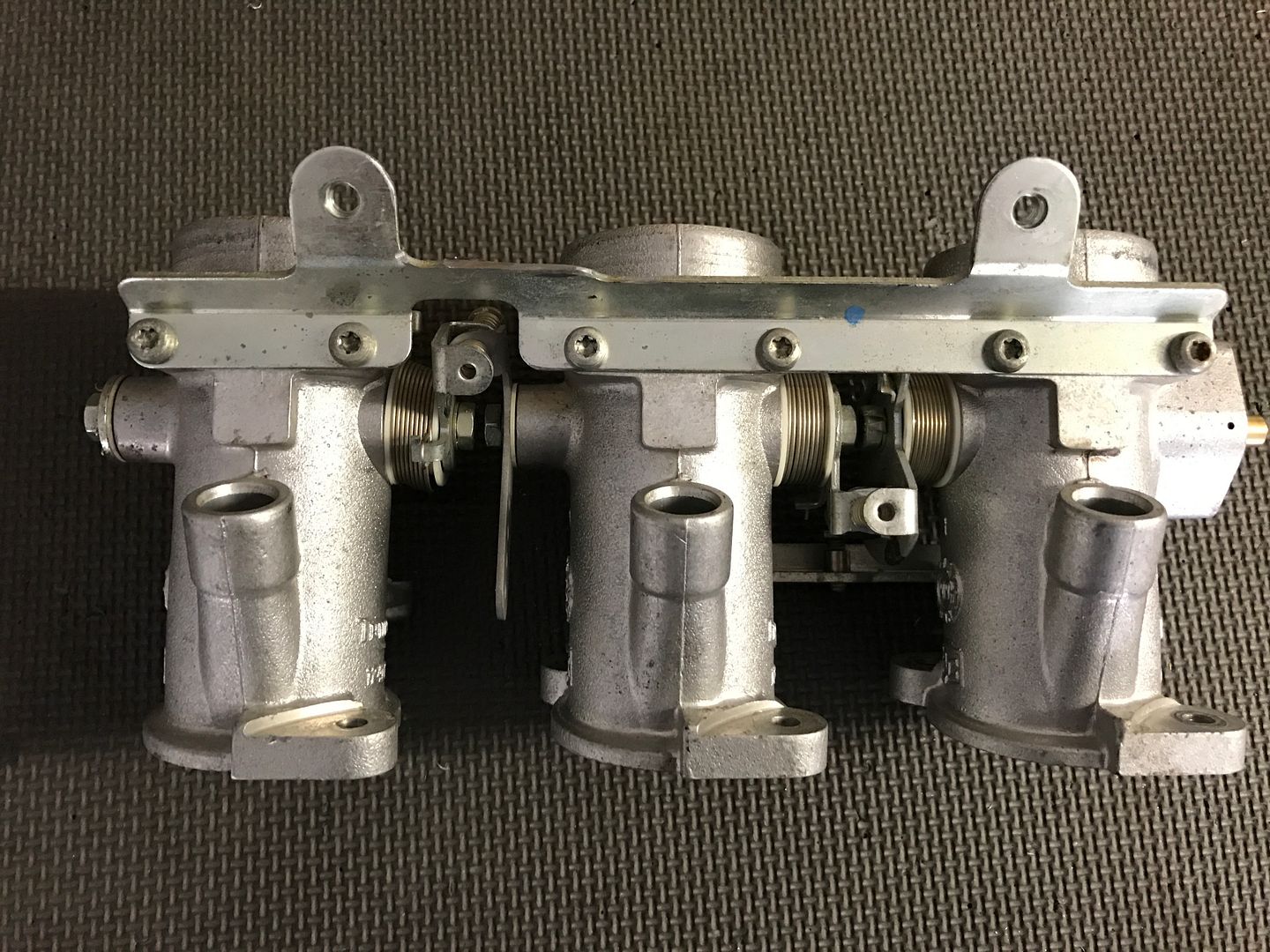

First up, was the linkage. The modified PMO/Weber crossbar setup worked well, but once i installed the rainhat airfilters, it limited the range of motion.
So here's what I did:

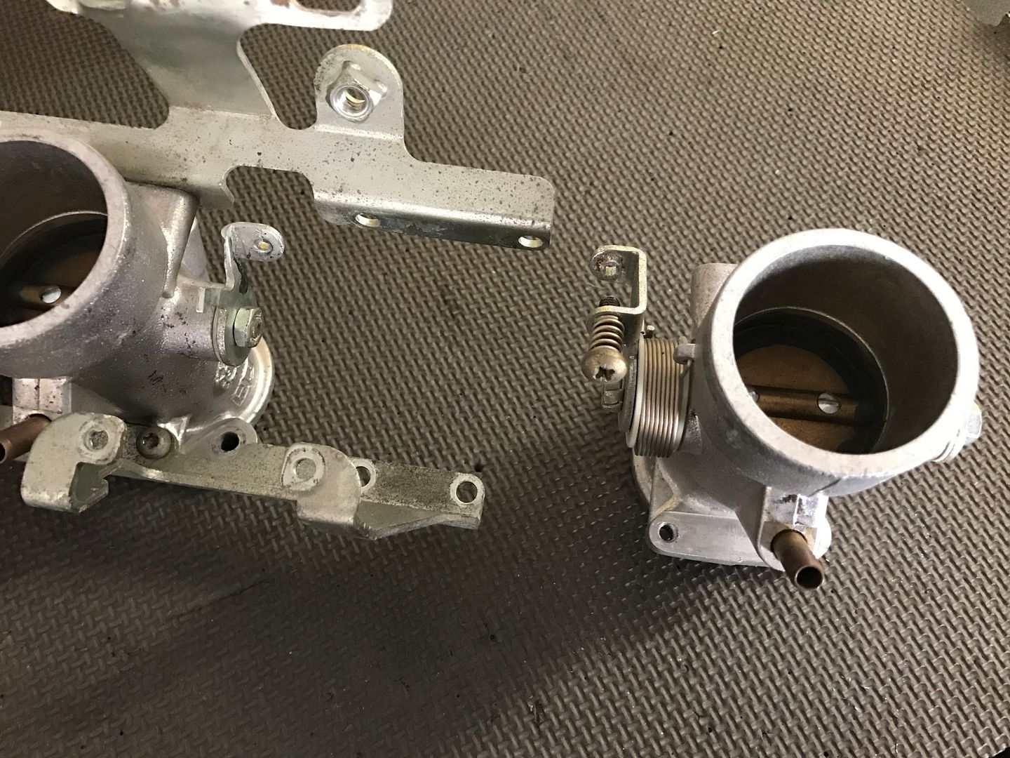

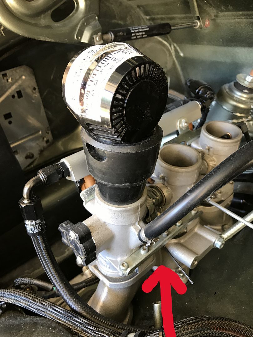

The fuel rail and idle stop bracket have accessory brackets on them that will no longer be used and interfere with the new linkage.

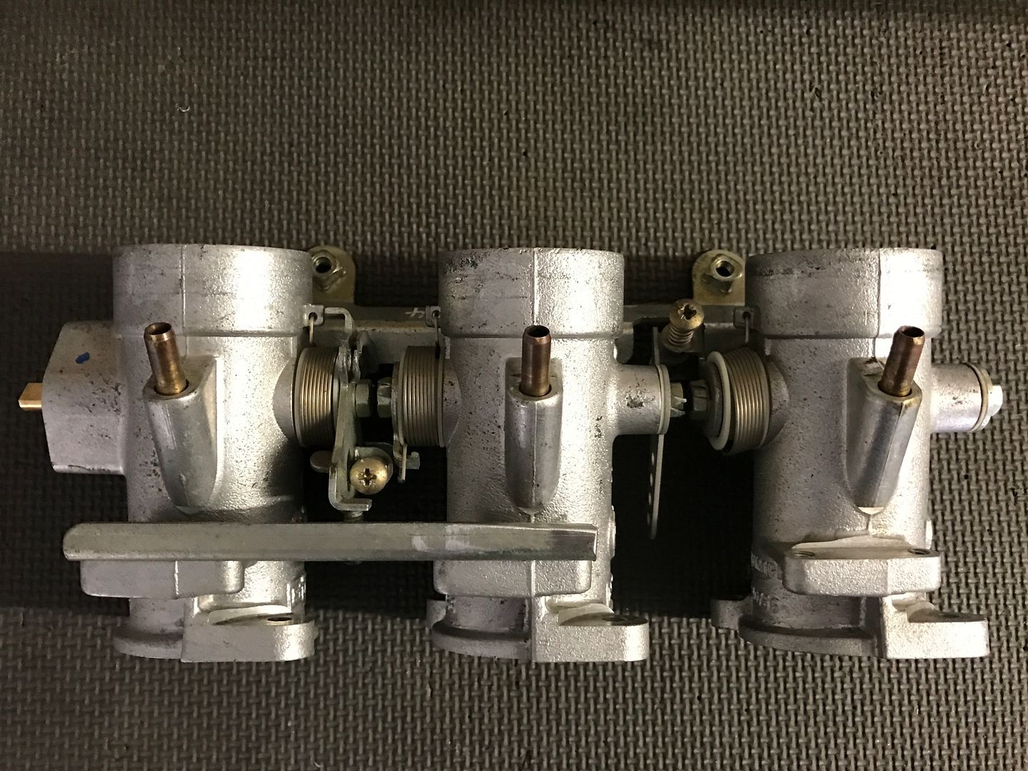

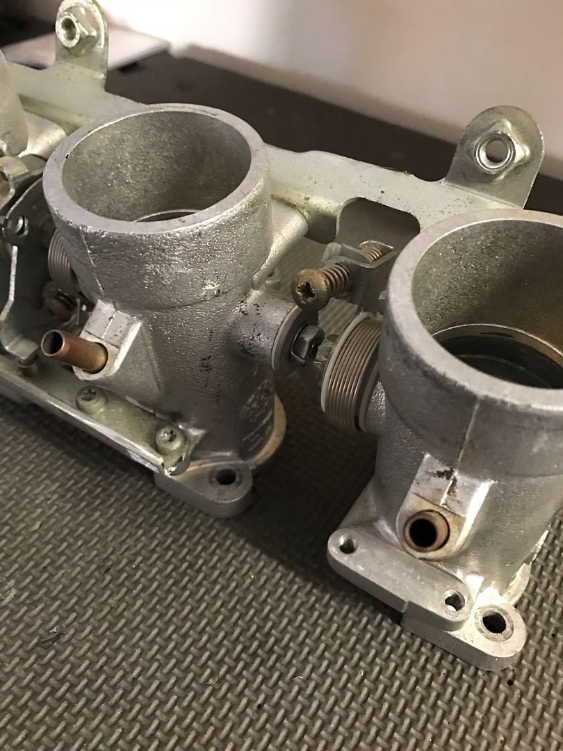

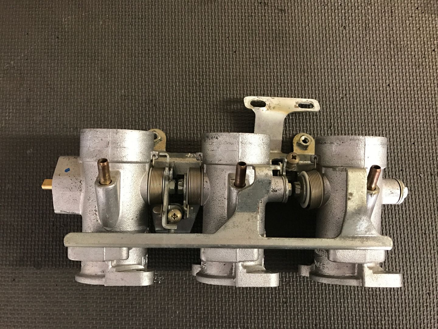

Remove the throttle body on the end without the throttle position sensor by removing the 4 torx screws
Note: There is a spring between the linkage that will fall out, save this.

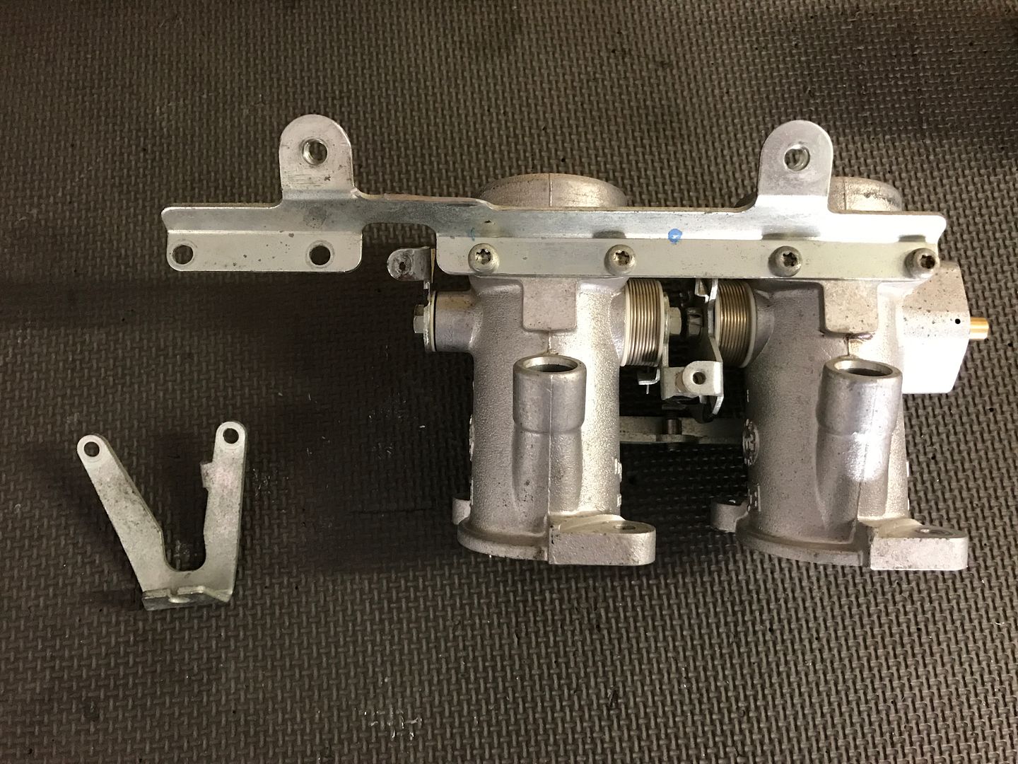

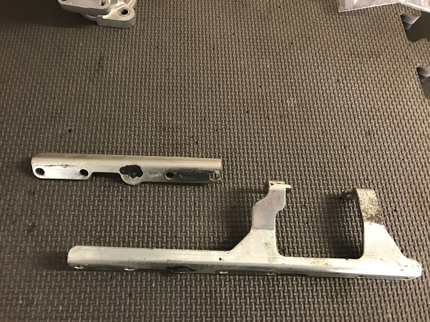

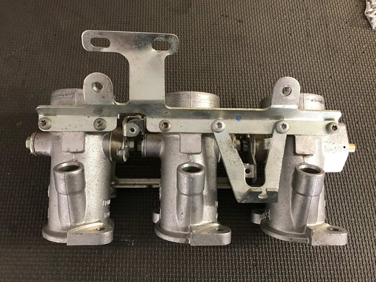

Cut the ITB bracket to remove the vacuum brackets and shorten it to only connect to the first two throttle bodies
Cut the fuel rail bracket to remove the extra bracket. Reinstall without the cable linkage bracket.

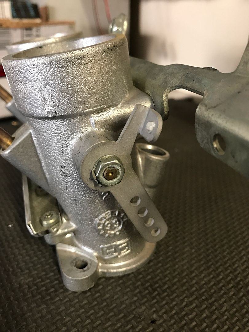

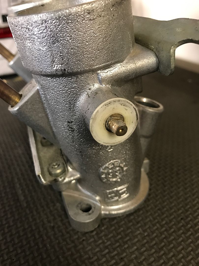

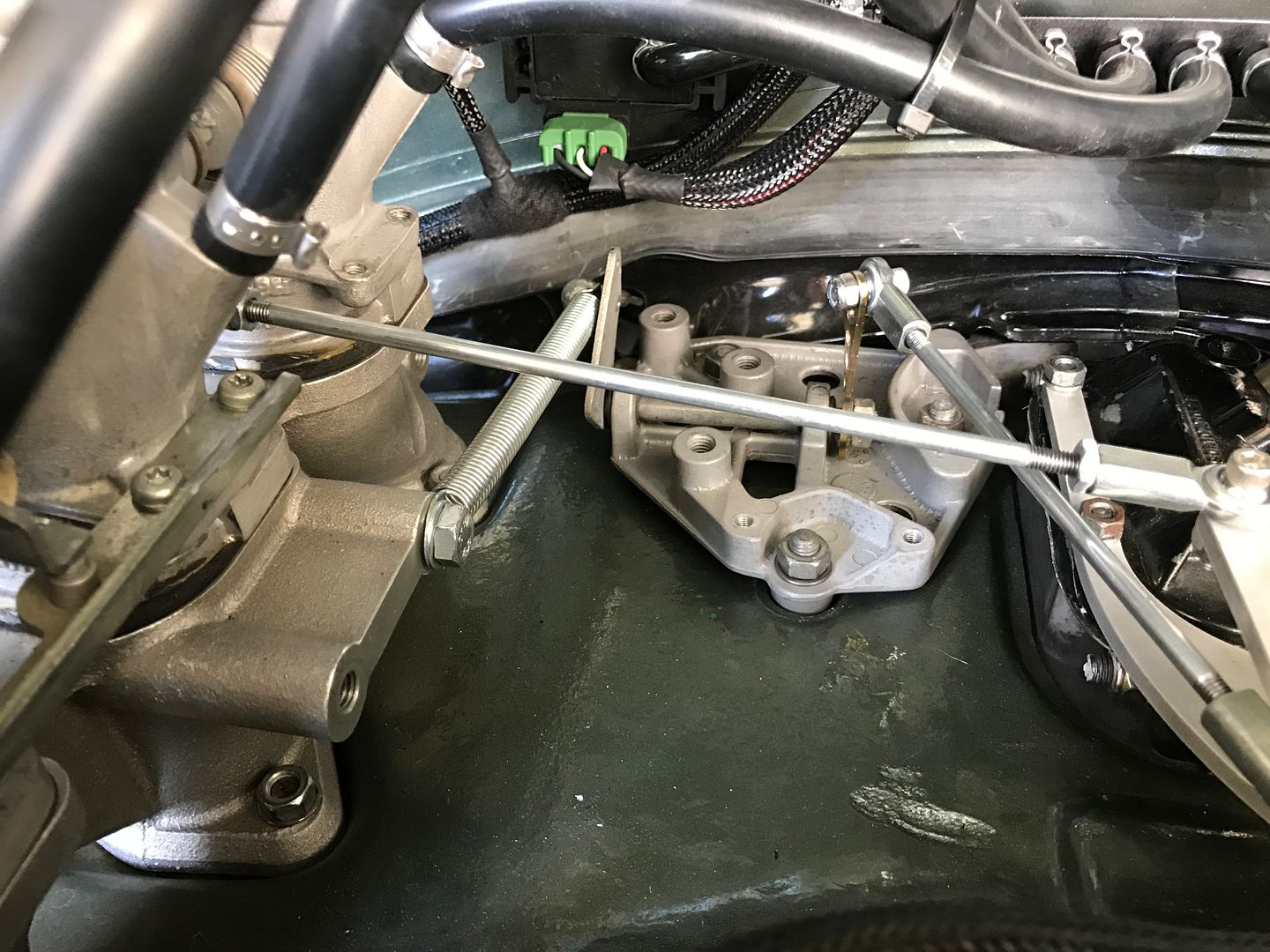

Once the end TB was out of the way, the middle linkage arm was replace with one I made

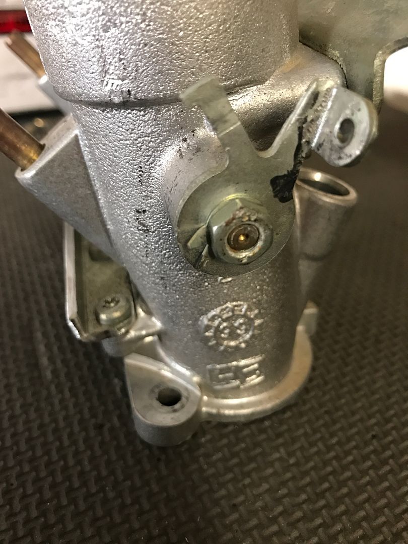

The Triumph linkage arm is held on with a 10mm nut. There is a lock washer with tabs that must be bent over prior to the nut removal.
Leave the nylon washer in place.
Install the new linkage arm. Reinstall lock washer and 10mm nut. Bend washer tabs up.
Old 04-26-2017, 05:48 AM
Join Date: Apr 2003
Location: Houston
Posts: 567

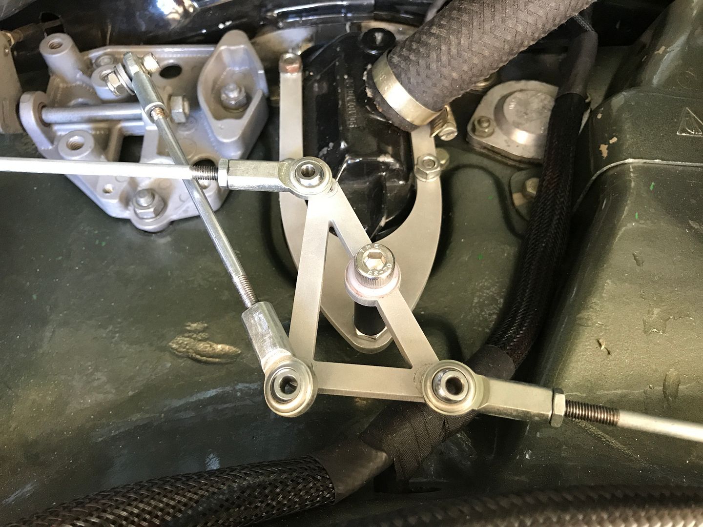

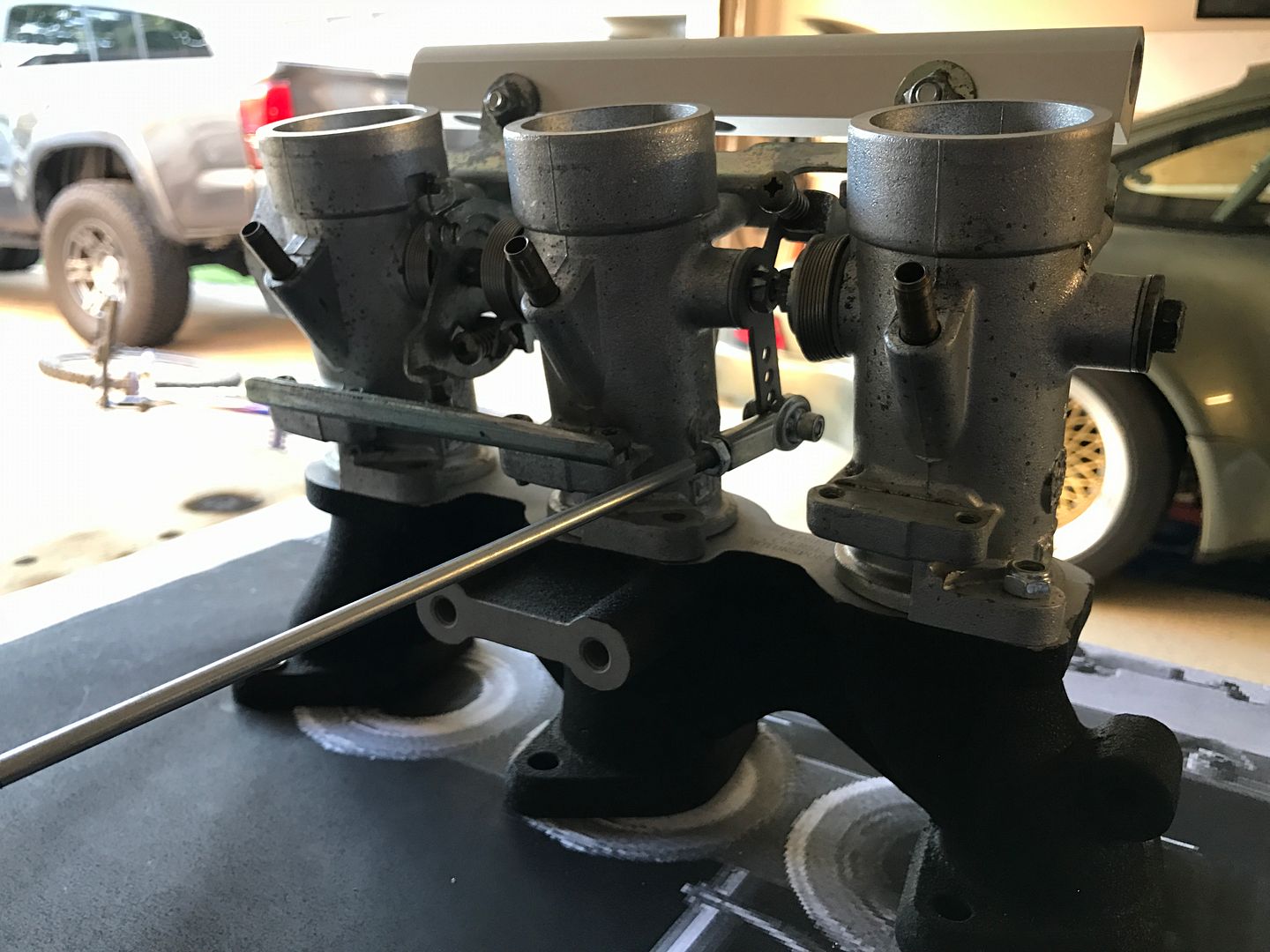

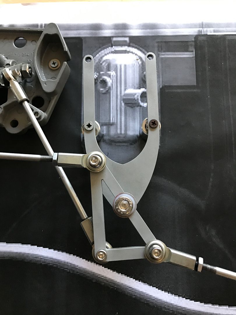

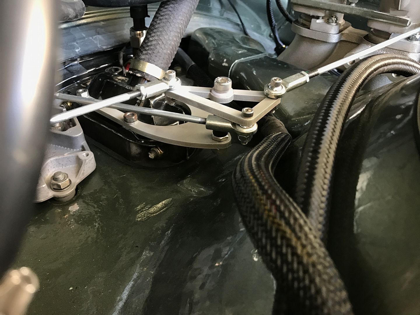

Then re-installed the fuel rail bracket with (6) torx screws.
Reinstall the linkage spring between the new linkage arm and the old one.
Reinstalled the modified idle stop bracket.
Then the linkage rods are attached to the new linkage arms

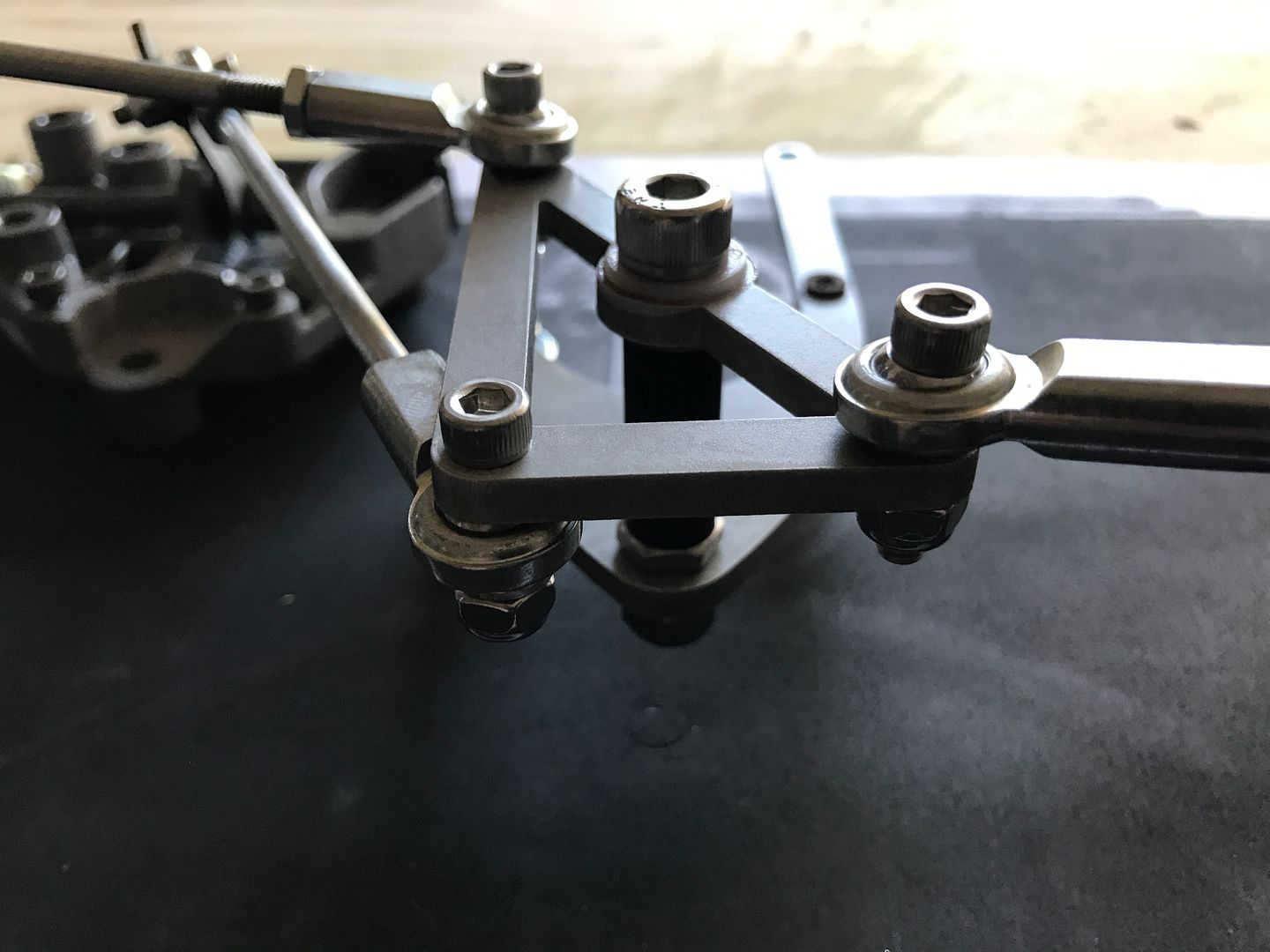

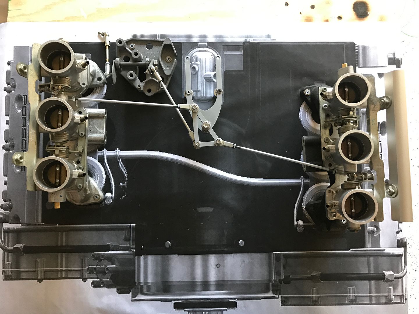

For the center pivot I waterjet cut a bracket that attaches to the oil breather and with some hardware and nylon washers provides a base for the linkage to tie into and pivot on.
Then used linkage rods with swivel ends to connect it all.

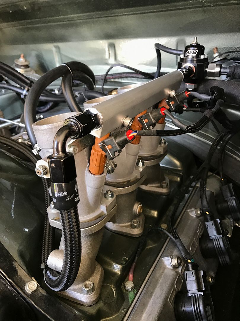

I also had some fuel rails made with -6AN threads on the ends. The early Triumph motorcycles came with aluminum fuel rails, that I had, but the later ones came with plastic rails. The new rails replace the plastic ones, and are much cleaner than the stock triumph aluminum rails.

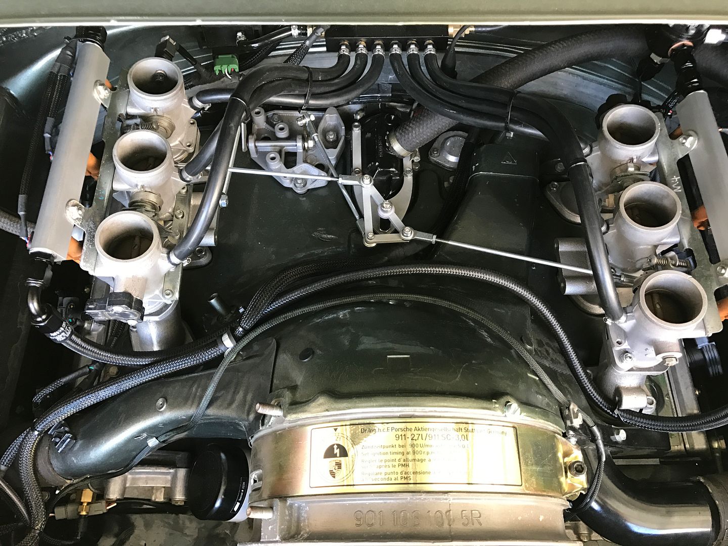

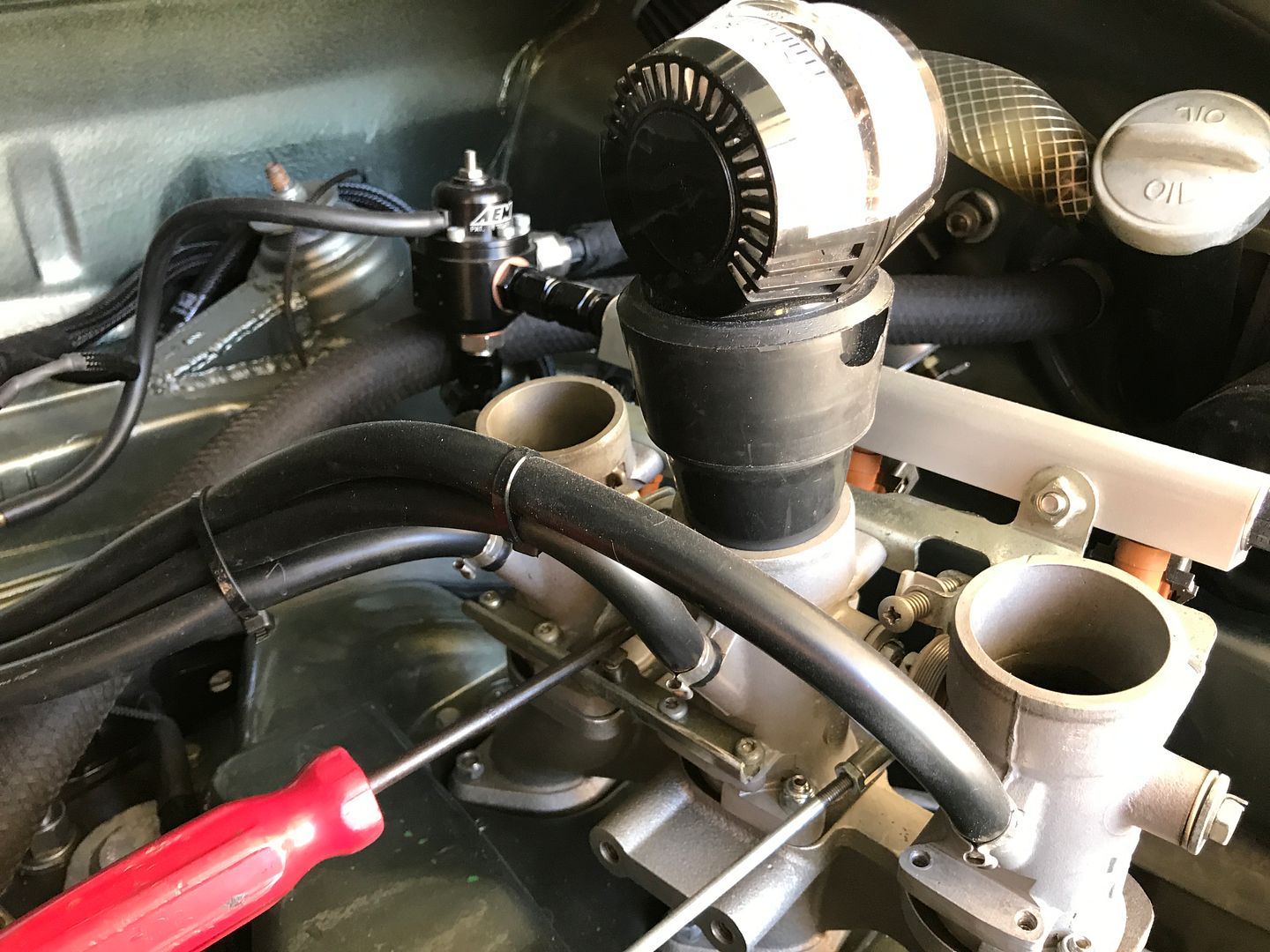

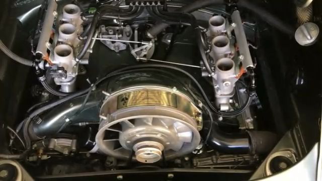

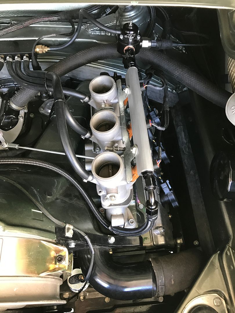

Thanks guys. I realize I didn't post the new setup installed
And a video of the linkage in motion:

Hey Clay,
Any reason why you didn't put the new linkage arm between 4 and 5 on the left bank? Woudn't it be straighter?
Nice work again!

Posts: 567

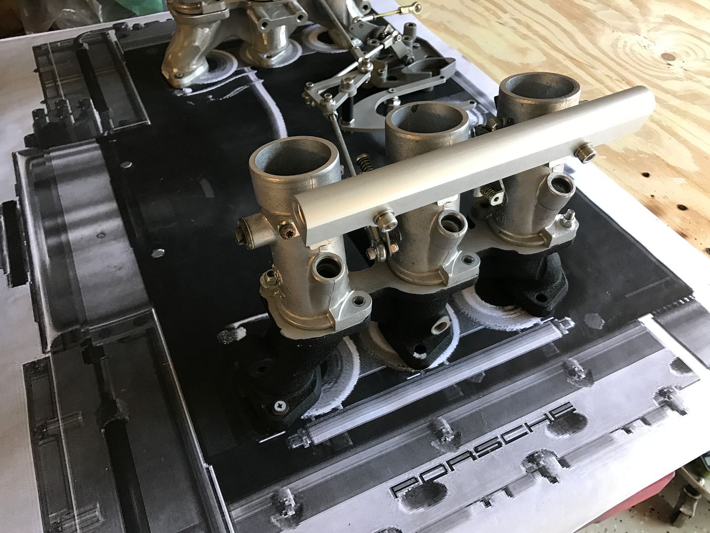

Originally Posted by jpnovak View Post
Love the mockup workspace table image.
Thanks man, it is simple, but was a huge help and saved me from taking my car apart every time I wanted to mess with it.

Originally Posted by DeRRis View Post
Hey Clay,
Nice work again!
The throttle stop is located there and its not worth moving in my option.

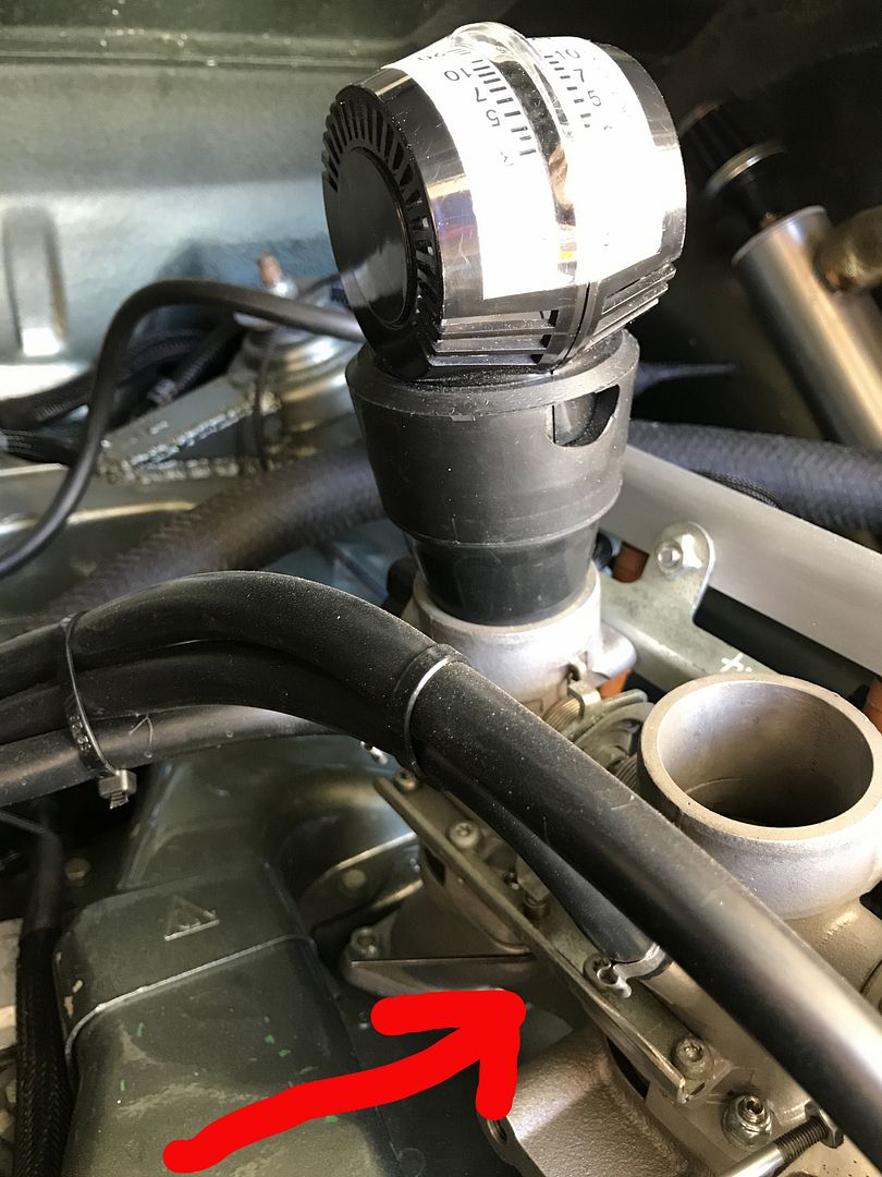

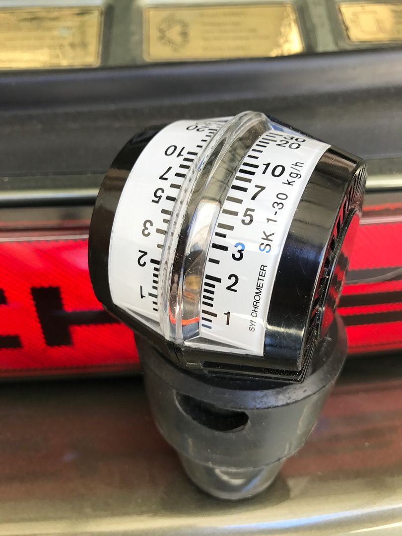

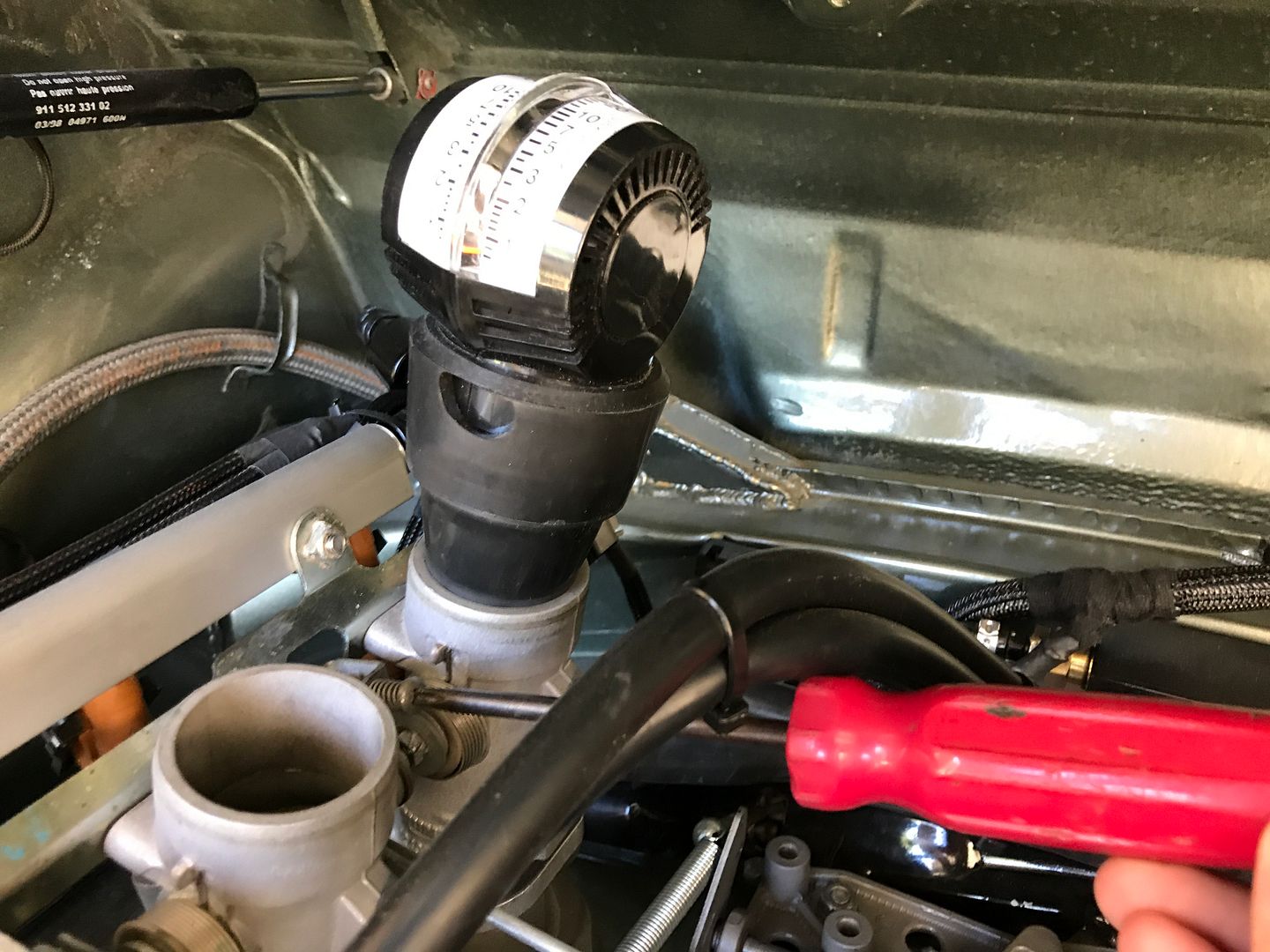

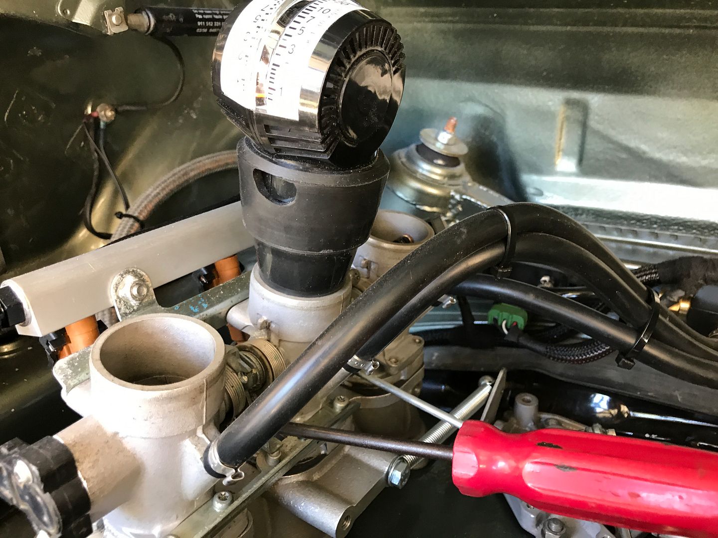

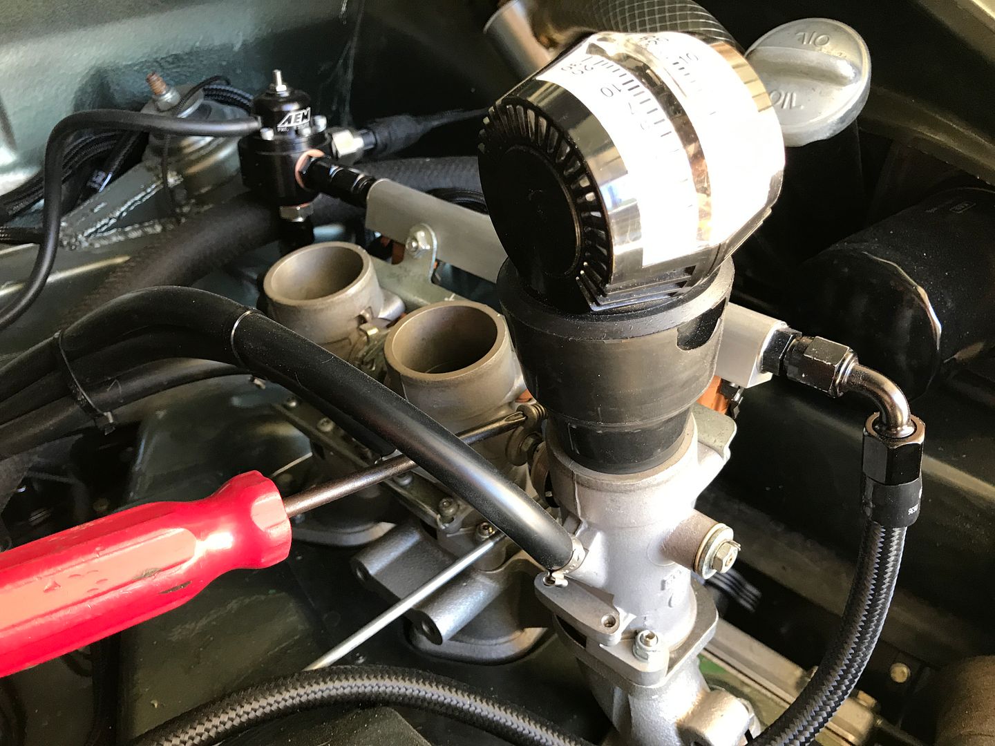

Here is how the linkage is adjusted to balance everything out.
A synchrometer, available from the host (Part #: PEL-PMO-STE-BK), is used to measure the kg/h at each cylinder.
First, the 3 linkage rods must be left loose at the center pivot
With the car running, likely roughly, start at cylinders #1 and #6. They are adjusted with the throttle stop adjustment screw. This is a 2.5mm allen head. Turn the screw in and out to get an kg/h reading of about 5-6 which should set the idle around 900-1000 rpm.
Old 04-30-2017, 02:34 PM
Join Date: Apr 2003
Location: Houston
Posts: 567
Repeat on the right bank on cylinder #6
Once both idle stops are adjusted evenly, the engine should be running much smoother.
Next up is to balance each bank, starting at cylinder #2

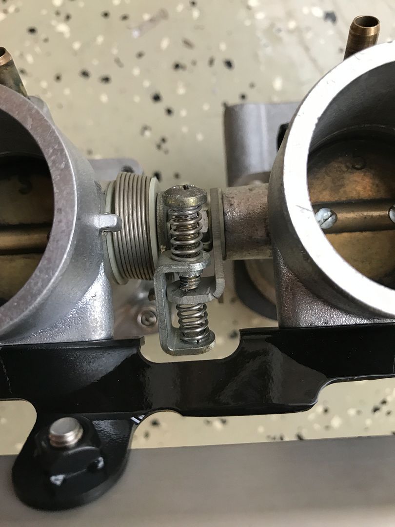

Using a phillips screw driver, turn in and out the adjustment screw between the first and second throttle body until the kg/h reading is as close as possible to cylinder #1. Check the readings between #1 & #2 as adjustments are made.
Then move to cylinder #3, turn the adjustment screw between the second and third throttle body to match the readings of #1 & #2. This one will likely be the furthest off as removing and replacing the linkage arm and spring throws this off. Check the readings between #1, #2 & #3 as adjustments are made.
Once the drivers side bank is complete, everything on that side should be very close to being even. Then repeat the process on the passenger side starting with #5. The adjustment screw is located between #6 & #5.
Lastly, adjust the screw between #4 & #5 to set the kg/h on cylinder #4.
Once each bank is balanced both to each other (1-3 and 4-6) and to the opposing bank (drivers vs passenger) the idle set screws can be adjusted to set the idle. The banks should be balanced, so you should not have to adjust the phillips screws, just the 2.5mm allen for the idle stop.
