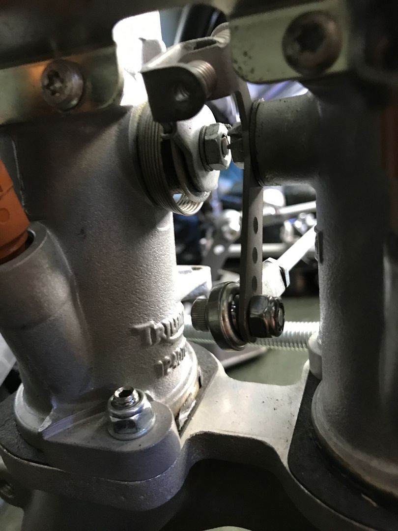

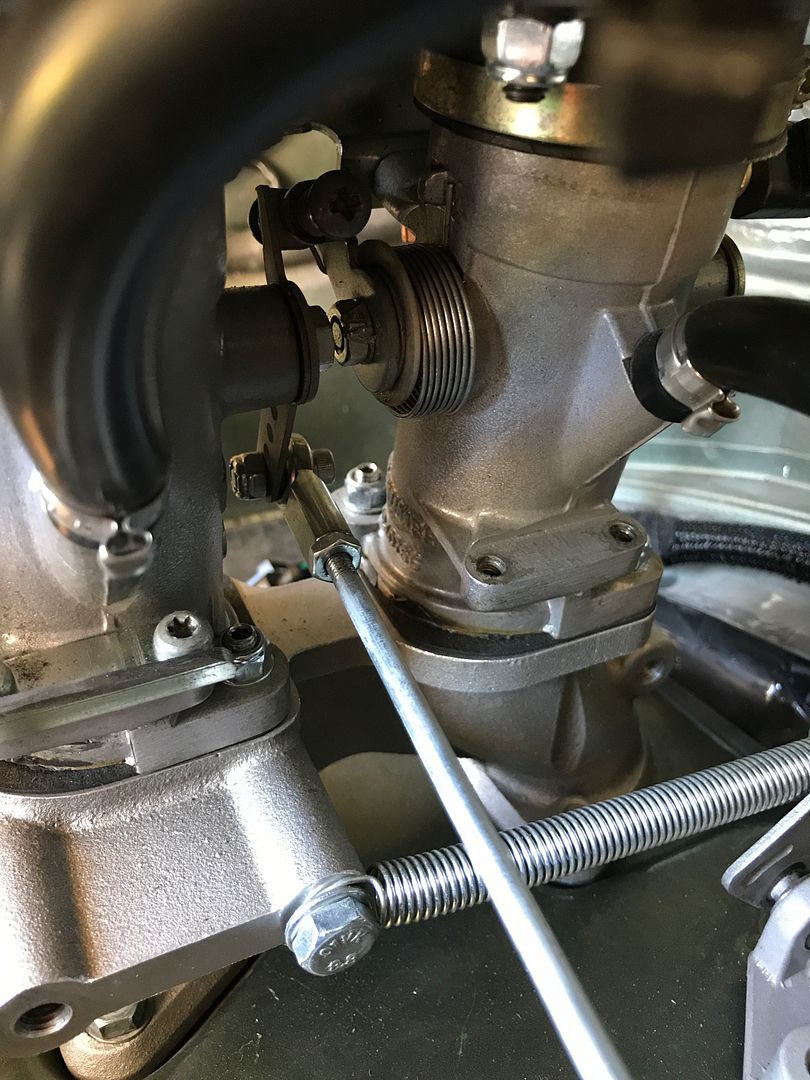

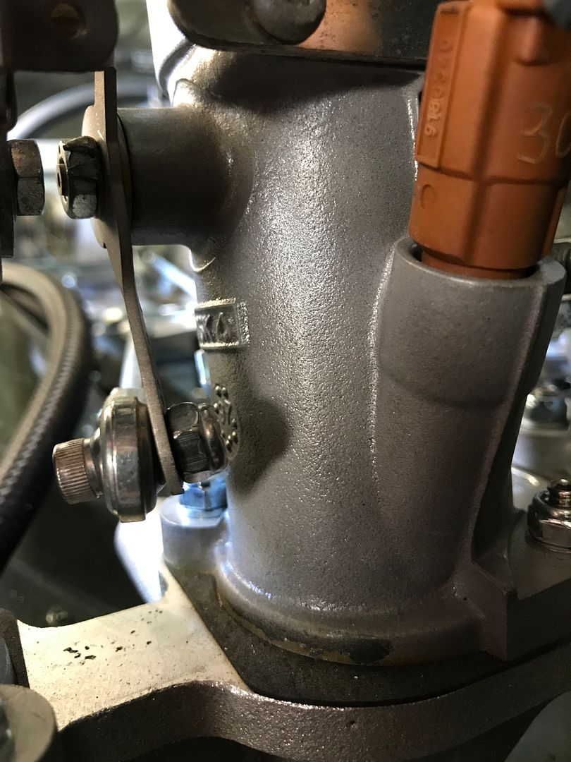

Once the idle is set and everything is balance, the linkage rods can be connected. The length of the two rods should be as even as possible. Adjust by spinning the eyelet on the end when it's loose to the proper length. There should be no change in idle with these connected, there should be a little play before the throttle is engaged.
If they haven't been installed already, the linkage rods can be bolted to the ITB arms.
The ITB arm on the passenger side may need to be twisted slightly to achieve the correct linkage rod angle.

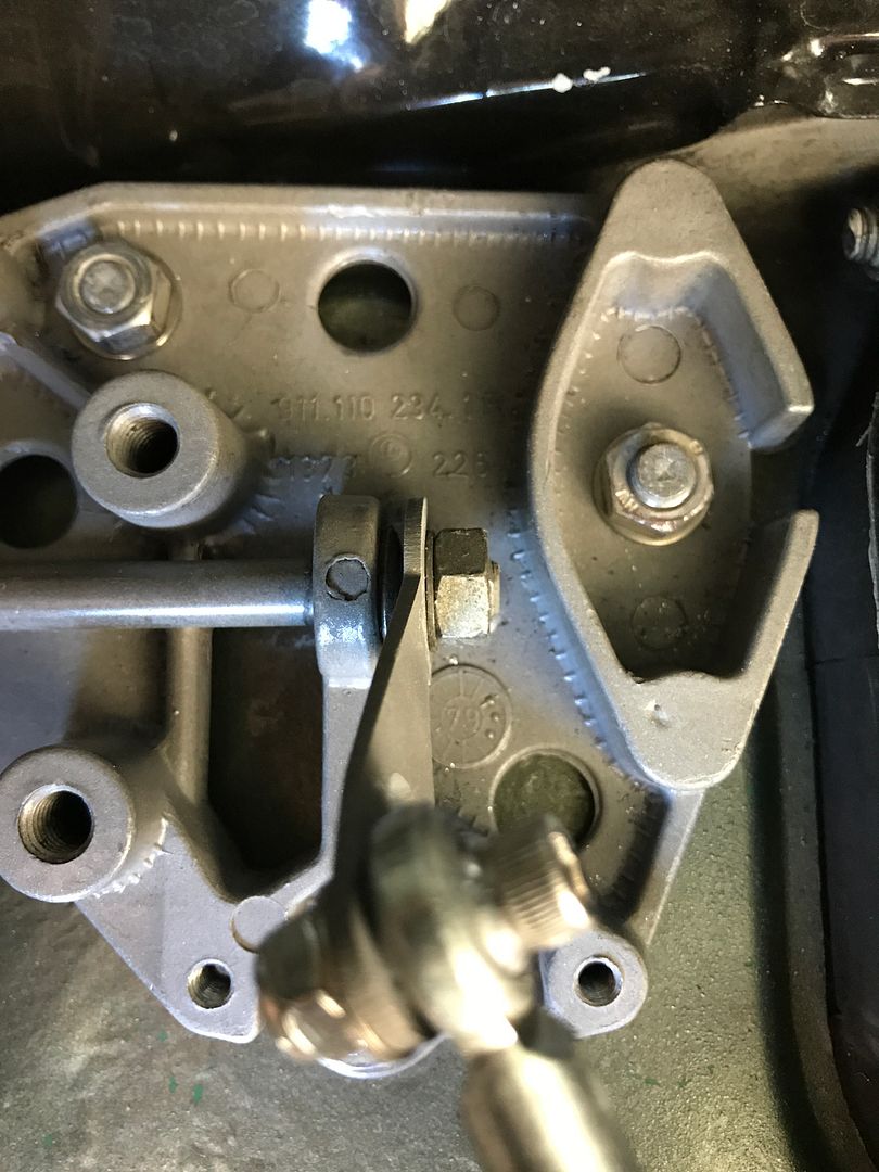

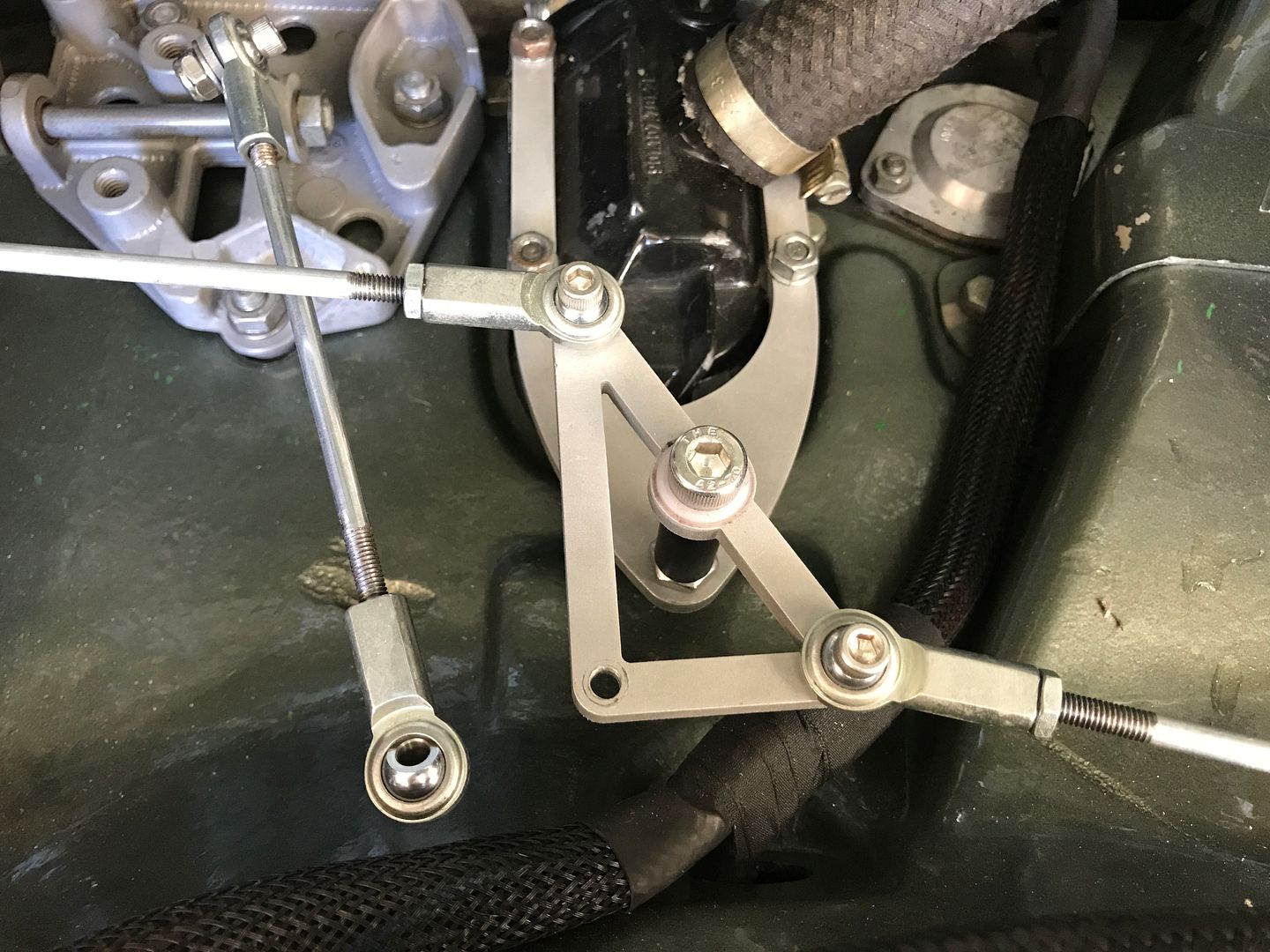

Last up is the bellcrank linkage rod.
Similar to the ITB linage rods, this one should have a very little amount of play and the throttle/idle should not be affected when adjusting the length. It should be just loose enough to not engage the throttle.
This arm also needs to be twisted slightly to achieve the correct linkage rod angle.

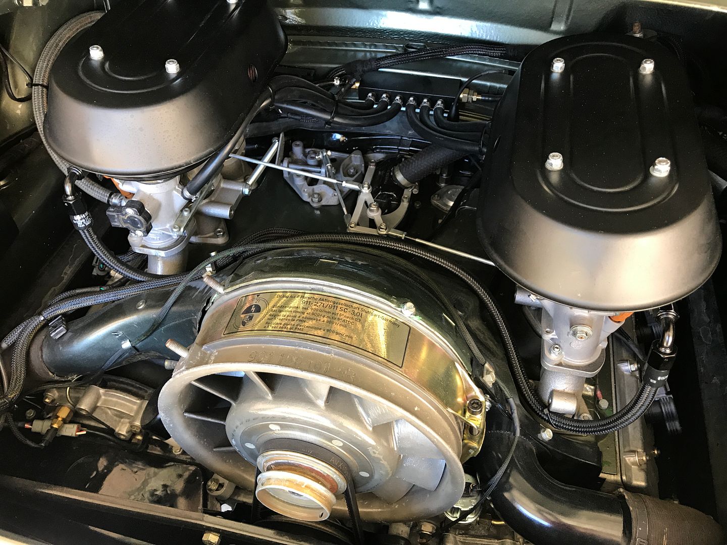

The last bolt can now be installed and air filters back on.

I have a spring installed on my car between the manifold and CIS bellcrank. This is mainly to keep the bellcrank in the "up" position while installing everything else, but it does help with the throttle return. If all the linkage is adjusted correctly, it should be smooth and the ITB springs are enough.
