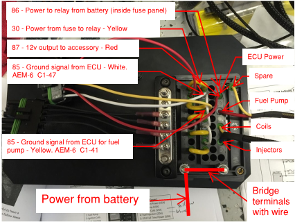

I had a question regarding my fuse/relay setup, here is a little more info.
I wired the relay's opposite what the Bussmann DIY noted, with the relays installed right side up. This means that i'm switching using a ground signal, rather than a power signal.
DIY Bussmann RTMR Fuse Block, Part 4 – Wiring and Schematics | Bodenzord
This is the back of my setup.
The two terminals on the bottom are bridged together and connected to the battery. This provides power to both the fuses and relays (86)
The other fuse terminal or "out" is connected to the relay power terminal (30)
The 87 terminal provides power to the accessories; ECU, fuel pump, injectors and coils.
The 85 is wired to C1-47 of the AEM Infinity 6 ECU. This is the ECU ground switch. The ECU provides a ground to the relay and is the switch. This is used for all accessories, ECU power, coils and injectors.
The 85 for the fuel pump is C1-41 of the AEM Infinity 6 ECU. The ECU provides a ground to the relay and is the switch to turn on the fuel pump.
This is just what I did. It is not the only way to do it, or the best way. The best way is to buy Rasant's kit with the wiring done. I did not save any money doing it myself, I just choose to because I wanted to learn the system and understand the wiring better for myself.

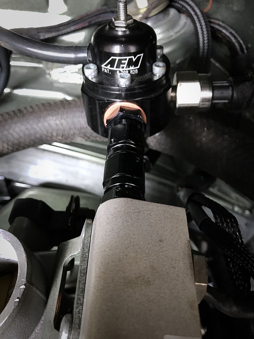

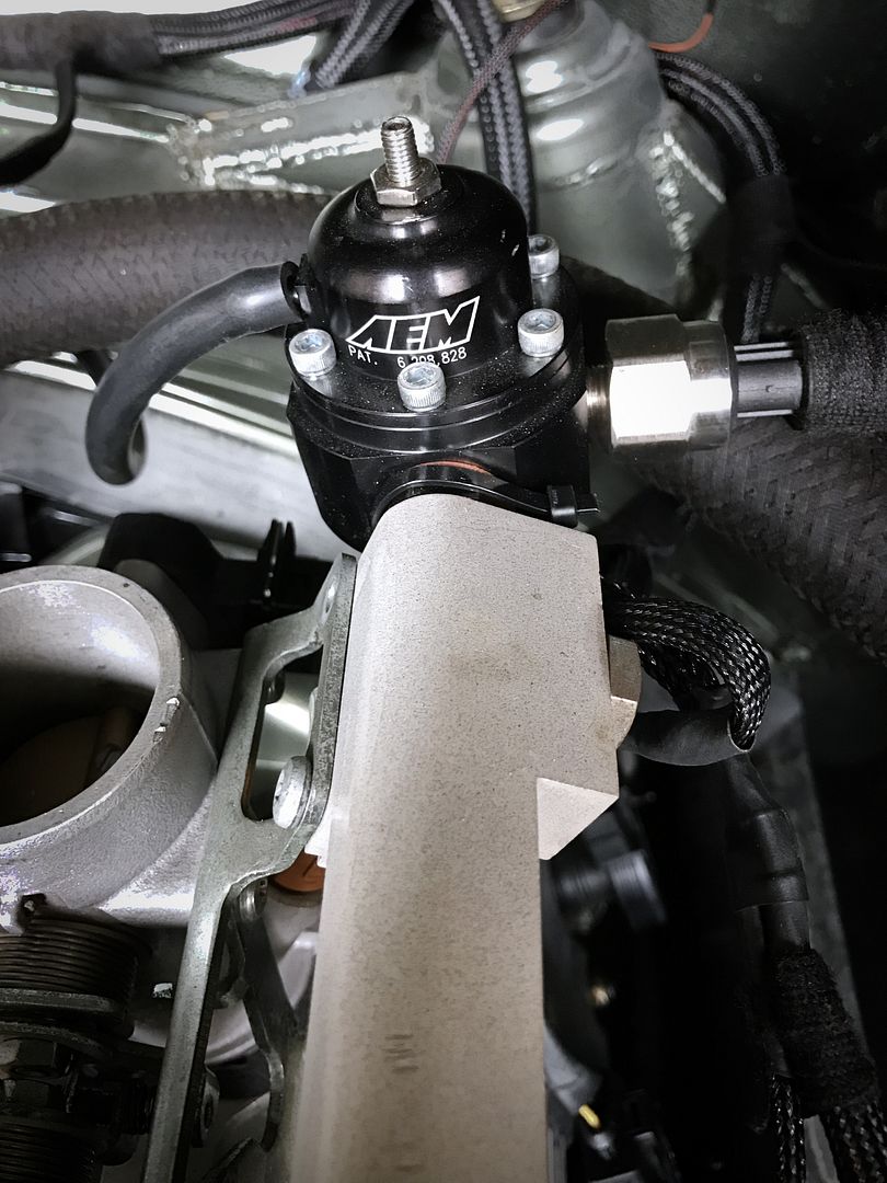

I hadn't thought about the length of the vacuum lines affecting the map signal, but i'm not too worried about it. I'm getting a good responsive signal with this setup.

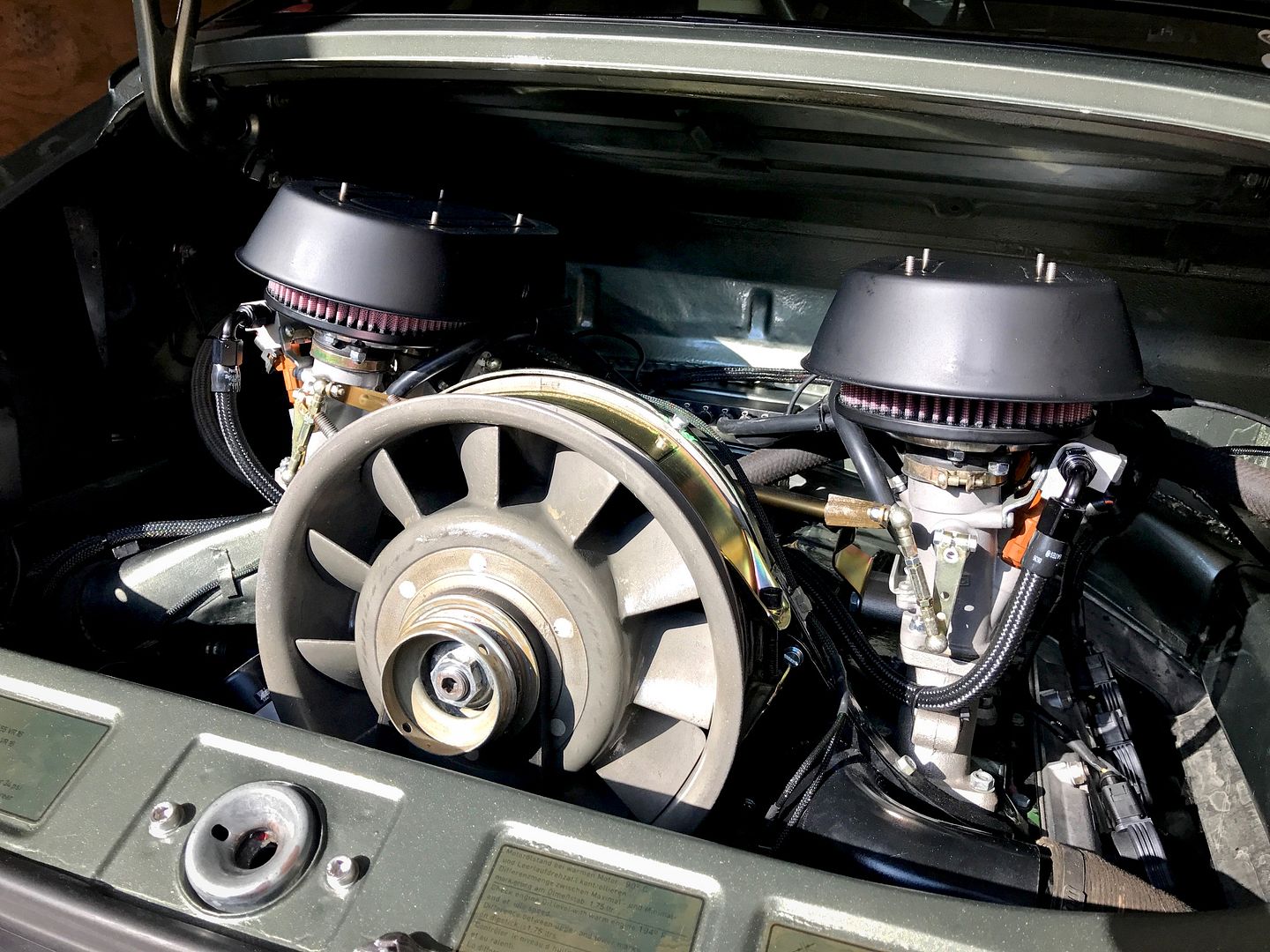

One issue I did experience was during WOT tuning. Several of the screens on top of the velocity stacks got sucked into the stacks. Luckily they were all stopped by the ITB butterfly.
I ran them for awhile without any filters, but I wasn't too comfortable with that setup for obvious reasons. I looked into filter socks, but read reports of issues of limited airflow with them.
I settled on adapting a PMO Weber K&N filter and rain hat setup that I ordered from Pelican.
The adapters started with more Triumph parts. These are intake boots that come on several Triumph motorcycles and a set of 3 can be had for about $15. These come with a round rubber coupler and clamp on one side, a bolted flange with o-ring on the other side.
The coupler and clamp side fit on top of the ITBs, and I designed an adapter plate that was waterjet cut that the bolt flange side attaches to.
The plate is 3/8" thick to allow for clearance above the fuel rail
I previously had the FPR mounted directly to the fuel rail, but the new filter setup interfered, so I added a straight union to space it out. This is a better connection anyway.

Then assembly of the unit.
The heads of the hardware is on the top side so there's no chance of a loose nut making it's way into the ITB.
I used standard Weber/EMPI velocity stacks
Standard K&N filter
Old 12-11-2016, 11:47 AM

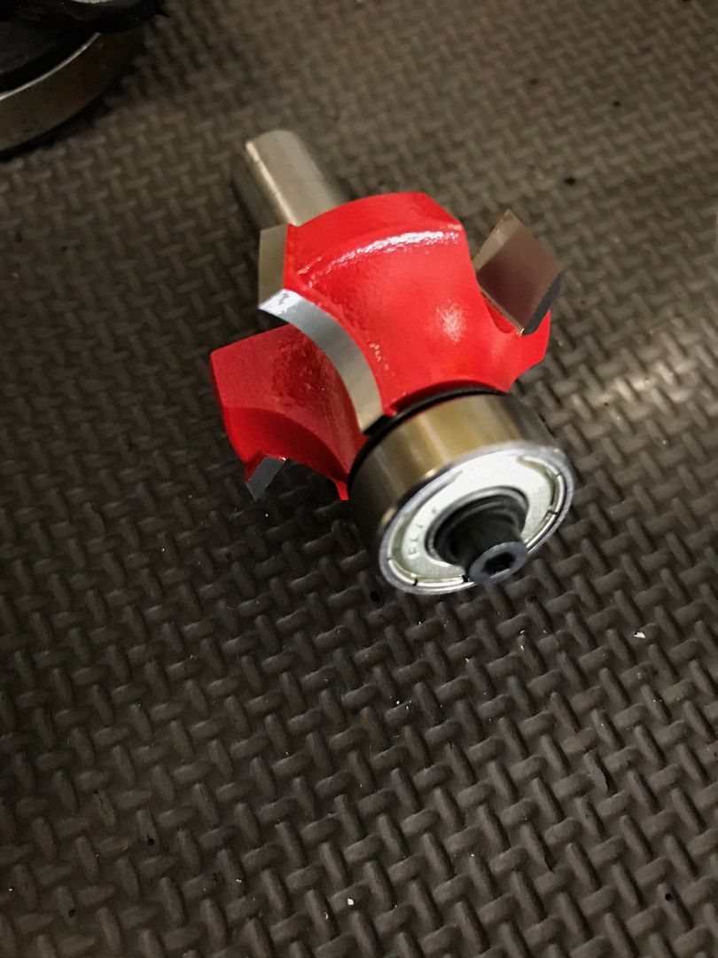

I messed with the adapter plates a little more
Using a 3/8" round over bit in my router, I opened up the ovals of the plate to better align with the velocity stacks
Huge mess but they turned out decent
Down the velocity stack
Once that chore was done, I assembled them for the last time with some RTV between the plate and the bottom of the rain hat. Then installed them on the car.
