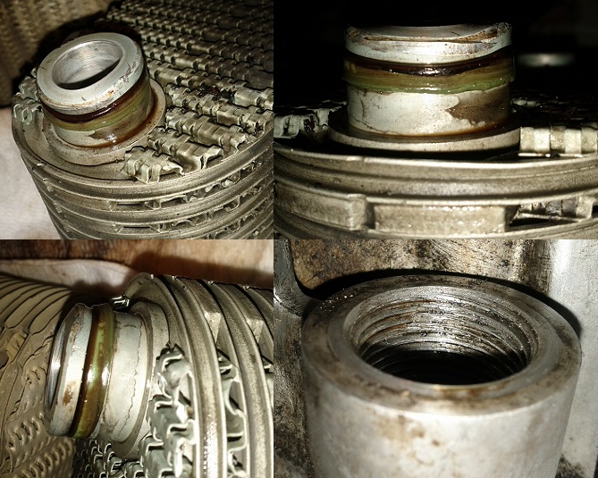

Volhv's Avatar
Join Date: Jan 2012
Location: British Columbia
Posts: 708
The seals may be new on the oil cooler, but if it was misaligned during installation, it could have bent the spigot.
Here's a picture of how I found mine after removal.

The oil cooler seals were not done when I did the head (I should have, but didn't), but could bad oil cooler seals cause this much water to enter the oil? I figured that there would be signs of oil mixing with the water, as the oil is at a much higher pressure than the water would be. So what causes water to enter the oil, but no oil in the cooling system?

Marcelh's Avatar
Join Date: Nov 2005
Location: Northern VA
Posts: 13
Yes this could be your cause, I think that it was my main cause
I thought the head gasket was blown as you normally would but
after taking the head gasket off I saw nothing wrong with the gasket
so I think it was the oil cooler seals the whole time. The coil cooler seals
were upgraded to better ones as the original ones had some design
flaw that would allow them to eventually leak. I don;t know why it only
works in the one direction as far as only coolant in oil and not vice versa
but I think it has to do with the way the fluid flow thru the cooler and the
design of the seals only allows it to mix one way?
