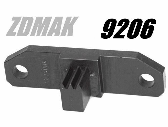

so, just wondering, but why is this flywheel lock needed? i realize it will keep the engine from turnign when i try to break loose the nut holding on the harmonic balancer, but if i could get it loose would that be ok? or is there a danger involved that i dont know about? (im gonna get the tool either way, just wondering)
Uh, because it locks your flywheel, so you can break that Crank Bolt loose and tighten when you install it back to proper torque specs.
I guess the danger would be to break something else not using the proper tool and finding yourself buying more parts to fix what you broke, then furthering the joy of ever driving your 928. Thats all, just a minor issue.

Danger is that if you turn the engine backwards you can dislodge parts in the valvetrain. Not just your 928 engine buy many (if not all) engines can be damaged this way. Engines turn clockwise as you look from the front. Obviously you have to turn counter clockwise to break that bolt loose. When I did mine I had a very experienced friend stop the motor at the flywheel with a big screwdriver. My human flywheel lock. Problem with this is if your friend slips.... you're taking apart clyinder heads now as well. Doesn't happen every time.... but I've heard of ppl having this problem.

the lock prevents the engine from being rotated in reverse, which will damage or upset the timing belt tensioner and it's related parts. The cams/valves/buckets and such will not be damaged from reverse rotation.
if you are going to do this properly (you said this engine has been sitting still for many years?), then you should go ahead and do a complete timing belt/tensioner (kit) and water pump replacement. you would be removing the TB parts so reverse rotation is no big deal to break the crank bolt loose.
just remember, the crank bolt is torqued to 218 ft lbs, so whatever method you use will require substantial force to break the bolt loose....

anyway, im gonna get the tool and do it right, no more risks or stupid accidents that could have been avoided by a 30 dollar tool. i looked on ebay and couldnt find any for a 928, but found a couple for a 944, will it work?

928 specialists sells the flywheel lock you need on thier website.
