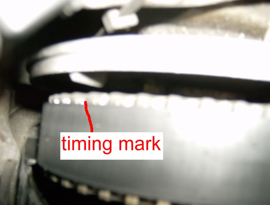

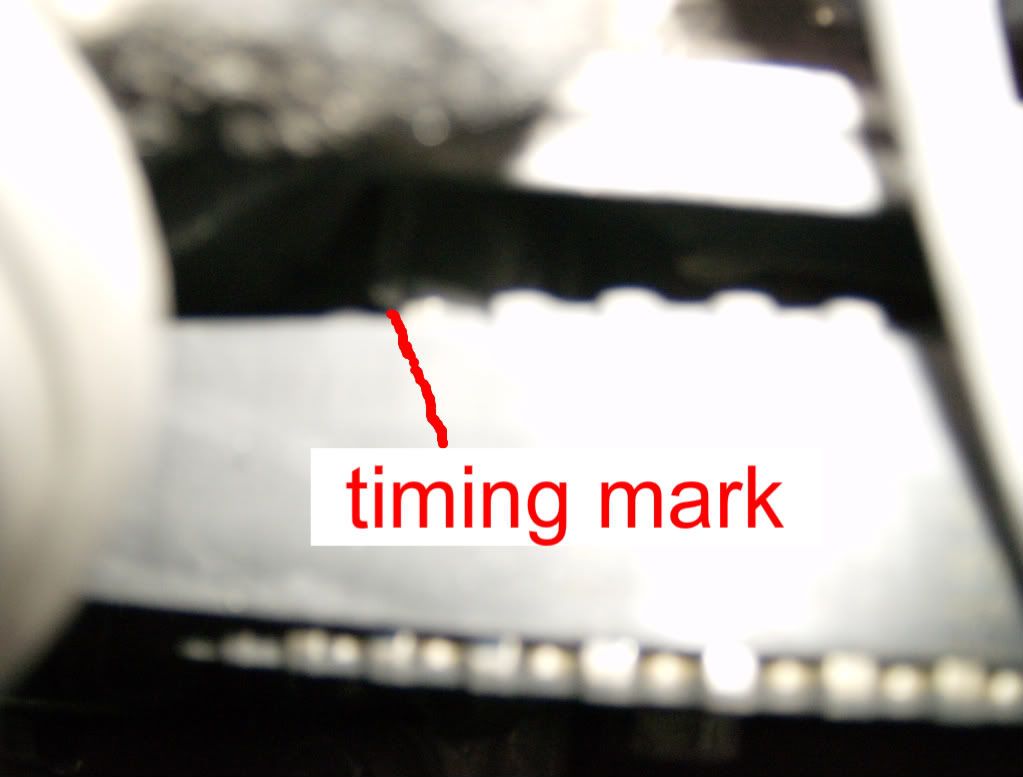

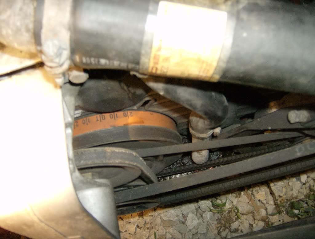

ive actually been wondering if i have a euro spec myself. im really not sure haha. i found the timing notch, it was located a little over 90 degrees of the cast triangle mark, not 180 degrees. there are in the same place on both cams, but when i lined them up with the timing marks on the housing, there were no numbers shown on the orange wheel below. il show pics here in a minute.
the distributer however, the rotor was pointing toward the #1 plug wire.
there were 2 teeth on the cams that had red dots on them. could these have been used for the timing instead of the notch? that would make the numbers show on the wheel below
1983 928 s automatic

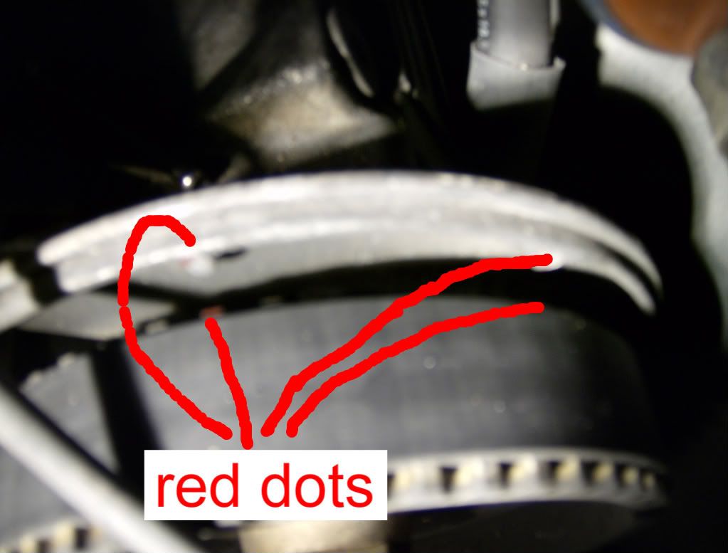

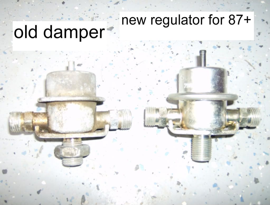

[IMG]Photobucket[/IMG]
Photobucket
the regulatr is for an 87+ because it looked like it would fit and the one for an 83 didnt. (thought i might have a newer motor, haha) they look similar...
i think the cams are timed off of the red dots not the notches, would that really effect anything?

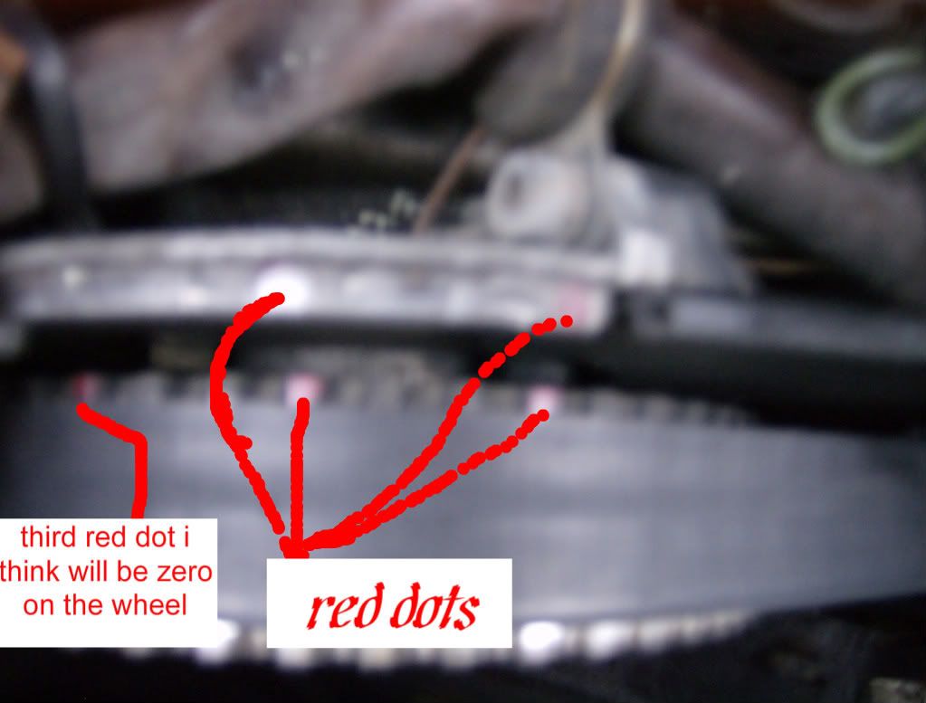

red dots lined up make it about 23 degrees advance, the distributer rotor is pointing at #5

i think whoever it was, timed it off the #5 cylinder instead of the #1. the timing belt looks new. im not sure, any ideas?

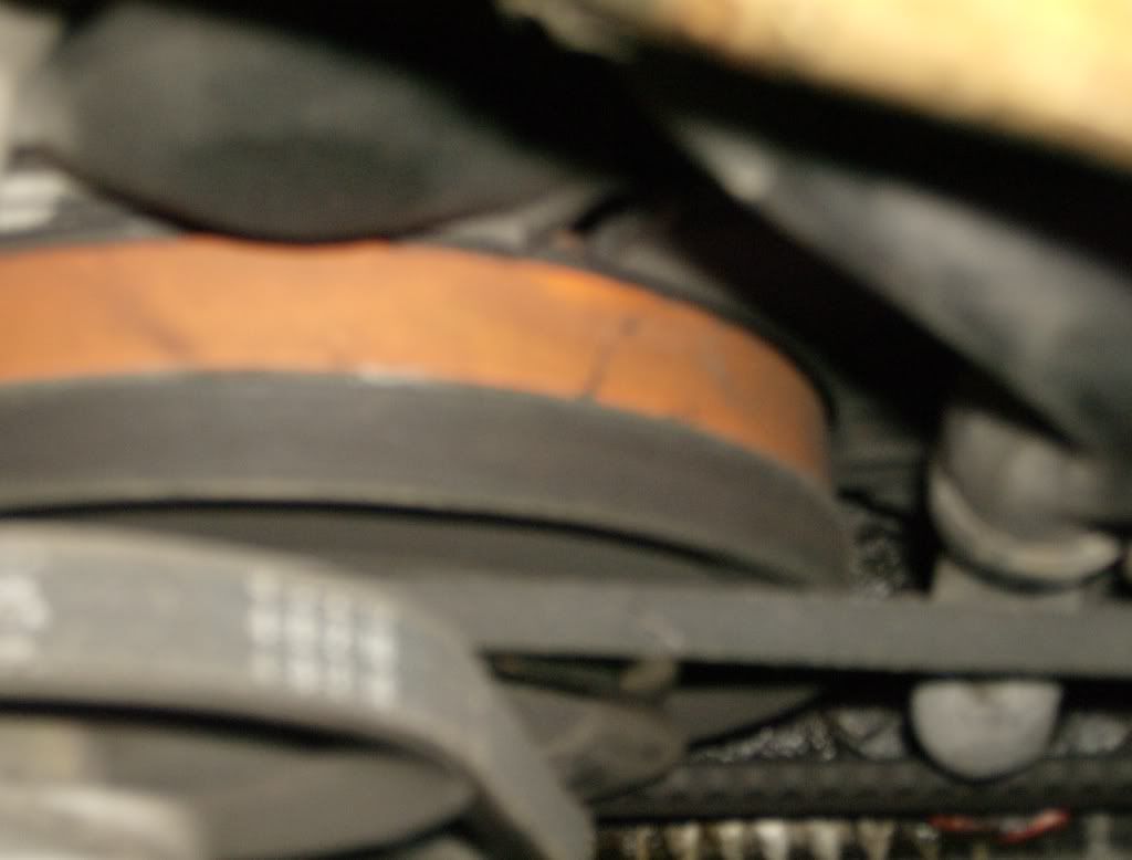

I would start taking things apart at this point. Get a TB/water pump and pull the front of the engine apart. Anytime timing marks are screwed up I get really nervous.
Turn the motor to TDC on the Crank. Pull number one spark plug and tell us if the piston is all the way down or up. Turn it 360 degrees again and see if number one is all the way down or up? This will tell us if there is a chance that the counterweight was installed 180 out.

disregard any (paint) marks on the cam gears---
use only the notches on the rear face of the gears (per FWMs) for cam timing.
Yes, the balancer can be installed backwards! to check this, so as it has been said here, removing the #1 plug and rotating the engine to #1 top-dead-center. Your balancer marks should show it to be at o/t. IF NOT, your balancer may be installed backwards.
bottom line is:
if you line up the cam gear notches to the castings on the cam bearing caps, and the balancer does not show o/t on the pointer (top dead center)----your cams are not timed properly, resulting in no compression.
no compression--it ain't going to run.

See, now we are getting somewhere. Time was off. Disregard any of those red dots put there by the PO. Use ONLY the casted marks and notches that I have shown in my pics. As a matter of fact, get rid of all those red marks.
Your lucky your working with an early 16 valve engine and not a late 16V or 32V, you would have crashed your valves and possibly your piston heads.
Now, lets get your car on time and I bet that byatch is gonna start right up.
