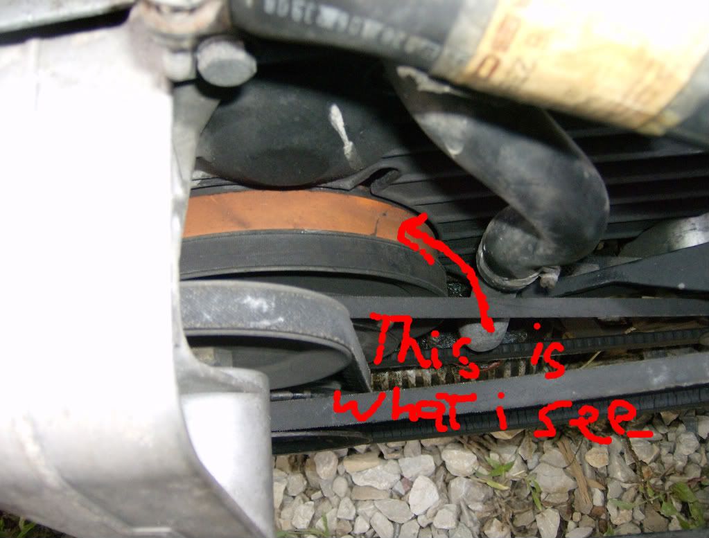

ok, so i decided not to stick anything into the cyninder from now on, i took a maglite and positioned it so i can see the piston while turning the engine. i got the #1 to TDC and no tming marks are to be seen. i see just orange on the balancer, and no notches on the cams. im pretty sure its all 180 degrees off.

just to make sure, i rotated the engine again until the #1 was at TDC and still, same thing, no marks

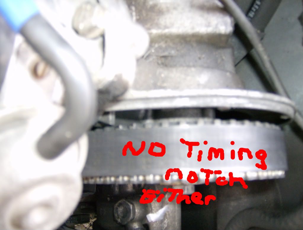

ok, decided not to take pictures cuz it would be too hard to take one ofthe piston.
i watched the piston come up, and start back down again and stopped.
i loked at the timing marks, cant see any.
rotated again till i see the piston come up, then start back down and i stop.
i loked, still no timing marks. the balancer is upside down. and the cams are off. its set for the #5 piston not #1
1983 928 s automatic

when the balncer is at o/t, the #1 piston cant be seen. its down all the way

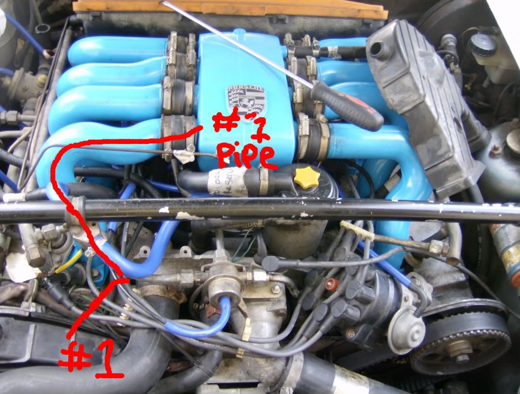

OK, let look at this again.
Are you checking piston #1, which is the passenger side front cylinder? not the driver's side.
If you are good on this, pull it to TDC and check balancer.
--Russ
Absence of Evidence, is not Evidence of Absence.
Bill Maher 8/4/09--- "I'll show you Obama's birth certificate, when you show me Sarah Palin's high school diploma."

Old 08-08-2009, 10:51 AM
Join Date: May 2009
Location: trafalgar, indiana
Posts: 148
[IMG]Photobucket[/IMG]
so now what?

this is #1 cylinder (just like in your picture)
balancer timing marks--notice you read this while standing in front of the engine looking down--it the marks are read-able from the rear of the car (as if you are sitting on top of the engine), the balancer is on backwards
passenger side cam timed OK--notice gear notch lines up with casting mark
driver's side cam timed OK--notice gear notches line pu with casting marks
What I need you to do next is this:
rotate engine until you can see balancer marks---do you see any at all?
if so, make sure you can plainly read the marks.
rotate balancer (engine) until the marks line up TDC. check #1 piston location--look into the plug hole as before--is it up or down?
if down, rotate engine 360 degrees, line up balancer marks.
then check the cam marks
--Russ

i can see marks plain as day, when i line of the pointer with the o/t on the balancer, the #1 piston is down. i have to rotate 360 degrees to get the #1 piston back up to TDC. so no matter what, the o/t mark is when the #1 is down, and nothing is shown on the balancer like in my pic, when the #1 is at TDC

when standing at the front of the car, looking down, the numbers and letters are upside down. theres a good pic of mine on page 3

Got it---
balancer is DEFINITELY on backwards---
I should have caught this!!!! (in the previous pics)
VERY sorry......
How to fix:
remove crank pulley and balancer, invert balancer reinstall.
the crank bolt takes a 27mm socket and about 350 ft lbs torque (it will seem tha much!!!!) to remove. when reinstalling the crank bolt, make sure to torque to 218 ft lbs---a dab of Locktite won't hurt.
once completed, then you can go back a time the cams.....
