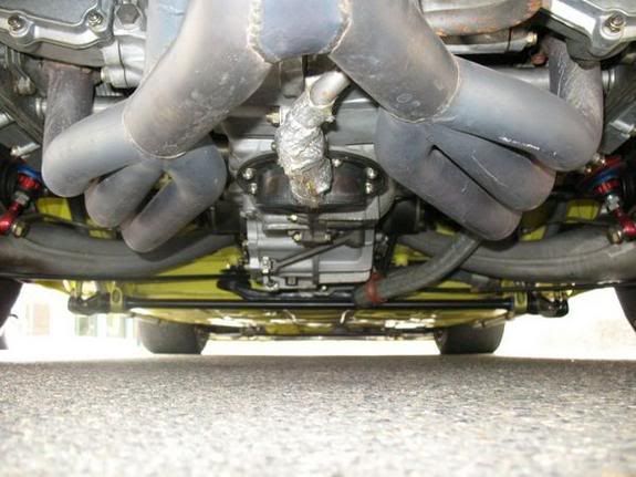

Greetings:
Has anyone modified their stock 930-Headers to 3 into 1 route. Very interested if anyone did it. Pics please....
This is what RUF did....964-Turbo.

Why that looks like a Ruf RCT. I'm just finishing up a top-end on one of those...
The original Turbo exhaust is not THAT different from the RCT setup. The turbo is simply mounted a little closer to the collector of both banks on the RCT
Those are NA 3.6 heat exchangers. Ruf built a really nice "up" pipe to install the turbo where the catalytic converter used to reside. They then moved the NA catalyst to the original primary muffler location. It's kinda funny they are making 400hp through a stock NA cat. conv. designed for maybe 275 hp?!??

What do you think is the best solution for the 930??? Where can I buy a 3-1 flange??? Or just get some pipes, do my own measuring and some good welding???

I don't see the advantage over stock Euro 930 exchangers. Bigger ID tubing?

nice work indeed. I'm not sure, wjfk, what you are considering doing or even what your asking? Are you asking about "merge" collectors? versus stock flat factory style?

What I am inquiring, is keeping the stock 930 headers (durability) and getting some piping runninng across into a 3 INTO-1 merge collector. Has this been done? Is it possible? Is it worth a try? Or just wasting time and money.
Durability factor is very improtant to me. Spending good money on BB and then falling apart in so many years frickin-blows.. Schnell,OBX,GSF, all look great......But will it hold up more than 5years.
I guess my answer is start a fabrication project and see what happens...

I'm not understanding what it is you are trying to do. What is the 3 into 1 route you refer to?
The stock Euro / late-US / 965 heat exchangers shown above have 3 primaries per bank that murge into a 3+3 into 2 into 1 J-pipe configuration. I am unfamiliar with the Ruf modification but it looks like they place the turbo closer to the 3+3 junction.
Here is the stock Euro setup. What is it you are trying to change, the J-pipe?

My current exhaust is a euro-930 setup-no cat..I apologize for not being clear. As for your pic. Can the LEFT HEADER-IN THE PIC--Is it possible to fabricate a pipe directly to the merge collector. With that, then RIGHT HEADER IN THE PIC-Is it possible to cross over a pipe over, meeting the merge collector. So all 3 pipes leading into 1 merge collector? As seen with the Ruf pic. I know is not a 930 set-up.. But I think you know what I am getting at. I have never seen 930-RUF headers or if they make their own. What size piping would be optimal?
Do you think can it be done??? I beleive the oil resevoir small tank would have to be changed/relocated and a long braided oil line added...
Thank you for your time and input..
