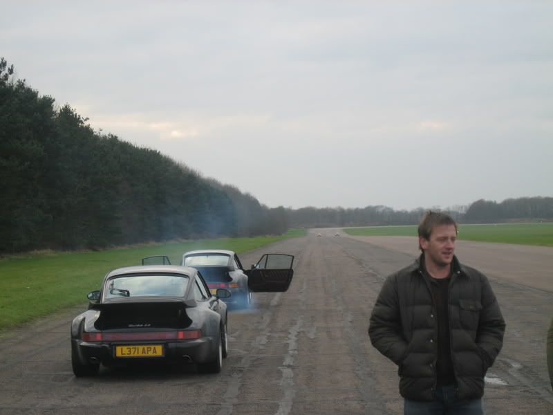

Ok, this all started when I blew up my old engine, i was on a VMax day were we have a 2 mile runway and you take your car flat out. You accelerate for 1.5miles and have half a mile to slow down, it ends with a big earth bank so you want to make sure you can stop

I took the car on another VMax day, this time with no drama, thank God!! It performed well to be fair, it kept a nice straight line, didn't wander too much above 180mph, it all felt rather good!
FIRST RUN 183mph This is me against a 430 Scud, i let him go when we went around the corner, it was my first run and i wanted to make sure i had plenty of space if anything went wrong
A run up to 187.4mph
A run showing lateral and long G
I was almost at the rev limit with the 187.4mph run, i needed bigger wheels or longer gears. I have had a set of Big Red brakes in a box for a while and to fit them i had to ditch the stock Fuchs, so i've been holding out for a set of Ruf classics for what seams like forever, i finally found some........
