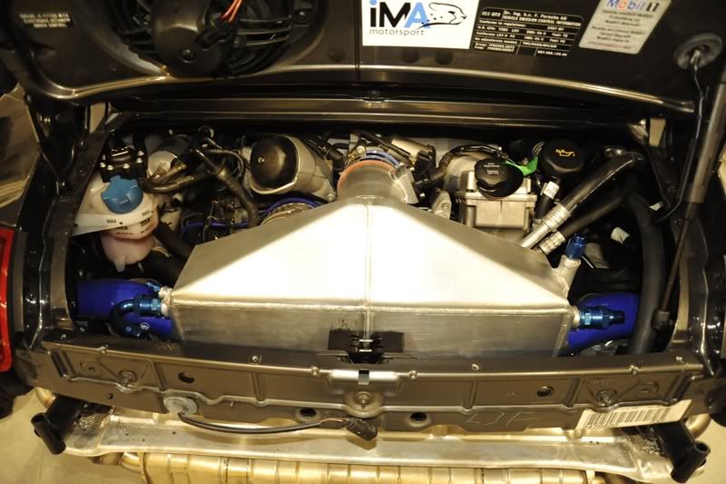

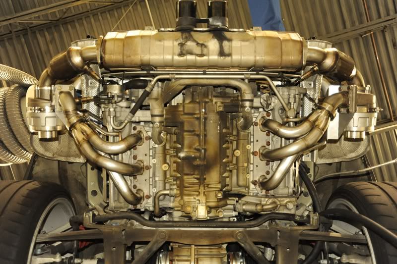

Interesting placement of air filters.
Isn't it risky to have them that low to the road?
It's hard to tell from just the picture, but they have developed a bolt-in aluminum fender liner to separate the filters from the elements, particularly in the wheel wells. In that picture you can see one of these fender liners installed on the driver's side. They can both be seen in this image however:

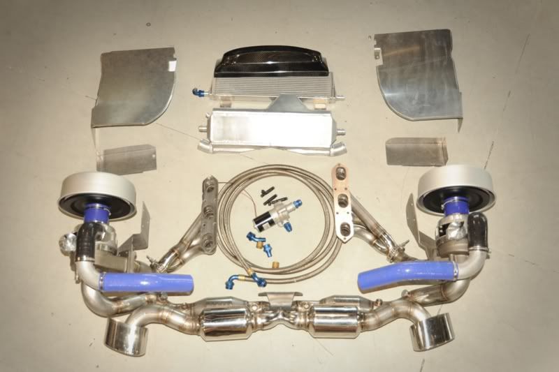

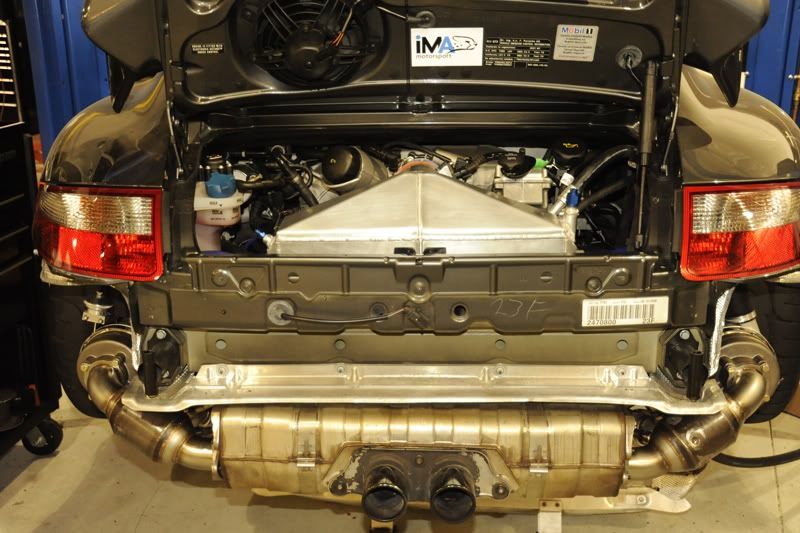

Here are a few pictures of our turbos on a 997 GT3:

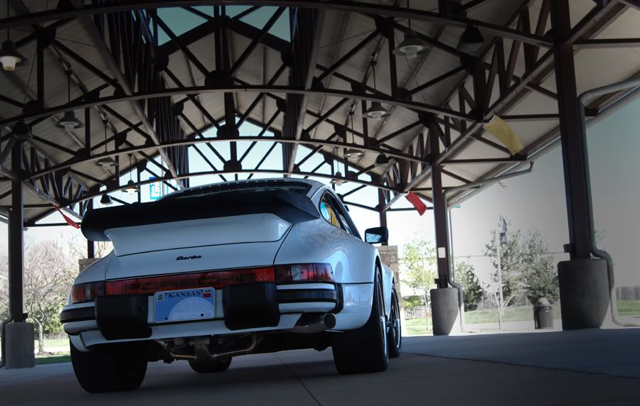

Originally Posted by Jeff Alton View Post
do you have a pic of how low the headers hang?
Cheers
I went a took a few pictures of the car yesterday and thought I would post this one to better answer your question.

Very tidy!
I'm following your progress with great interest.
