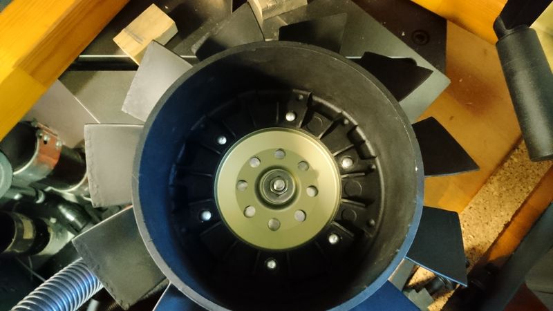

Today I was able to proceed with the fan. I could borrow the tool to set the rivets. After a few Test rivets I set the "real ones". To have a good solid fixation to hit the rivets, I made an massive aluminum counter part as seat for the hub.
It went easier than I expected. Looks quite nice. Only 3-4 hits with the tool and done
And of course test fit to check how it looks, I like it.
The hub is an aluminum replacement. Nice made BUT the rivets needed are not 72° as stock but 90°. No issue so far, but I expect if someone sells replacement which need different hardware, he should inform. For this reason I have now a lot of both versions
When I want to check the amount of shims needed I fitted a new belt. Bought according parts catalogue 710mm but it's way to long. Checked the old one: 700mm?? How this can be? Checked other suppliers like PP, FVD, all the same. 710mm. The only thing left is the Smartracing pulley on the crankshaft, I thought it's the same diameter than stock, but have no stock one to measure... However it is like it is, have to buy a 700mm.

Not sure this will help but, I just went through a similar issue with my belt not fitting after installing a different fan.
It turned out that the fan wasn’t sliding all the way onto the alternator shaft. I re-installed my original fan and everything worked fine.
Your parts are looking amazing as usual. Must be nice to be so close to the finish line.
Thanks for input. But I had the shorter belt with the stock fan hub as well. so issue is not caused by the custom part. I also checked the alignement (housing pushed forward to transmission side). Fan is also all the way onto shaft (can see through the holes it's touching the big shim behind the woodruff key). so left only to check the diameter of crank pulley.
... Thanks, but close to finish? Not at all (unfortunately or not ) Thousand of things still in my mind. You'll see

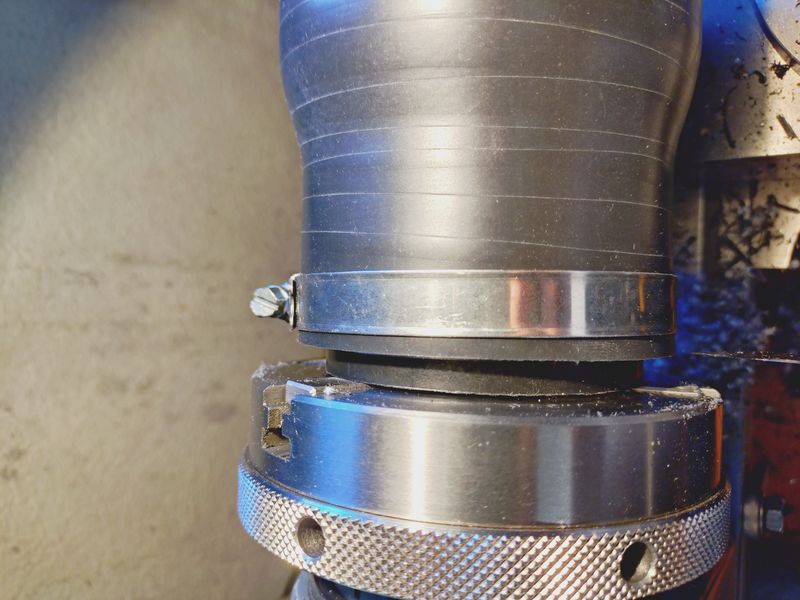

Today I finished the whole inlet tubing from air box to turbo. First I shorten the silicone reduction hose. Easy to do with sharp cutter on the lathe.
PE-HD tubes "welded" using frying pan
Test fit before final cut's to adjust space between the two pieces where reduction hose will be
final version fits like wanted

hmm test fit picture lost... so here it is:
