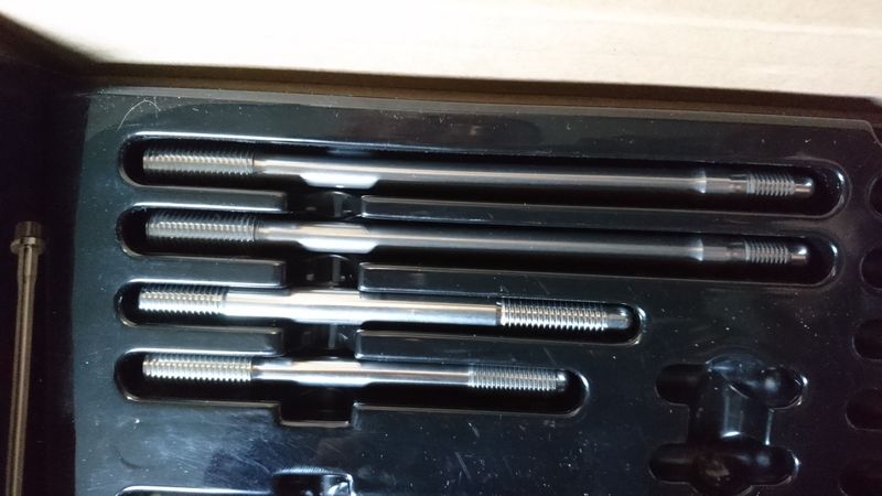

After I had contact with ARP,they finally made it possible to get the crankcase bolt kit. A lot of bolts for even more money but I just wanted them, even if it doesn't make that much sense. I have to say that all the removed ones where heavily corroded or damaged when removed.
No I started to find out what bolts fits where. Most are clear, but some I have no idea. Normally there is kind of manual added to the ARP kits, but here there is none. Asked them, let's see what they have. Does some of you have made or found a list of the bolts lenghts allover the case?
For example those look like transmission mount, but are short (short bell?)
Those are the most unknown, note two are narrow like for the oil gallery, but main crankcase bolts are a seperat set and I have it, so no place left

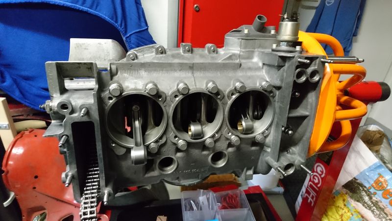

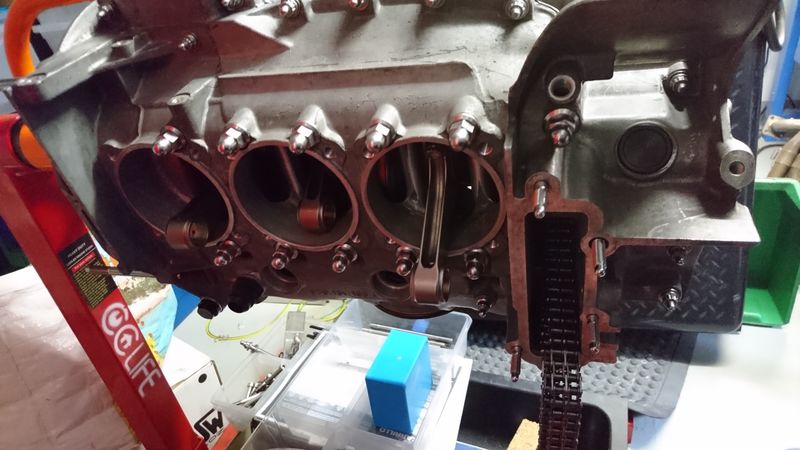

Since I found all relevant bolts neede to start assembly engine, here we go:
New Main including no. 8 and rod bearings 0.5 oversize fitted. Same size as when disassembled, where still within specs, but showed some wear. As I follow the rule "while I am at it", no doubt I will replace them.
Also I replaced everything at Intermediat shaft: Sprockets, chains, alu gear plug and bearings. Polished shaft bearing surface as well. New oil safety and pressure valve pistons and springs. Increased pressure by adding spacer similar to 964 Turbo due the oil filter console instead of cooler.
For sealing a used same products than the Supertec case sealent kit, but without the Curil T. Sealing kit is Wrightwood Racing.

After I had some little time more to spend, I mounted the ARP head studs too using loctite 270 like on the case studs before.

Originally Posted by LukasM View Post
I'm glad you were finally able to get a set of both ARP stud kits Roland, and you are making progress again!
And thanks for doing the homework on where what goes for the case studs, strange that they don't come with any instructions.... I have a complete ARP engine bolt kit for a Ford small block V8 here and they simply printed everything right on the packaging so you know what things are for before taking them out. Basically no extra cost for them and they save every customer hours of work... ��
Hello Lukas
On the pack there is a picture printed, where you can see the bolts on the crankcase, but:
-it's a 964 case on that pic
-only one side shown
-bolts frontal sides not visible at all (transmission and engine carrier bolts)
-lot of bolts are just a few mm different, so impossible to see on that pic
-Kit is for several years/case variants, not clear what bolt is for your case and what's left
What I wonder the most is the fact, that ARP said on request they can't tell me for what place each bolt is:
"Hi Roland, I am sorry but we do not have a drawing so your guess on where they go would be as good as mine.
However there is a company here in the states that may be able to guide you.
They specialize in porsche. Company is Engine Builders Supply"
But I am thankful they made a kit for me as it seems still not availabe out there.

Location: Switzerland
Posts: 2,395
F... Carrillo
Eastern Friday was holiday so I had time to go on. I mounted the pistons and cylinders 1-3 and turned the crankshaft by hand to check everything and then... I could not turn further... back and once more same thing.
So I took the flashlight and tried to see what happend... I immediately had my suspicions and unfortunately it quickly became clear: The connecting rods 2 and 6 touch the oil pump
So no other way than to split the case again... and here it is:
I am really very upset by Carrillo but also myself as I knew their technical info. I says the M064 engine and the 964 pump. I have the 930 case and the latest 930 pump but the bulletin does not mention anything about 930
The pump was adjusted within 5min then
I just had to order the o-rings for the main crankcase bolts as they can not be removed without damage... One more lost week
