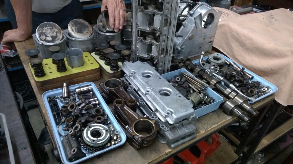

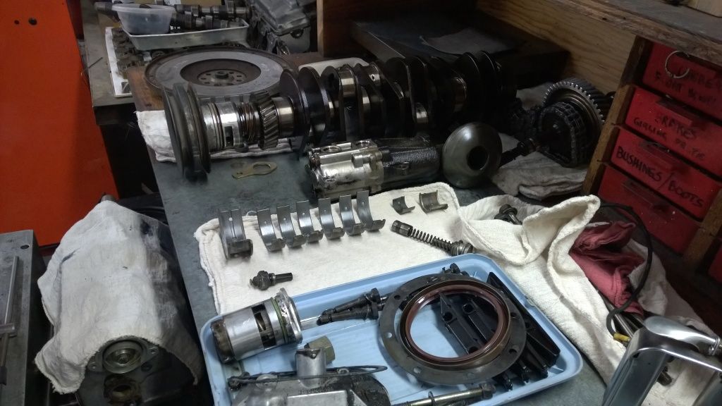

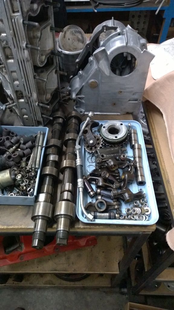

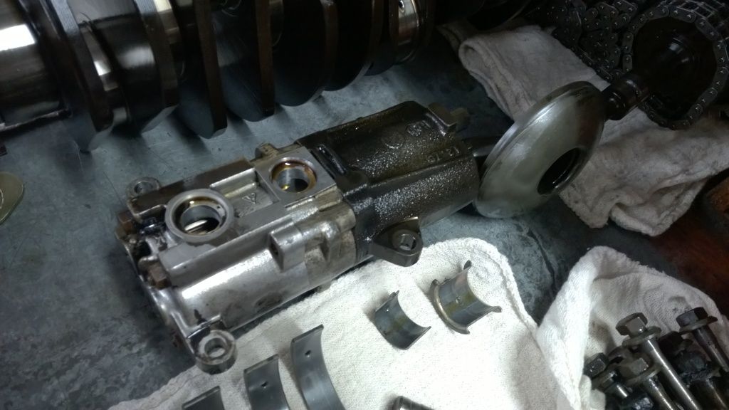

So after teardown, the motor was a complete train wreck. I half expected it and factored it into the car's price, but certainly means I'm not as far ahead as I'd like.
After good numbers on the leak down, it was all down hill. 5/6 pistons have cracks, speaking of which, one valve seat in one of the heads...yup, cracked. Insult to injury, the valve guides are out of spec, rod side play is crap, ALL bearings are worn into the brass, oil pump drive pin buggered up...it needs everything. This is the most clapped out motor you could possibly have and still have everything be rebuildable.
The upshot: build it like ya want it!
So the wheels are already turning. I bought those 98mm 8.5:1 JEs that we were all drooling over in the Pelican classifieds and will get coated when the cylinders get sent out to be bored next week. Dougherty just shipped me my DC15 cams, I already have a k27-7006 and euro exhaust. Rods get ARP bolts and to top it off, an Andial intercooler has fallen in my lap!
Sadly, I don't have time to do the full rebuild myself these days, so a buddy of mine is doing it. Here are some shots from today at his shop:
http://i25.photobucket.com/albums/c7...mporary-77.jpg
http://i25.photobucket.com/albums/c7...mporary-76.jpg
http://i25.photobucket.com/albums/c7...mporary-75.jpg
http://i25.photobucket.com/albums/c7...mporary-74.jpg
http://i25.photobucket.com/albums/c7...mporary-73.jpg
