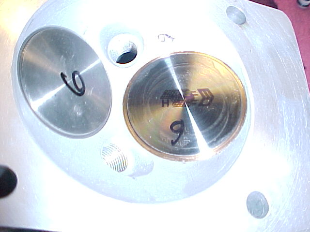

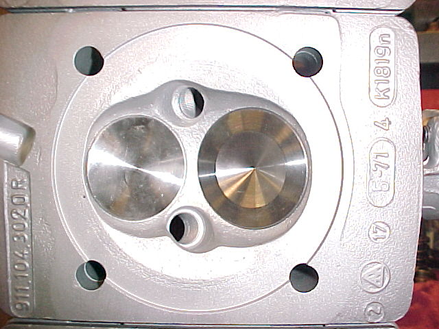

This would point the project towards a high RPM build. The peanut head has two main benefits. Reduce propensity to detonate allowing for higher compression on low octane fuel and lightweight pistons because of reduced dome material.

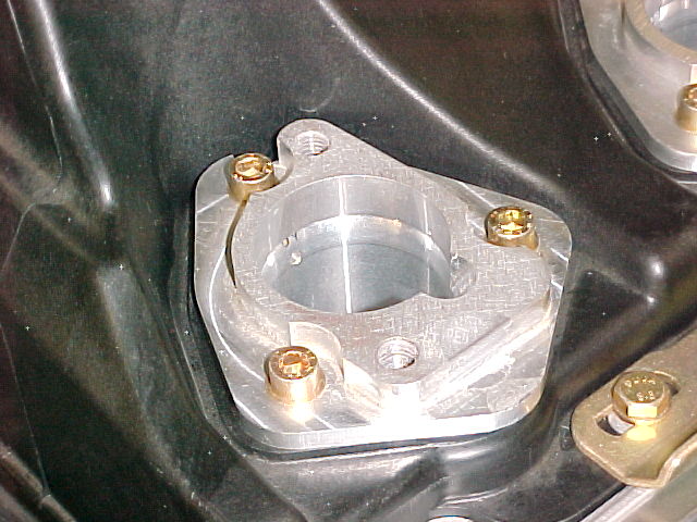

The peanut head. These heads were machined to create an even smaller chamber which brought about the need for a spacer between the head and cam tower. Of course this created a minor issue with rocker geometry.

Since you guys brought it up, and since a new casting or cnc program would be way faster for a production run than welding up then machining original heads to make the peanut ports, you might as well improve the chamber to bring it into the next millennia.
Here's what the Gen 3 Hemi chambers look like. Notice the spark plug boss is extended to help start the fire closer to the center of combustion chamber? Notice how the chamber looks very similar to Henry's peanut chamber? Chrysler didn't just arrive at those improvements by accident or pure dumb luck.
And of course, lighter pistons are the result of obviating the need for large domes, which also hinder flame propagation.
If one were to take it one step further, pistons with a very slight dish (think of the inner skin of a beach ball, a "spherical cap") made the most power in the testing that we did (compression ratios equal). The combustion pressure tries to push down in the center of the piston, reducing friction from side loading.
With the reduced chamber volume the dished piston would compliment the peanut chamber.

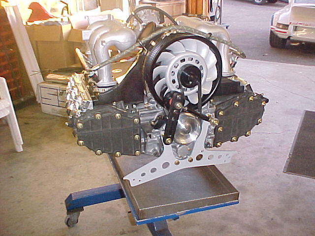

We built our first 4.0 911 engine in 2008 (17 years ago). 76.4 X 105 mm
A true tractor motor. GT3 crank, 993 case, GT3 titanium rods and an enhance version a 3,2 Carrera intake w/Motec engine management . It used Venti-port heads w/Del West titanium valves to improve low RPM port velocity. Max hp was generated at 6500 rpm.
It was installed in a sand rail with a Mindiola transmission which proved to be the weak link in the power train. The torque generated by the 4.0 maxed the limits of the incredibly stout transmission.
