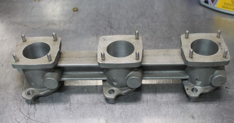

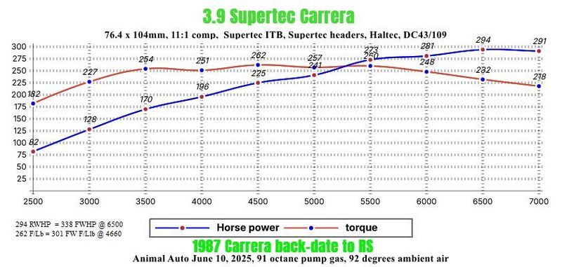

My latest 80 something conversion:
Back dated 87 Carrera: 338 hp @ 6500, 301 ft/lbs of torque at 4600 on 91 octane.
3.9, Supertec ITB and Haltec , the "magic" is John Dougherty's 43X, 109 ls cams.
The ITB manifolds were cast in a friend's garage using an MFI throttle body as a pattern and Volvo Mahle pistons for the aluminum. They can work with EFI or MFI.

Now , that is what I was talking about, Very nice!!
From my time w/ a 3.8 in my '76 w/ both a Mg case 915/44 and an Al case 915/67, JMO but a 915 trans needs a lot of beefing for more than a 3.6, The issue is the torque multiplication in the lower gears can misalign the cwp gears and cause, at the very least, weeping.
Besides that who needs 400hp in a 2400# package, 320 or so w/ a pouncing leopard torque curve(as opposed to a Camal shaped one) is a ball.

I've got some old Alusil pistons if you want to turn them into a set of itbs!

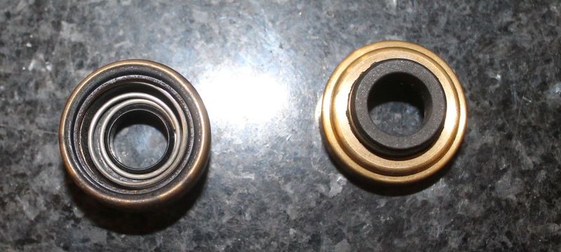

BTW if you have any ideas why it sometimes rattles significantly on startups and can't pass emissions because of hydrocarbons in the exhaust at idle. We're thinking its the variable cam timing gear that is worn out. Pretty much everything else is replaced.
Impressive low and mid (3000-5000) on that 3.9 engine! Is that the "cam magic"?

We chased that rattle in my GT3 for years and replaced everything with no improvement until we learned about the check valves in the cam housing/heads.
These little check valves are rarely discussed and are not available through Porsche.
We sourced the valves with research through an Asian car company. Kia/Hyundai ?

The cam "magic" was across the board but it was most noticeable in higher rpm.
The 993SS cams fell off dramatically above 4600. These DRC cams (43X 109) brought the engine to life and pulled all the way to 7K.
We're being told these cams won't work with stock Motronic but we're hoping to find something that produces similar numbers with 964/993 Motronic management.

Thank you, I Googled that part number and got a hit on eBay for $10!!
I will pass that along to my friend.

I find it interesting that Porsche doesn't show in PET.

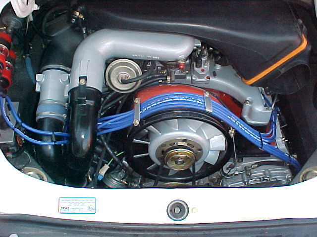

25 years ago we built a 3.1 liter 70.4 X 97mm. It was built with 8:1 compression pistons and twin plugs. The idea was to build an engine that would run fairly well before the turbo engaged. Much like the early big port 911 SC. We chose not to use an inter-cooler to reduce turbo lag. 911 SC cams, 36 mm ports and a K27 finished off the project. The engine was put in a stock bodies 74 coupe with 7 X 8 inch wheels.
The engine product 310 hp and 265 ft/lbs of torque. The short stroke long rod engine really like to spin. We had a red line of 7400 RPM.
The guy who ended up buying the car added flares, an inter-cooler and a tail.
