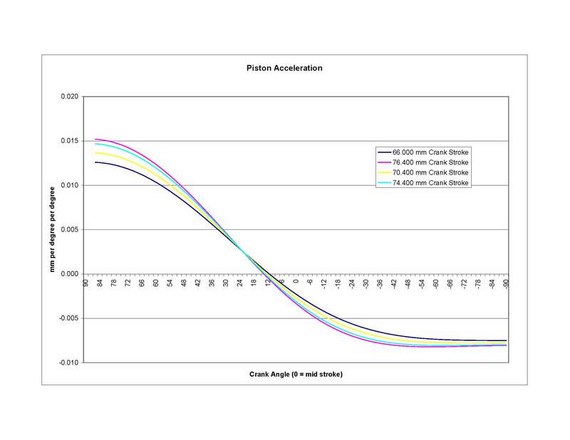

Old 09-29-2004, 04:18 PM
jluetjen's Avatar
Location: Westford, MA USA
Posts: 8,861
You asked for it....!
Ok; here's my updated and corrected attempt to quantify the affects of rod length and stroke within a 911 engine. Please -- I'd welcome anyone and everyone to doublecheck my method and math and point out any goofs so that I can fix them.
Conclusions
1) This graph is pretty straight forward.
2) On all of the engines the peak piston speeds occur between 78 and 80 degrees ATDC. The 66 mm stroke engine reaches it's peak piston speeds at about 80 degrees ATDC, compared with the other longer stroke (and shorter rod) engines reaching their peak speeds closer to 78 degrees ATDC. So Camgrinder is right, a longer rod will result in the peak piston speeds being reached later allowing more time for the mixture to flow in. But in the case of the 911 engine, the difference between the longest rod version and the shortest rod version is no greater then 2 degrees.
For Reference, here are the rod/stroke ratios for the different configurations:
66 mm stroke: 1.97 R/S ratio
70.4 mm stroke: 1.82
74.4 mm stroke: 1.69
76.4 mm stroke: 1.63
Now let's keep Camgrinders premise that everything else is kept the same (bore, valve size etc, but as a result not the capacity which will have by definition grown). From a cam design perspective, it would appear that by that by the time piston reaches it's peak speed point in the cycle, the longer the longer stroke (and smaller rod/stroke ratio engines) engines would have travelled further and thus have reduced the cylinder pressures at that point more then the short stroke engine. This is because the mixture is being drawin in through the same sized valves and ports. Look at the distance travelled graph above. I wonder if this would increase the "pumping losses" in the engine? Look at the example of the 911ST motor below.
This be another reason why if you add a stroker crank to a motor and change nothing else, (increasing the capacity and reducing the rod/stroke ratio) that cam acts "mellowed" since short rod/stroke ratio motors demand more flow earlier in the process.
3) The longer stroked engines have faster accelerations as expected, but all of the engines have the same acceleration rate at about 68 degrees ATDC.
John

Off-line Camgrinder mentioned the following to me:
I am thinking my idea has more to do with the leverage created by a longer stroke
than the stroke to rod length. I figure the further from the crankshaft centerline you apply
the force the more torque you will make.
I decided to poke at that idea some using the obvious example of the 911ST 2.5 liter motor. Here's what I worked out:
My competing theory: The increase in leverage is largely offset by the smaller force being applied to the piston as a result of it's smaller diameter (keep in mind that we're talking cubic capacity is fixed) and increased displacement. So some of the pressure is used just moving the piston the extra distance. Since the combustion pressures will be roughly the same, if the stroke is 10% larger, thus causing a 5% increase in the torque on the crank (since the crank only grew by half of the stroke increase), it will be offset by the 10% reduction in piston area. The net result is no gain if you ignore such things as changes in the engine's internal friction and stuff like that.
For example, Porsche's 911ST motors:

It's amazing how much trig you can forget in 37 years!!!! I've replaced my earlier graphs (comparing 66 and 70.4 mm stroke geometry) with new graphs (Listing all 4 stroke lengths) based on corrected trig calculations. Let's just say that my earlier attempts were just wrong, I won't list all of the errors.
Go back up and reread the stroke post and let me know.

It would be interesting to see a 76.4 stroke engine with a r/s ratio of 1.97 on the graph.

Here you go...
It looks like the peak piston speeds have about a 2 degree difference with the shorter rod version hitting it's peak piston speed at 78 degrees and the longer rod version at 80 degrees. This can be seen best on the acceleration graph (also known as the derivitive of the speed graph) where the two lines cross 0. When they cross 0 is when the pistons have 0 acceleration (peak speed) and start to deaccelerate. Camgrinder, how do you think that this would impact the choice of cam or a cam's design?
