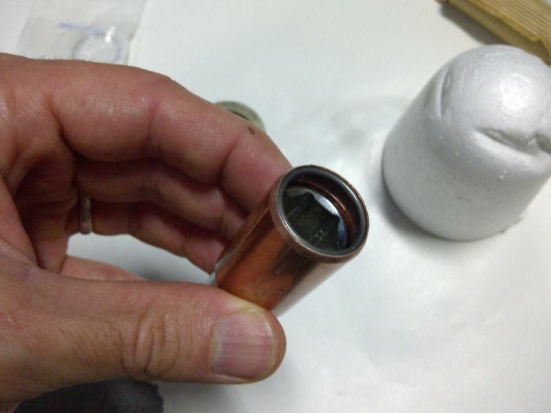

I am sure the Stomski tool is great, and a professional choice.
In my case, doing just one engine, I opted for a home-made spring-clip injector made up of a 3/4" copper coupling tube and an appropiately sized deep socket (and a small rubber mallet).
I had to bevel the leading edge of the tube to nest in the piston pin bore, and thin out the tube on one side (simply by filing down the outside of the tube until it would nest in the pin bore hole concentrically.
Worked perfectly... I was able to get every clip in with no issues whatsoever.
