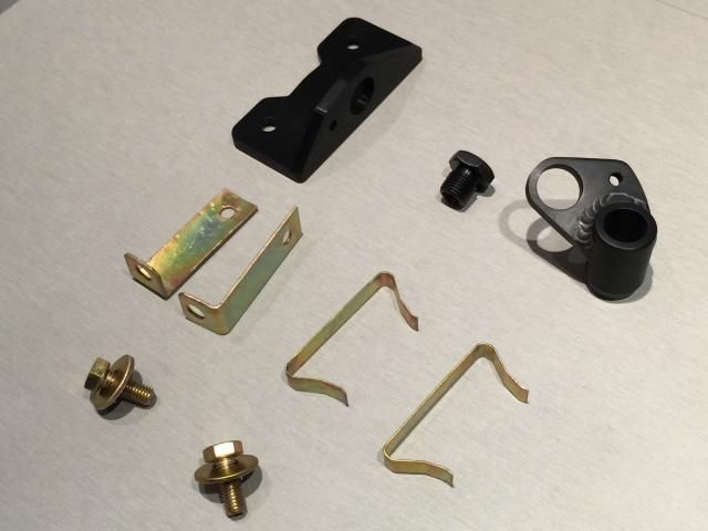

No more progress today in terms of building or making stuff, but I do have a load more parts:
The plated and anodised parts for the gearbox, speed sensor mounts, the M14x1.5 blanking plug for the chimney cover and some rear bumper fixings --->

After reading the discussion on clutch release arms on RobT's excellent (and popular) 964 rebuild thread over on Rennlist, then consulting Chris, I've taken his advice and gone the same route and replacing my setup as well, for a few reasons:
a) Mine was the same p/n as Robs (950 116 712 30), with the shorter fork contact patches but instead had the later plastic bushes, not the soft metal type that start/finish flush with the steel arm. Somebody's played with this previously and installed a new bush kit, perhaps?
b) There was wear on the contact patches -->
c) Porsche looked to have superseded my unit at least twice in the interim, and now supply a 997 xxx xxx part...there's probably good reason why this has been done.
c) Along with the LWFW and super-duper clutch setup, "in for a penny, in for a pound"...
...and to that end, I'm also replacing the shaft, the seals, needle roller bearing, bush, cover, bracket and bolt - basically everything in that assembly.

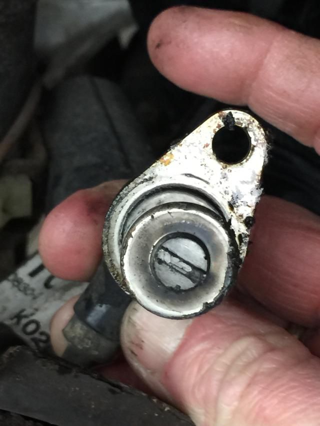

Hmmppphh...in the interests of a fair and balanced build thread, there are the odd nights where things go a bit wrong!

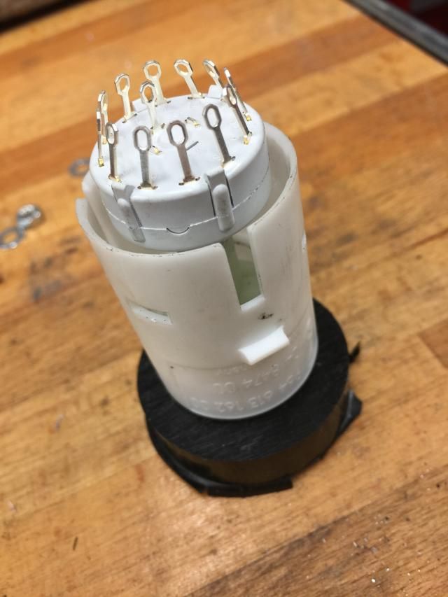

Last night....started off ok, made the collars for the rotary switches to mount into the white switch tubes. Spot-on fit; not sure if we'll epoxy these or try and drill/tap to retain with a small M3 or M4 screw --->
All good so far. Part two of the machining op is to shorten the ferrule that interfaces the rotary switch spindle to the switch knob. --->
No problem, mount into the 3-jaw - carefully so not to crush it - easy...number 1 done --->
Doing the second one, nipped up the chuck (what I thought was) enough, went to part it off and it grabbed and flew out, snapping the locating and locking part that goes inside the knob. Bollocks. Still p****ed off about as I type. Retrieved the snapped part and have tried Supergluing it back, not yet gone and tested to see if it's held. Potentially going to be a $58 part, binning $57's worth of it to get the bit I need.

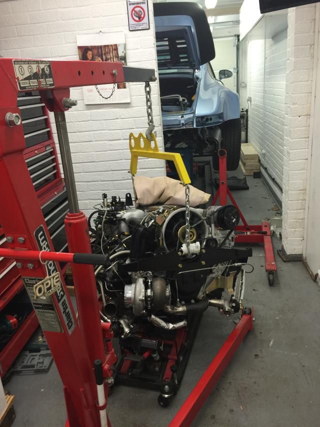

A quick progress check-in, quite a productive day, although confess to being distracted (lazy) and watching the Daytona 24hrs.

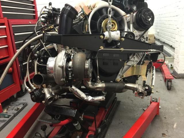

After a much needed tidy-up in the workshop, I decided to get going on a trial fit of the engine into the chassis, so, car is now back up on the lift (this is of limited use, as the construction of the lifting mechanism prevents the engine and gearbox being bolted up and installed as a single unit).
Retrieved the engine crane from a barn I have use of, removed the intercooler and intake pipe then used the lifting bar I bought from our host to get the engine off of the stand.
I know that to a lot of the guys here, engines coming on and off of stands is business-as-usual, happens numerous times per day - but for me, after this amount of time, it was quite a momentous occasion (and nerve wracking) to get it off the stand.
With the basket removed, I can now fit the oil filter, the starter motor ring and clutch pack as well as the tinware that runs along the back of the engine.
Can't remember how I used the ATV jack to remove the engine - it was almost 3.5yrs ago now - but this time I made a wooden cradle so that the crankcase is supported either side of the mating flanges.
A few years ago when I fitted the 964RS flywheel, for some reason I torqued up all 9 FW bolts - and I can't remember why - but I needed to remove it again. I temporarily re-used the bolts, and even though they've only been torqued but not loaded, I always intended buying another set and replacing them. These arrived in the post from my OPC on Friday morning, so tomorrows jobs are:
  • Replace FW bolts
  • Fit clutch assembly and align clutch plate with gearbox (rather than the alignment tool I have - they all seem to be pretty rubbish)
  • Ask a favour from my Dad to help manoevre the engine through the workshop door - <1cm clearance either side.
  • Install engine using the new RS motor mounts, but not with gearbox attached (will need to jack up the FW end to support it)
  • Start checking loom, hoses and everything else for correct length and routing.
  • Remove old bearings from gearbox (clutch release arm shaft) - need to make some kind of small pulling tool or attachment for the slide hammer
  • Assemble new clutch release arm assy.

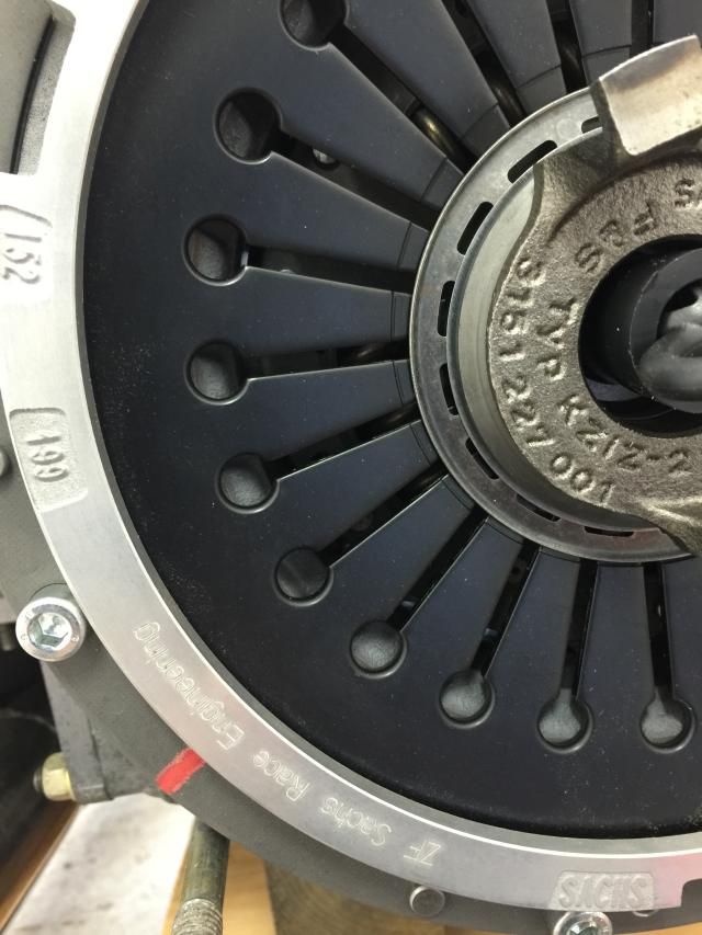

A little more progress during the day. Time to tinker with the flywheel and clutch.
First off, swap over the old-new (!) flywheel bolts. I don't know why it's taken me so many years to get around to making a flywheel locking bar, but it has...made one this morning and life got a whole lot simpler.
So everything was cleaned up and the new bolts installed, and another item now removed from the To-Do list.

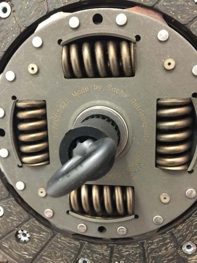

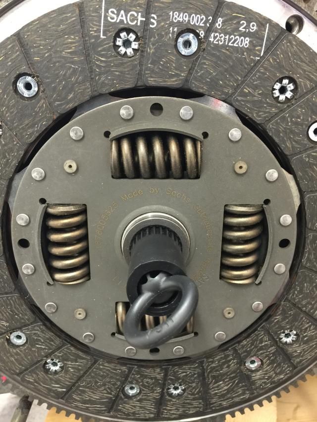

Next, time to retrace my steps with the Sachs Racing clutch; when I received it a few (3?) years ago from Chris @ TurboKraft, I assembled the thrust bearing assembly onto the pressure plate with a single spacer shim. Now, what I can't remember is why I installed a single shim; it may have been on Chris's advice, or I may have read the workshop manual that does say for Carrera's it's 2 shims, for Turbo's it's just one. I wish my memory was better.
Revisiting this, there's nothing Turbo left of the clutch assembly; guide tube, release bearing, LW flywheel.....so, given that, I've re-installed the 2nd shim. Thank God for the hydraulic press, it made the job a breeze.....but I'm quite prepared to remove it again if I'm reminded why it needs to go back to a single shim.

Originally Posted by gaaz911 View Post
A very common problem mine were severely corroded one of my friends fabbed up some 6mm alloy plate and re-riveted
Thanks Gaaz, that looks a really tidy job. I can't quite see from the pic, but it looks like the part of the bracket that retains the captive square "nut" isn't there, instead I guess you just simply nut and bolt it?
I think we'll have a go at welding to start with - speaking with Chris, it appears even the ones from hot climates suffer the same fate. If it can't be welded, then nothing lost, time to drill out the rivets and get fabricating.

Breaking News!!
Right - here we go....bombshell of the day; not a conversation I was expecting to have
Spoke with Steve @ SBD earlier this evening; time for a significant change of plan.
If you cast your mind back to the very beginning, I dyno'd the car immediately before pulling the engine, so we could baseline it. The intention being that we go back to the same dyno, known to be a no-BS and consistent set of rollers, and spend a few days mapping. About the most accurate way of getting that before and after view of the performance.
However - for reasons that we won't go into here, this isn't perhaps going to be where the engine is going to be mapped. Instead, the engine is now going to go into an engine cell for mapping.....possibly in a few weeks time!!!
I have to say, having had the first iteration of my Westfield engine mapped by Steve on an engine dyno many years ago, I was impressed. Apart from the accuracy of not having to consider atmospherics, the repeatability or calculate drivetrain losses, it's a hell of a lot easier to fix or adjust anything, especially in a 911. If there are any hiccups, then we're not into "pulling the engine out" territory. So, engine dyno'ing was something I've been pondering for a few years, but never progressed as I was fairly comfortable with Plan A. Actually, I'm extremely excited at the prospect of Plan B.
What I don't yet know are a few things:
  • Whether the company we're looking to use have engine mount rigs for an air-cooled 6
  • What oil feed and cooling provisions they have
  • How they feed the intercooler with cold air
I'm sure they have all of this covered off, perhaps with the exception of the engine mountings, but I'll contact them directly and investigate.
Cost is a little more per day, but we'll probably recover that by virtue of not haemorrhaging time with trying to sort niggles. It also means that we can run the engine in on the dyno easier, and change the running-in oil and filter far quicker.
So....the plan to install the engine and gearbox into the car is now not the way forward. I'll need to quickly make an air intake pipe to mount onto the turbo inlet, something resembling the final design perhaps (although I guess it's not that important?). I'll have to fabricate the final design once the engine is in the car, as it looks as though it'll have to navigate quite a tight path near the LH engine mount.
It also mean (face/palm time) that I'm going to have to extract the chassis half of the wiring loom. After all that effort to carefully remove and replace trim, routing it carefully...Argghh! Oh well, for the greater good. The time I'm saving by not having to book the rolling road a couple of months in advance more than offsets the time take to remove it.
The initial fire-up that Steve and I were going to do here at my workshop is now not going to happen. This does concern me a little, as I'd hate to get everything/everyone booked, engine transported the other side of London, and then it won't bloody fire up!
So, there you have it....we may be having some dyno numbers to share a lot sooner than planned. Not many finishing jobs on the engine to do, and apparently the engine dyno folk are pretty accommodating with juggling jobs (although it is silly season with everybody wanting their race engines done at the moment)
Gulp.

Your right spencer I didnt put the slot back on however I did use the square threaded washer that fits in the slot as it has a a spiky side that stops it from turning I had an additional issue that I was struggling for clearance from my twin outlet exhaust and not having the slot makes it easier for removal if I have to take the bumper off in the future.
Cheers
S

Your brackets look identical to mine Gaaz.
Spenny, so you only fitted ONE spacer shim to the CRB? Did you come to an explanation of why? I have the RS LW flywheel and clutch and am 99.99% certain I used both, as instructed. Just interested really.

Spenny,
Do you mind explaining the purpose of the shim on the thrust bearing? Is this done on all G50 hydraulically assisted clutches? Thanks.
Dave
Hey Rob - I think you're setup is correct....2 shims for the N/A clutch assembly....read on....
Originally Posted by WERK I View Post
Spenny,
...so, we're (Chris and I) not quite sure why, but Chris' suspicion - hope he does't mind me quoting him here - is that it's related to the thickness of the clutch cover fingers. This does make entire sense in my little head, as the clutch covers used for the turbos are likely to be thicker to increase the clamping load, therefore, when using the same release bearing assembly (i.e., of the same length), there will be less "slack" to shim.
For a traditional 964 RS cover, N/A, we (well, Chris - I can't take any credit for this) suspects that the fingers are perhaps lighter, thus thinner, therefore needing 2 shims to take up the slack.
WERK I - not sure if all G50's will have this setup - I'd suspect so, but a quick compare of the PET part listing will likely reveal if that's the case. Perhaps not the most accurate answer, as both Rob and I have found that a number of the parts used in this areas have been superseded with 997 part numbered items, so it is a bit of a Heinz57 of items required these days.

Moderator
304065's Avatar
Join Date: Dec 2001
Posts: 9,569
Spencer-- engine dyno is a LOT better approach. Plus we get the red-hot turbo photos in focus!
Here was my experience--
Assembling 1966 901/05 Engine: Phase V- The Final Exam
I think that several weeks of planning the dyno session is required in order to get the most out of it.
First you have to get it running and stable so it will idle with a basic fuel map. Then some break-in running. That could probably be done on an engine stand ahead of the Dyno itself. When you go to tune it you won't want a bunch of oil blowing by and throwing off the measurements. That will also get you familiar with adjusting the EFI control unit with the software on the fly, loading different maps, etc.
Then the pulls. . . I would have a plan for every pull-- and a flow chart of what you're going to do, how you're going to iterate, based on what the AFR and curves show you. This is where expertise comes in (which I certainly don't have)
Maybe Chris can chime in on the sequence and planning for Dyno break-in and setup.
