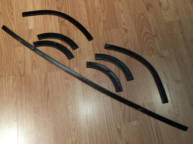

Just a minor update this evening; the powder coating guys have had to overcome a couple of major technical difficulties this week, but very kindly juggled the current jobs to squeeze my items in with another batch of satin black items.
Rear tinware can now be bolted in place, along with the Nimbus heat shield, the exhaust back pressure sensor plumbing, the exhaust silencer and a final alignment of the compressor outlet > intercooler input pipe.
Also now finished (that also needed incinerating, part of the delay) are the rear bumper fittings --->
The long folded section you can see was slightly twisted/distorted before it went over. Really taken a hit from the weather and temperature cycling, no original coating left. I was in two minds to just buy a new one, but another part that's just stupid £££'s from Porsche. Nothing lost by giving it a go with a refurb, and as usual, the guys have done a stelar job, just needs a little straightening (not worth doing beforehand, as the incinerator could've re-twisted it).

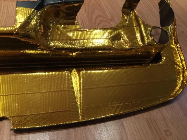

This evening I then got around to sticking the gold heat reflective tape onto the underside of the rear tinware. Expensive stuff, but I have to say, it's really nice to use. Quite forgiving and fairly malleable. Very pleased with how this came out, although I confess to thinking that I had more on the roll than there actually was, so a lot of measuring and dummy lay-ups to make sure I got as much of the really hot area done.
This will all be sitting behind the heat shields I made a few weeks ago, so a little OTT, but better that than have any heat related issues.

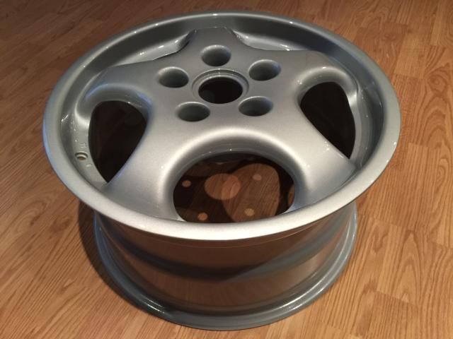

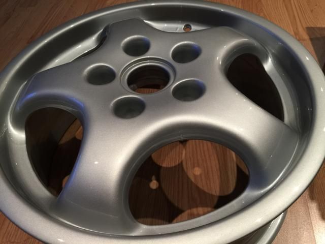

The Cup1 wheels arrived this morning - really pleased with these, fully refurbished and look just like new. The inners are re-done using the flat light grey that the Factory used, rather than the easy option a lot of refinishers take of using the same silver for the whole wheel.
Tyres are the next thing to start doing some investigating on; the trade-off between something like a Toyo R888 which I use on the Lotus - fantastic grip in the summer (and to be fair, dry winter roads as well); I've never tried any heroics on the odd occasion I've been caught out in heavy rain, but it's *not the best suited tyre* for that job.
Alternatively, I always got on well with the Michelin Pilot Sport 2's when I had the GT3, but with only a 17x9J rim and a 255 section tyre (which according to Bill Verburg, works the best on that wheel in his experience), I need every bit of traction I can muster. Way more hp and torque than the GT3 was pushing through those PS2's. Yokohama do what looks to be a half-way option in their street tyre range, perhaps that's a good candidate.....hmmmm......

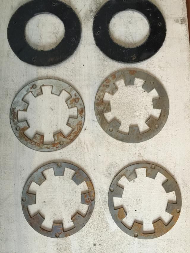

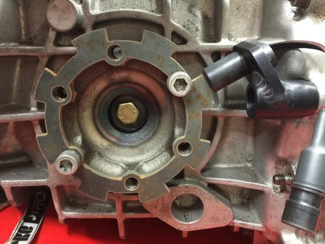

I now have the trigger wheels in my possession, freshly cut by the guys at Kent Waterjet. Brilliant job, very accommodating as well....despite my, er, "cock-up" (stop sniggering Chris!) with the rear wheel drawings. It's so embarrassing, I'm not even going to go there. Anyway, a new set now made and very nice they are too. Damn sight better that drilling and filing for a couple of days.
For those that don't know, water jet cutting is a lot more economical than laser cutting, but the slight downside is that with thicker materials, there is a tendency for the edges to be slightly tapered. Some of this can be dialled-out with constant setting up of the jets, but to a certain extent it's just one of those things. Paul did show me some really thick pieces that they've cut (for a Chinese nuclear plant, no less) that are made from some 1.5" thick steel, and I have to say, it's mighty impressive....the wonder of 3000bar pressure!
The rear wheels are made form 4mm steel, so there was a *tiny* bit of tapering on the OD, and as the sensors are mounted radially, with the sweetspot of the HE sensor only being about 3mm wide, I wanted to make sure that the sensor is getting a 100% clean signal. So, time to mount them onto the lathe and tickle the OD's. An added benefit was that I could absolutely tune the OD to the right size so that I have 1.5mm clearance to the HE sensor without needing a waffer-thin shim on the non LSD side. A quick Scotchbrite clean and they're ready for plating.
With the fronts, I got 2 designs made using 1.2mm material, as we'll be reading the teeth axially —>
...one that has a smaller OD - it's smaller than the ID of the ABS teeth (see previous photos), so it's completely hidden from "view" from the ABS sensor, but it means that the M3 holes that will need countersinking are very close to the outer edge. Option 2 has a larger OD with more material for mounting, but to prevent there being any possibility of the ABS sensor seeing this TC wheel, I also got some plastic discs made that will sit in between the ABS and TC wheels, shielding the ABS sensor from the TC wheel.

  • I found a K&N breather tank oil filter that I used to run on the Westfield - many years ago - and have used this as a temporary capping to the turbo oil drain tank breather. This will eventually interface to the inlet tract via an AN connection.
So, a very productive day. Tomorrows jobs are to remove the 4 x ignition amplifiers from the inner wing, and the capacitor that plugs into the alternator charging circuit. I want to also try out my new valve clearance setting tool - it should all be spot-on, but a good opportunity to play with the new toy I collected in Boston last year.
Heat shields to the underside of the rear tinware will go on, and the exhaust back pressure (EBP) pipework fixed into position.
The engine stand has now been broken down and stored…another big chunk of metal out of the way, another (slightly) momentous occasion.
I’m quite pleased with myself, have got my list of things to take up to the dyno - start it early and add to it when the odd brainwave pops up….far too efficient for me.
I did manage to sneak a 15/20mins chat with a very helpful guy at ITG, the guys who make air filters. I'll detail further in a later post, suffice to say that they're completely geared-up for making me a custom filter should I need to go that route. I think it may have to be, in order to fit down the LH side, clear the sensor bracket but still maintain the surface area needed to support this build. It may even be an oval filter, narrow and tall, probably 9-10" long, with a 3" outlet. Anyway, details on that later, once I've mocked something up and anticipated where the engine bay edge are.
A quick couple of pics of the new Cup1’s —>
Rear:
Front:
In terms of tyres, I think I’ve decided to go with some Yokohama AD08R’s - they seem to sit somewhere inbetween a durable road Michelin PS2 and track focussed Toyo R888. Although I love the R888’s on the Lotus, the chances of having to drive in standing water are higher in this car - it’s going to be going on European jaunts, more-so than the Exige would, and it’s a road car so the R888’s are going to be a noisier choice. Pirelli Trofeo’s would’ve been nice, but no sizes available that I need in 17”. The Yoko’s were recommended to me as being better than expected in heavy rain (thanks Frank!), so we’ll give them a go.
