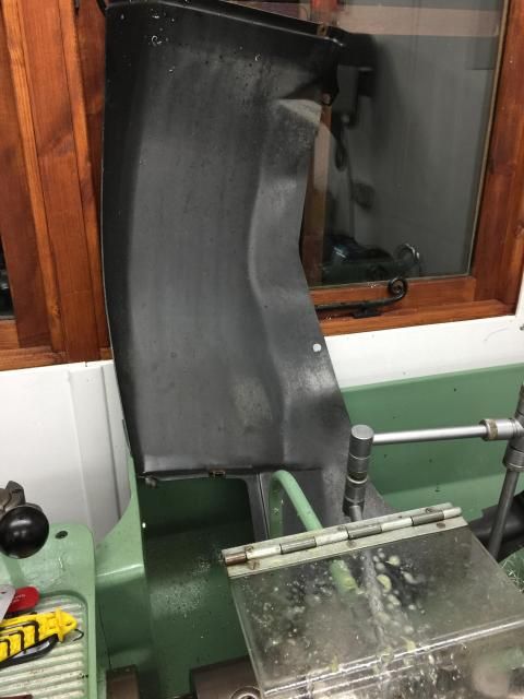

So, following up on the earlier post, the bumpers inner heat shield that mounts onto the box section aluminium structure was removed, washed and prepped for sticking.
Five M6 repair washers were used to fix the areas that had corroded and pulled through. The washers are going to be sandwiched between the ally and the heat cloth, so contact adhesive was used to keep them in place (you can just about see one of them on the far right in the photo)
Contact adhesive was then used to stick the middle section; have run out now until tomorrow, but will get some to then finish the end sections --->

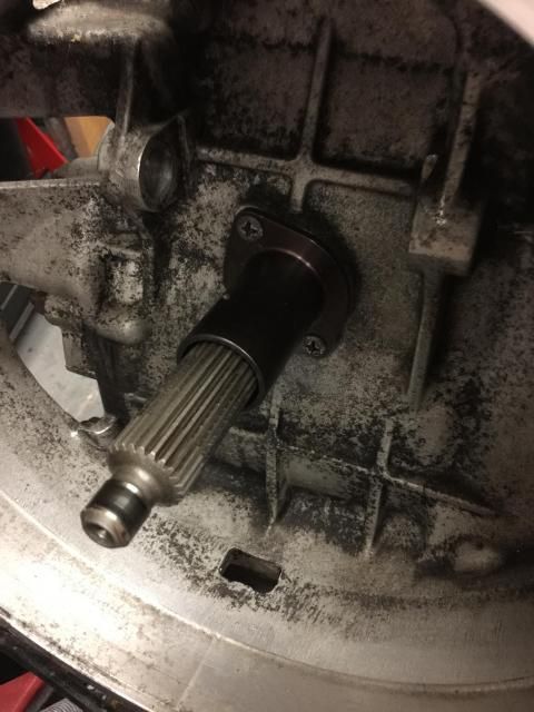

This evening I got around to shuffling the car around and took all the measurements I need for the front ABS timing wheel and front upright, in anticipation of the ally stock arriving in the next day or so. Now all drawn-up on the whiteboard, so it shouldn't take me too long to turn them on Wednesday.

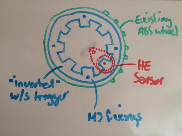

In the pics below, you can see the intended orientation of the HE sensor, but I need to check with Craig/Steve @ SBD whether the teeth of this wheel pass close enough to the centre of the sensor for it to register. Got a feeling it's not going to do the job, so will start thinking of a Plan B....perhaps it may require another 8x tooth wheel to be mounted onto the ABS wheel. Instead of having the trigger teeth on the outside of the circumference, maybe invert the design, so they sit on the inside of the "polo" ring.
The sensor will sit through a top-hat end cap, essentially an aluminium replacement for the plastic caps that Porsche use to cover the end of the stub axle. I'll then drill and tap a retaining hole into the upright, that will secure the top hat.

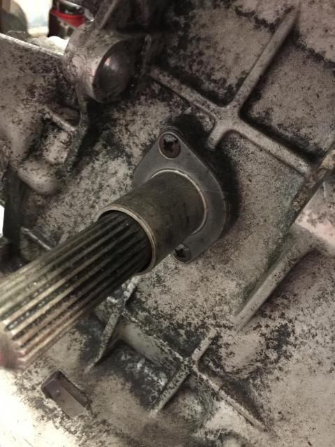

Wondering how much of a ball-ache it would be to remove that stub axle bolt and get the timing wheel out?.....

......In the pics below, you can see the intended orientation of the HE sensor, but I need to check with Craig/Steve @ SBD whether the teeth of this wheel pass close enough to the centre of the sensor for it to register. Got a feeling it's not going to do the job, so will start thinking of a Plan B....perhaps it may require another 8x tooth wheel to be mounted onto the ABS wheel. Instead of having the trigger teeth on the outside of the circumference, maybe invert the design, so they sit on the inside of the "polo" ring.
So, after an exchange of messages with Craig, looks like we need Plan B. Buggeration.
The plan at the moment is to indeed look at an inverted timing wheel, as described yesterday, rough diagram below --->
Oh well, unless the lead-times are daft, we'll get these cut from an outfit that does water cutting, locally to SBD. I'll then look to secure to the ABS timing wheel using 4x M3 countersunk screws....wonder what the chances are like of being able to drill and tap these into the stub axles, in-situ...hmmm

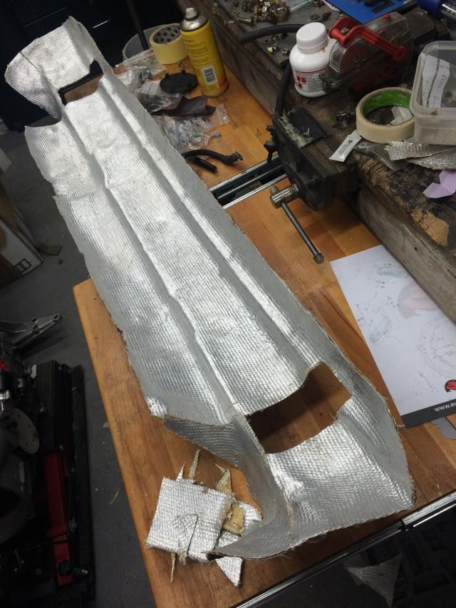

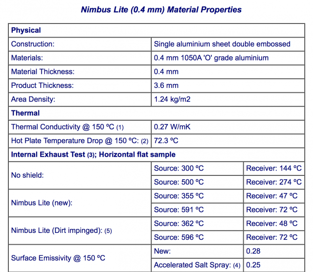

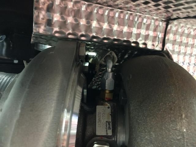

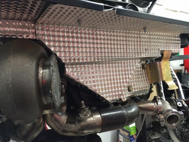

The heat proofing material arrived today. My overriding thought is that of not getting much for £65!
Template not yet finished, but have bought some very short 3/16" pop rivets and M5 washers, so that when I need to assemble the various sections of the Nimbus sheet, it'll be done robustly and they shouldn't pull through.
The bumper inner heat shield is now finished; just about managed to line the whole item with the sheet of material I had spare. It wasn't a new sheet, so it's not 100% neat, but pretty good and a damn sight better than what was there before --->
..................................snipped......... ........
Exactly! Why is reflective matting so expensive?! What's in this stuff?
Always thought that reflective matting was the best approach in combatting excessive heat vs. wrapping. Sticker shock to say the least.
God knows....it really is just plain ally sheeting but with a rather nifty stamped diamond profile, which I guess is "scientifically developed" to disperse and throw the heat. I confess to being rather cynical, especially as a mate of mine (Shaun the painter) now works for an independent Lotus outfit, and when up there the other day I saw dozens of huge sheets of the same stuff; apparently they use tonnes of it. At presumably far less ££'s than I paid! Dammit.

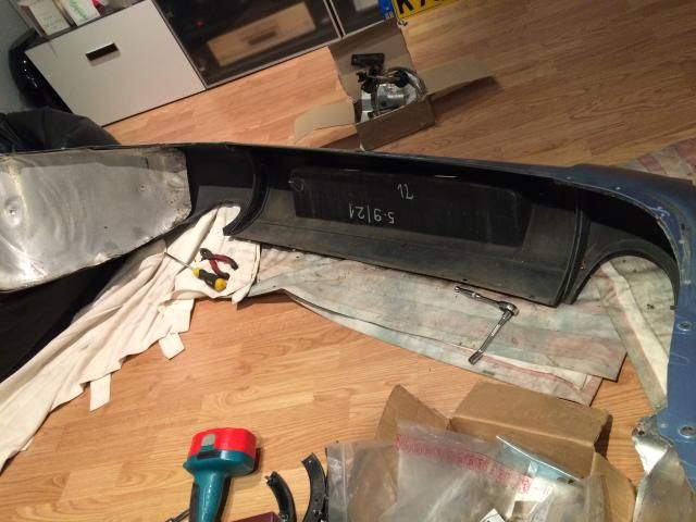

Just a quick update this evening....
After spending a lot of time making the cardboard template for the heat shield, I've spent the last few evenings carefully transposing this on the (above) Nimbus Lite material, then binding into shape and riveting. Not a quick job by any means, but I have to say, I'm rather pleased with the end result. Just loosely fitted for the time being, as I need to drill out 5-6 pilot holes in the tinware next. --->
So, the next job is to get the tinware re-coated; coating has now been compromised with the tinware fixing and the semi-circular cutout needed to clear the Lambda sensor (did I mention that previously?). Once it's back I can then apply the gold foil tape to the underside, that'll sit behind the Nimbus material.
For info (again, forgive me if this is a repost) here's the spec for the Nimbus material -->

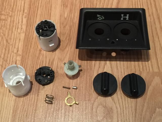

Have also got a double-switch switch unit from a Carrera 4 centre console - unfortunately it has an LED mounted, as do a lot of UK cars for the dealer fit alarm lamp - but I can re-purpose this with a tricolour LED that will be hooked up to the boost control switch, illuminating different colours for each preset boost level - bright red for the Spinal Tap setting, of course.

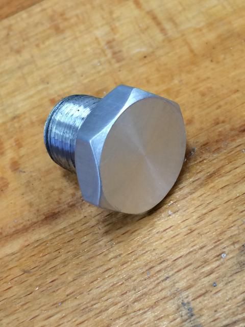

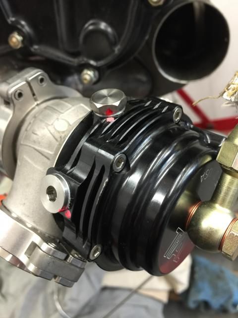

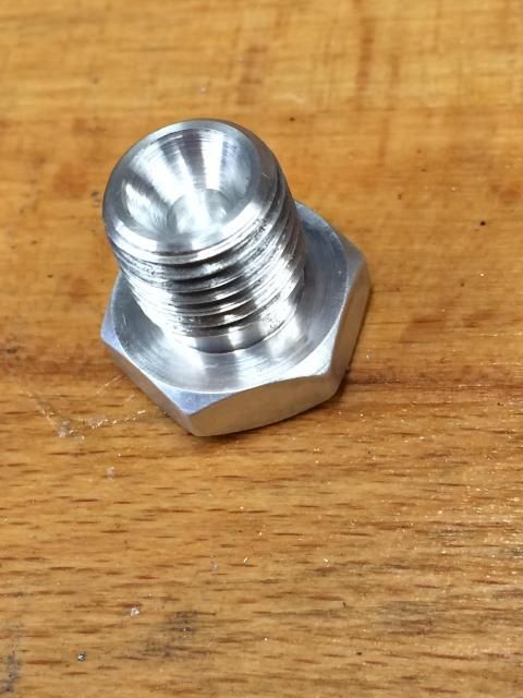

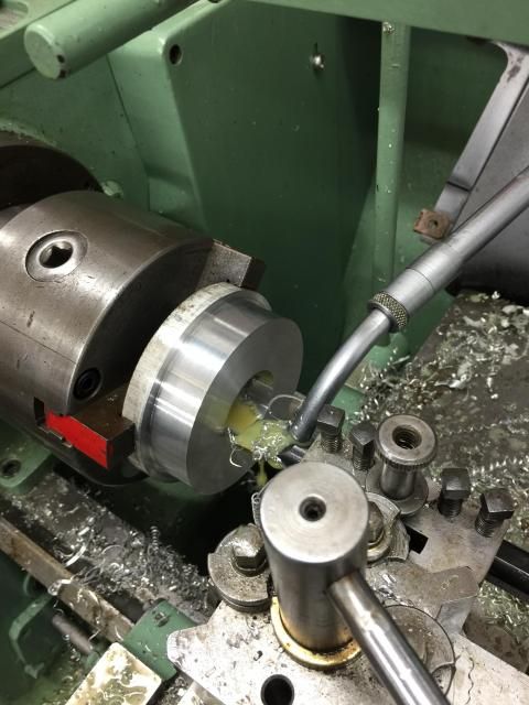

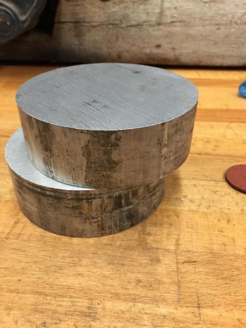

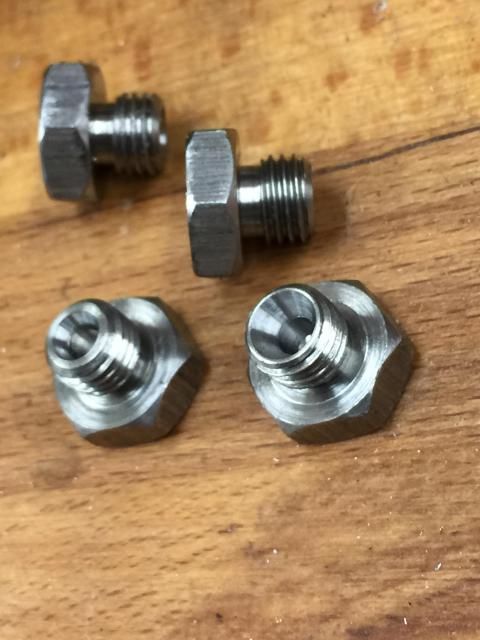

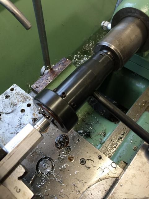

This weekend I’ve spent hours on the lathe; the metal stock finally arrived on Friday (it was only ordered straight after Christmas. Grr), so I was able to get on and make the ally blanking plug for the “chimney”; I’m no longer using the temp sender that’s normally used, and thanks Chris for confirming it’s M14x1.5.
Ordered a new tailstock die holder; far easier than trying to square up a handheld die holder against the tail stock, and a lot more accurate.
One complete plug, ready for anodising.
Then time to use the 13mm AF stainless stock to make the 4x M8x1.0 plugs that close off the water cooling ports on the wastegates - I don’t want anything open to the elements, just invites detritus to play havoc later on down the line. As I think I mentioned a few weeks ago, trying to buy M8 fine-thread fixings is not easy; tried my usual supplier of fixings, and he couldn't even think of anyone else to recommend. So, not going to naff about trying to track down something that's kind of "ok"...buy more tools and make some! Was surprised how long these took; quite fiddly getting the exact thread depths right, then grinding a custom tool to make the narrow undercut at the end of the thread. While I was at it, decided to tart them up and use a centre drill to hollow them out a little.
(still a little dirty with cutting lube)
Couldn’t find the packet of crush washers, so used that parting off tool again to quickly make four out of some ally stock….just finished flatting them, then found the packet. Sods law.

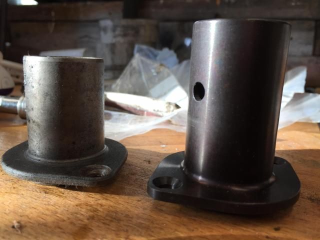

This morning, for a bit of a break, got around to doing a simple job - replace the short guide tube on the input shaft of the gearbox with the new one needed for the 964RS lightweight flywheel. I never ever regret buying any tools, quite often ones bought on an impulse but with no immediate requirement….they alway come in useful at some point, case-in-point being a (manual) impact driver set and a pneumatic impact wrench. I think I’ve used the hand impact driver once, and never used the air tool, preferring to always do wheel nuts manually….but I was glad to have both this morning as those M6 countersunk screws were well and truly “in”. The Philips bit form the impact set, plus the air tool, and it came out extremely easily. Must remember to use it more often….
Old tube —>
Side-by-side —>
New tube in place —>
Old 01-11-2015, 02:45 PM
  Pelican Parts Catalog | Tech Articles | Promos & Specials    Reply With Quote #390 (permalink)
Kartoffelkopf
Spenny_b's Avatar
Join Date: Dec 2010
Location: Hell Fire Corner, near Reg Seat of Gvmnt 12
Posts: 1,661

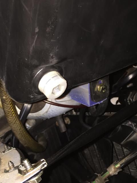

Finally…FINALLY I’ve sorted out the blessed windscreen washer tank screw cap annoyance. I had to buy a whole complete secondhand tank off of my pal Brian, but it was money well spent, as I’ve got a nice unbroken, clean screw cap. Note to self, don’t use allen key to remove or replace the cap in future….anyone need a new washer tank?

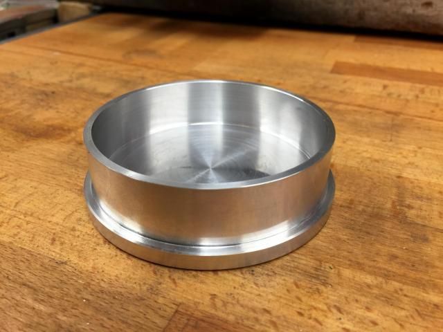

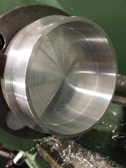

Then, this afternoon it was time to hop back onto the lathe and make a start on the next big job, the top-hats that will house the hall effect sensors on the front wheels, for the 4 wheel traction control setup.
These need to be pretty damn accurate to ensure that vibration won’t affect the readings, so lots of patience, lots of measurements.
The aluminium billet blanks —>
In the 3-jaw chuck for the first machining operation, a face, then turn the OD, then bore it so that it clears the trigger wheel that’s already mounted to the stub axle. Got to use a load of tools for the first time; the jaws in the chuck you see below, the new carbide tips I’ve got that are meant for turning ally; very impressed with the surface finish of these. Also my new 10mm boring bar to get the centre started, before moving onto the 16mm tool to really start removing material quickly —>
Lots of coolant = lots of splash. Good job I haven’t yet refitted the inner arches….they came in useful!
Then reverse it to face the outer surface, machining it down to the exact depth (6.6mm) that will accommodate a stainless M6 helicoil for the HE sensor.
The next machining operation will be to put a notch into the tube, about 10mm wide and 10mm deep, in order to clear the tip of the ABS magnetic sensor already in place on the hub.
Following that, the piece will be offset mounted into the 4-jaw chuck, so I can bore the hole for the hall effect sensor. May have to hold-off doing this for a while, as ideally I ought to get the trigger wheels made and installed, then double-check the offset required. Would hate to cock them up on the last phase. Finally, the hub will need drilling and tapping to accommodate a small cap-head screw (or maybe a grub screw) to lock the top-hat into the hub.
Very pleased with todays efforts, especially with being able to get every dimension on the top-hats to within 0.02mm of my drawings. Along with the tools I ordered the other day, I also bought a 3MT test bar, and a 4MT>3MT adapter to allow a centre to fit into the headstock. With another centre in the tailstock and the test bar mounted between centres, I did a quick DTI check on the tailstock alignment - about 0.1mm out over the length, so could be adjusted a little tighter, but not wildly out for what I need at the moment. I'll check headstock alignment later this week, but again judging by how well todays parts have come out, and how nice the lathe cuts in general, it feels pretty good.

Interim update tonight. Managed to get a flying start after finishing work this evening; straight into the workshop without any distractions.....
Got the second top-hat made - took less than half the time of the first, dimensionally spot-on again, and a lovely fit inside the upright.
You can see below how they're going to fit; clearly the one below isn't all the way in, they need those reliefs machining to clear the ABS sensor, which will be tomorrow nights task.
No more garage work this evening - need to get some drawings done for the trigger wheels and get them underway.

Some quick tinkering whilst sitting in front of the telly watching a replay of the Colts beat the Broncos (at home...bye bye Peyton, imho)
Took the Carrera 4 switch panel apart, ready for Simon to play with it and get some rotary switches to fit.
As you can see, not much to them; I thought that there'd be a momentary switch unit housed inside the white tubes, but actually the white tubes are the housing with the sprung contacts, actuator and contact plate all loaded into the tube. Quite tough to undo, rigid plastics and 3 x detents that need to be wiggled out, but do-able.
A quick wash later (you wouldn't believe how much food crummage there was under the switch knobs) and it looks good as new. Really hoping we can use some guerrilla engineering to meld our functions into the stock looking panel. Even the switch legends are kind-of right....the left hand one = pic of rear of the car = engine bay = boost setting. The RH legend = 4wd bias adjust = i.e., traction = traction control setting. Squinting. And with imaginative thinking....

Just to add something to this thread. An exhaust builder here uses the reflective tape on the exhaust systems themselves:
Old 01-14-2015, 05:59 AM
  Pelican Parts Catalog | Tech Articles | Promos & Specials    Reply With Quote #397 (permalink)
Kartoffelkopf
Spenny_b's Avatar
Join Date: Dec 2010
Posts: 1,661
Hmm interesting....lots of work gone into that, although does look to be a hard way of achieving the same thing as the exhaust wrap tape -->
Titanium Exhaust Wrap
Or even these jackets (which I confess, I wasn't aware of until a few moments ago) --->
Exhaust Jackets
...and arguably far less serviceable, should the need arise.
I used the tape wrap on my Westfield, where the over-the-chassis-rail 4-1 manifold came very close to the engine cover....worked beautifully, really controlled the temps, looked ok once painted in the black paint that you can also buy.....BUT....there is a school of thought with exhaust wrapping like this (and I'm referring to a discussion I read that was specific to the Vauxhall/GM XE "red top" engine, not Porsche flat 6's) where the increased internal temps at the start of the primaries had a significant detrimental effect on the cylinder head. Now, I never suffered any damage on my XE Red Top, so it could be urban myth, but I also do know that moisture that collects when heating/cooling sits between the manifold and the wrap and can speed up corrosion.
ETA - this Zircotec solution is probably the ideal way of overcoming all the above, and one I've considered; I may come back to that as Phase 2, once we've established that the geometry of my headers work well and there's no alterations needed..

From what he told me is that it has a few advantages.
1. Can be placed in any location, around any type of bend or material
2. Does not need to be replaced, but can be repaired
3. exhaust wrap, if not done correctly is not as effective, especially around bends
4. Exhaust wrap will deteriorate after time
I am not sure how it compares to ceramic or other coatings, or whether price is the choice for or against more use.
