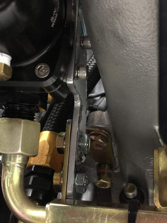

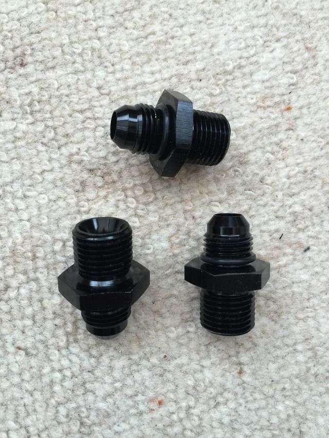

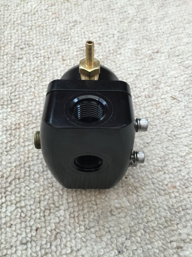

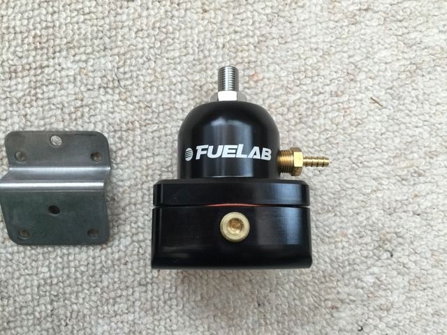

While I was away, my new fuel regulator arrived from Think Automotive; a lovely FueLabs 51502, in "discrete black", of course....
This model is for EFI applications, -6AN connections with a bottom return outlet....
And the required -6AN > M16 adapters + sealing O-rings...
Having just gone out to the workshop and offered-up the regulator to the fuel rails, I reckon that by removing the stock regulator mounting bracket, there *may* just be enough room to install it in the original location, then use the 3x M4 tapped mounting holes to fabricate a bracket to mount it to the inlet manifold. Certainly don't want the mass of the regulator being carried by the M16 junction at the end of the 1-2-3 rail.
Back later with pics to show what I'm referring to. So long as the jet lag doesn't kick in.

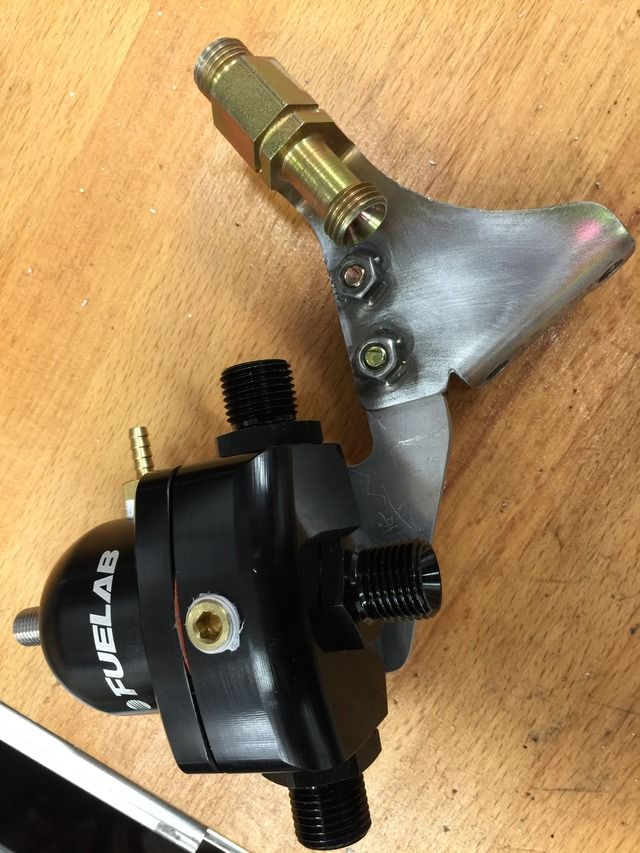

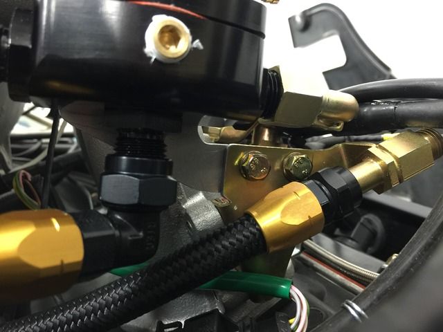

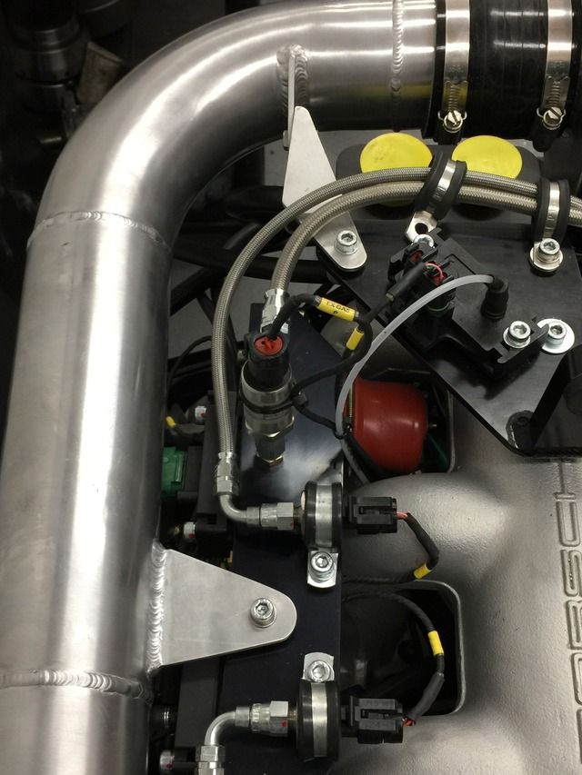

Some progress over the weekend.....
Started shuffling around the electrical items mounted on the relay/fuse board on the LH inner wing. Hoping I can get away without making a whole new assembly, as I'm pretty sure that it's just the externally mounted blade fuse holders (4) and the bulge in the stock plastic cover, that foul the inlet tract.
So, I re-drilled the fuse holder mounts under the location where normally the far left relay mounts. Relocated the relays one-hole-to-the-right to make space...
Then started to make a new ally cover. Some strange compound angles going on, and not convinced I've got this to my satisfaction (or close enough in terms of fitting)....but got a little frustrated with it so moved onto other things:

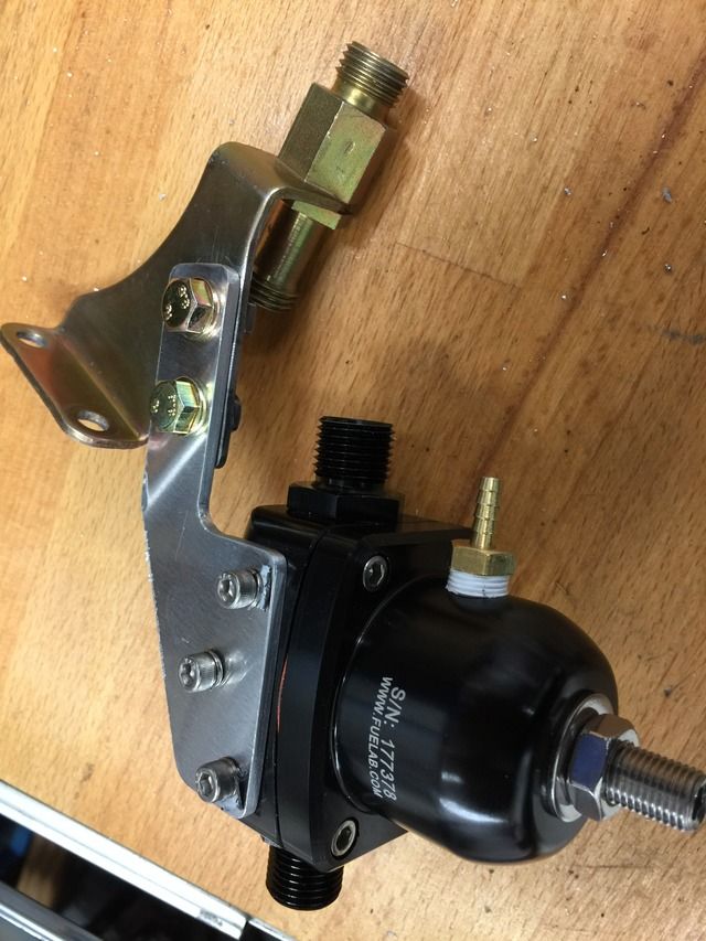

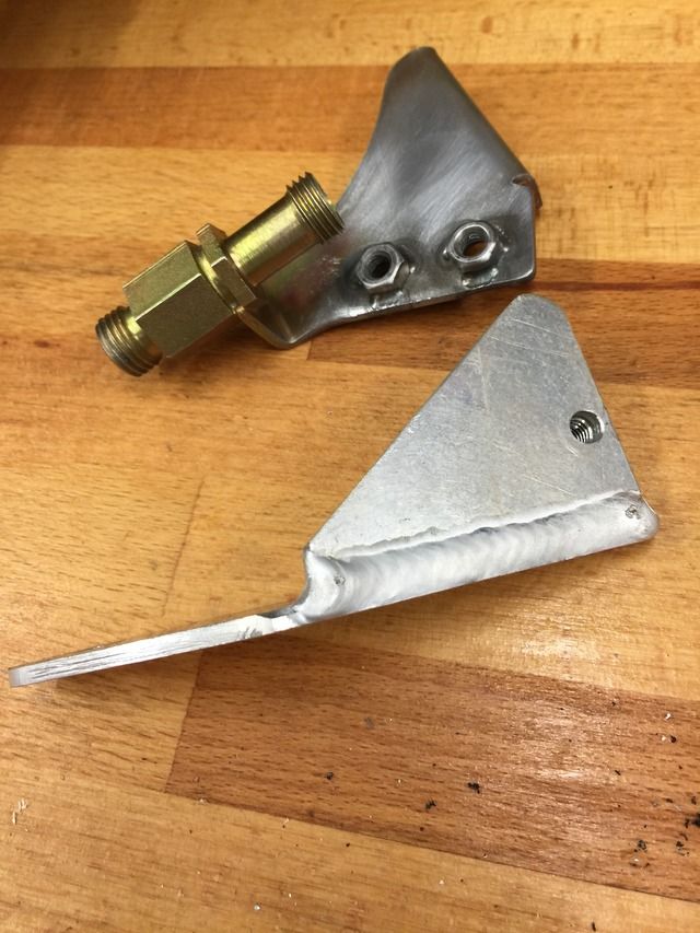

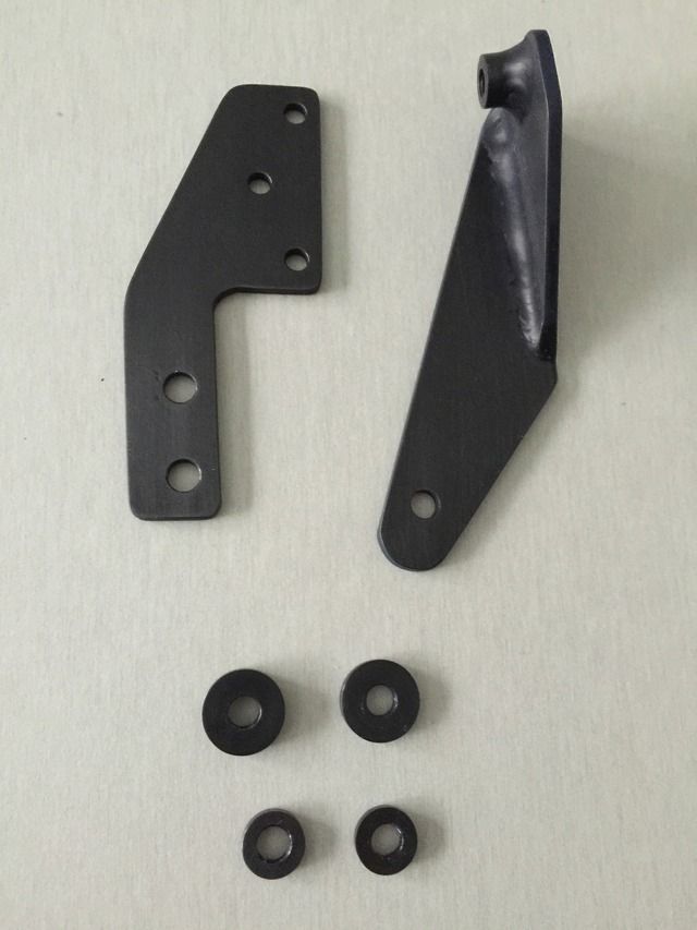

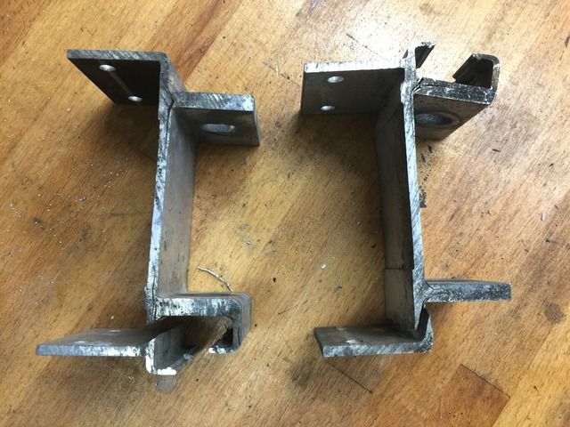

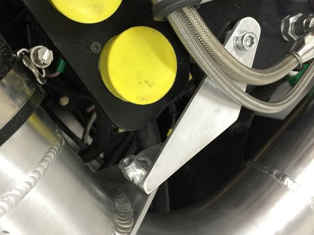

Per the previous post concerning the FPR, here's how it's going to mount after spending a few hours in the garage this evening:
The inlet manifold needs a little fettling under the breather connection, to clear the 4-5-6 fuel rail return into the FPR (or I buy a 45º fitting)....it does all clear (by less than 1mm) if the connection is fitted to the FPR before the FPR is mounted to the engine, but again, not great for future serviceability.
Some 3mm ally plate was used to make the hockey stick shaped bracket that now mounts onto the OE steel item. Pleased how this has turned out - discrete and will prevent any vibration fractures to the injection rail itself. The unit is mounted at an angle such that the pressure adjustment clears the management wiring harness, directly above. Of course, it'll get black anodised, as/when the next batch is taken over to the plating shop. The steel bracket will have 2x M6 plain nuts welded to the reverse side, then the unit will use 2x M6 bolts from the other direction.
As you can see, I've chopped the stock bracket; this normally mounts the OE pressure regulator plus the injection return line, making it a lot more accessible for connection/disconnection when servicing or removing the engine. It would've been a lot easier to bin the whole bracket, however, being able to contort oneself with the engine in the car, to be able to brace the FPR whilst tightening it, wasn't something I wanted to risk....either that, or it's a case of installing a "floating" male-male connection in the line, which isn't ideal either.

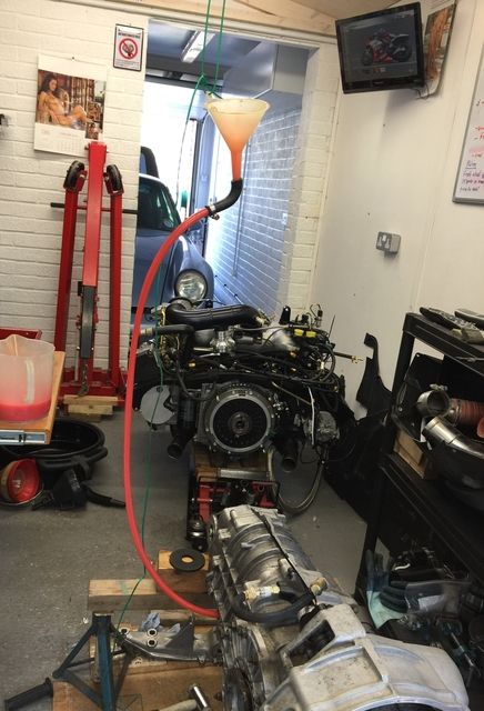

  • Multi-V belt now back on the crank pulley ready for hooking up to the AC pump once the engine's in
  • PS pump is now re-installed with the belt (removed for dyno testing so it didn't run dry)

The rear inlet tract mounting bracket is now re-made; I initially made one from a sheet of mild steel which happened to be lying around, and it performed ok on the dyno, but IMO it's too flexible for use in the wild. Time to make a new one from 3mm plate ally, which I dropped over to Pete for welding the other day.
Some filing and fettling and it looks great; in-keeping with the rest of the bracketry in that area, and the welded cylindrical nut on the back ensures there's plenty of thread engagement to prevent any stripping.
I also asked Pete to quickly buzz on a couple of captive nuts onto the modified fuel pressure regulator bracket, which will now be re-plated. Collected both parts on the way home this evening.
It all assembles up very nicely...

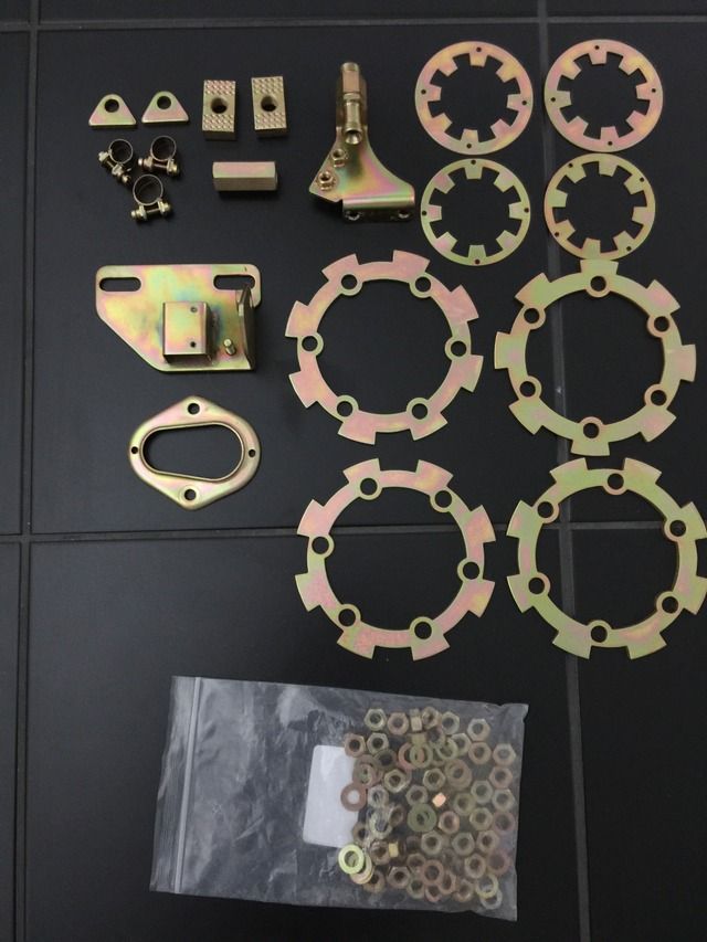

A rather large bag of assorted items went over to my plating shop late last week...plus another visit over the weekend to drop in a forgotten item.....and a 3rd trip on Sunday for 2 more items that escaped my attention! It's all back now, collected this lunchtime and looks great.
A whole load of gold passivate plating.....
And some black anodised items; the inlet tract bracket, the fuel pressure mount and some assorted spacers that are used on the sensor bracket....black, black, black....

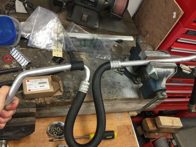

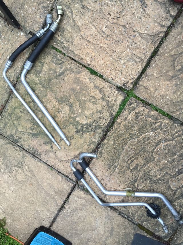

Spoke with the guy at Burgaflex, the company looking to make my custom AC lines - very helpful, and it looks like my brainwave idea may indeed be the easiest and most cost effective way to achieving the re-routing project.
In short, my plan was to use both sections of hard line on both hoses, but remove the 100º bend on each, then join each section with a short length of barrier hose. A quick mock-up to show what I'm on about....
So this evening I set about chopping off the middle section of rubber hose, leaving the bare ends of each. Somehow I thought the swage "collar" would be more pronounced than this, although I guess the pressures aren't massively high, so perhaps no need...
I’ll take another pic tomorrow once I’ve got it in-situ for measuring.

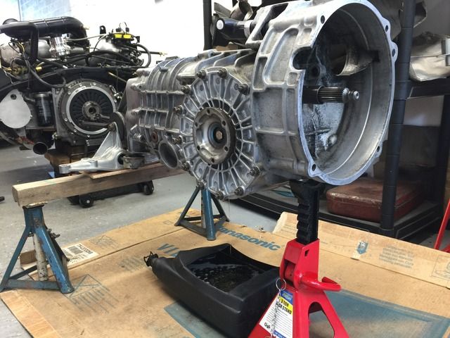

Gearbox oil drained - this was freshly filled using Millers 75w90 before I took the car off the road 4yrs ago, however, the shift quality was noticeably worse than whatever oil was previously in there. The trouble was, I didn’t know what the previous owner had used (I changed all fluids when I bought the car). It's been at the back of my mind to change it, so it’s the perfect opportunity before reinstalling everything.
After posting a few threads and doing some research, the final decision with which oil to use was made when a recommendation of a secret formula was made by a mate
The gearbox lifted up on axle stands so I could drain it.....
Then an additional hand courtesy of some old washing line; a bit Heath-Robinson, but it did the trick...stank like hell, the usual God-awful stench of transmission fluid (which my daughter loves….which is weird) but with a hint of coconut.

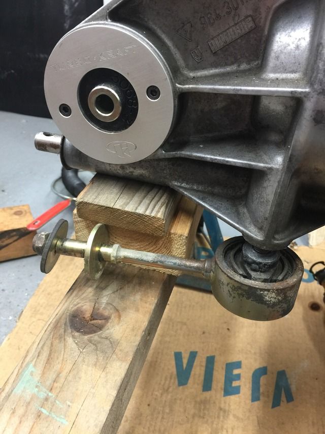

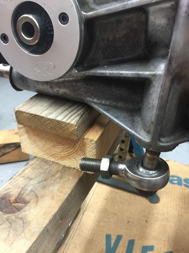

I had a cunning plan this afternoon; I have a load of “Goldline” rosejoints in my parts bin, really nice high quality ones from a previous project; it occurred to me that with the upgraded power unit mounts (gearbox tail mount using the TurboKraft item, the 964RS engine mounts and the Goldenrod shift linkage), whether it may be worth using a rosejoint to replace the stock stabiliser bar? It’s a lot heavier duty than the diameter of the stock unit (they were previously used on unequal length wishbone mounts).
Stock stabiliser bar --->
Use of a rosejoint instead (plus a spacer to obtain the correct distance from the housing) --->
I’ll probably look to retain the rubber mounts where it installs into the cross member, otherwise it becomes a solid mount and likely to really increase the NVH.
Has anyone got any experience of doing this kind of thing? Am I doing a really stupid thing in terms of stressing the gearbox case?

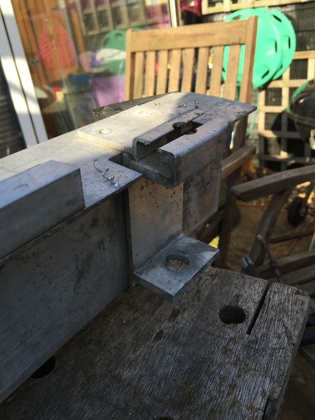

Sunny weather = BBQ plus 2 live feeds of the Nurburgring 24hrs + beers…So, the last job of the evening was to remove the rear bumper beam supports.
The rivets holding each mount onto the beam are big, so I was anticipating an absolute pig of a job to remove them as the centre stems were flush with the rivet head. So in order to get them out, some accurate centre punching and careful drilling….however…..after doing exactly this for the first one, which went well, I then discovered that using a parallel punch of exactly the right diameter, a swift thump knocked the steel centres right out, just leaving the heads to drill off. Once the heads were off, another carefully selected punch from the arsenal was used to drive out the core. Easy! Within 20mins, I had all eight removed.
The brackets were so heavily corroded that they fell off, each one breaking into two pieces. No idea how the bumper assembly even held in place when it was on the car; bit scary actually, the whole unit could easily have parted company on the road.
I’m undecided how to now make-good the beam; I can do a similar procedure to remove the black plastic “buffers”, then either vapour blast and anodise it. Another option (with the buffers removed) would be to powder coat it; no need to vapour blast it, the powder coating shop always media blast items in-house before coating. Powder coating is preferable, but would just need some handling care when the new mounts are fabricated....will think about it overnight, no rush.
