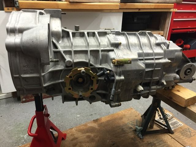

A quick end-of-weekend update....
Lots of odd jobs done today, nothing which makes for interesting photos really, but good steady progress nonetheless....the above To Do list gets shorter, but then I remember a few jobs that aren't even on the list. So, being the CMO (Chief Motivation Officer) on this project, I'm adding the unlisted jobs and instantly greying them out! Good for morale....

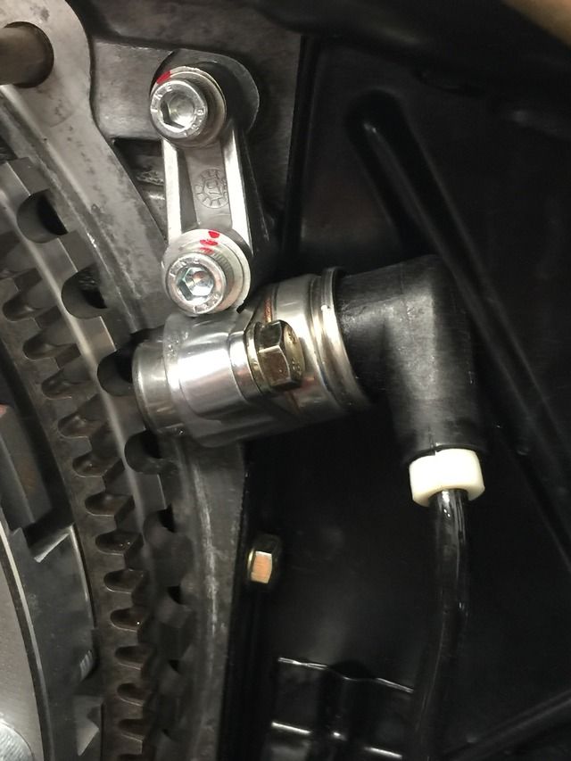

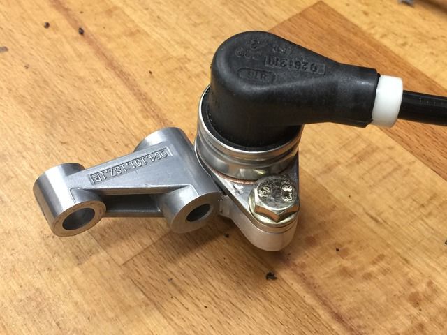

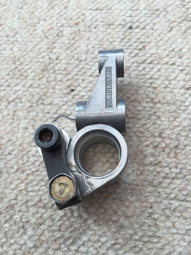

The inside of the bell housing is something that's irritated me for almost 4yrs. When I cleaned the gearbox back in 2011, the outer casing came up pretty well, but by the time I got to cleaning the inside of the bell housing with the seemingly baked-on clutch plate remnants, I started to lose-the-will; I gave it as much of a clean as I could be bothered with and left it for another day. Maybe.
So today, in an effort to clear some of the boxes and bags of parts I've got stashed around the house, I assembled the clutch release arm assembly and fitted new guide sleeve screws; the old ones got a bit chewed when I removed the old guide tube. Whilst I was at it, I dug out some aluminium cleaner that I bought years ago, but dismissed as being too much effort (i.e., it didn't work instantly!). A few hours of constant re-appliction and scrubbing, and it's come up very well....
I've just installed the release arm temporarily just to make sure it all fits and get it out of the way; I'm aware that the shaft needs to come out when mating the gearbox to the engine
The re-plated clutch line fitting (M14 female>female) is also now back on the car.

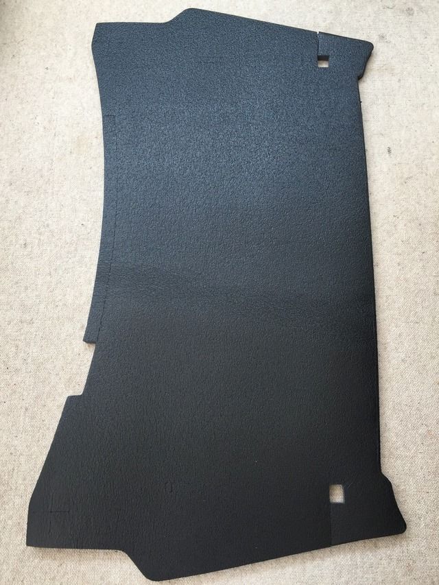

Another job I've been meaning to do since last summer, when I last had the rattle cans out, was to repair some corrosion on the underside of the rear arch on the LH side. The return lip where the bumper bolts onto had obviously trapped some water and taken its toll, so time to wire brush it back to bare metal and repaint. Not a huge job, just one that will prevent me from fitting the rear bumper and associated arch liners. All done now, good as new.
I've ordered some Raceglaze "AluBright" as well; this gets some really good press in the detailing forums, specifically for ridding fixings of rust when left in a tub overnight, and for bringing up aluminium components to an almost new look. My first use will be on the gearbox case, see if I can get it just a little bit better than it is at the moment, before giving it a coat of clear Dinitrol to give it the long term protection. The AluBright should also prove useful for the future suspension refurb project.
Oh, and I gave the garage and workshop a damn good tidy up...been far too long, tripping over the clutter eventually wore thin. So a busy day, just not too much to really show for it!

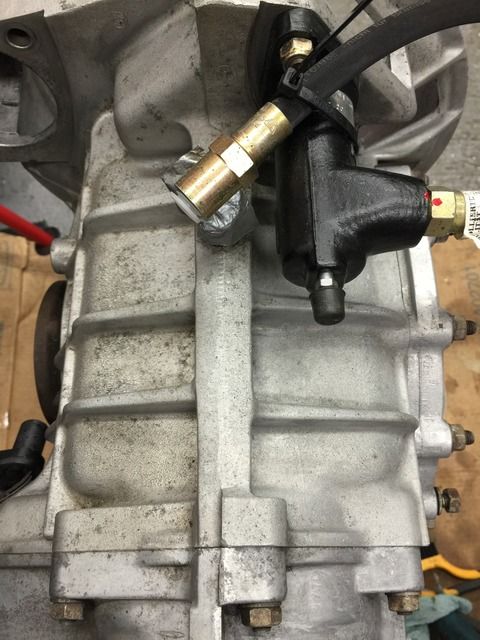

So, quick switch of some of the tighter vacuum lines between the intake and the fuel dampener and FPR. Easy job, another greyed out item.
Next job was to strip the bumper crash structure. All going ok until 4 of the jumbo rivets started spinning, but got there in the end without damaging the plastic buffer things.
In-for-a-penny, and all that...one of the M6 tapped holes at the end had so badly rotted that the ally was peeling back from the edge. So, time to chop it out and chamfer the edges. I'll make up an infill for welding, then drill/tap before taking it over to be powder coated.
Same hole but the other end....

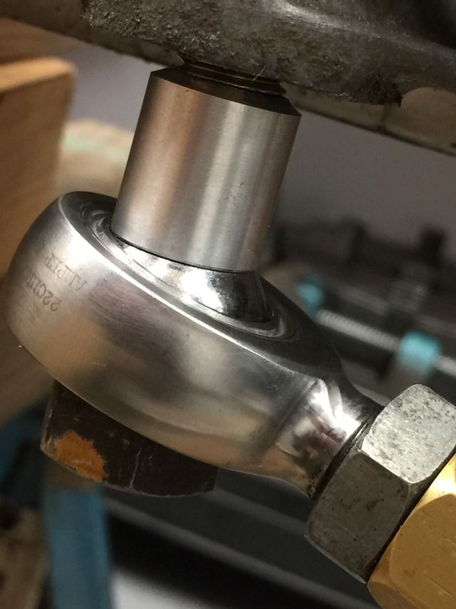

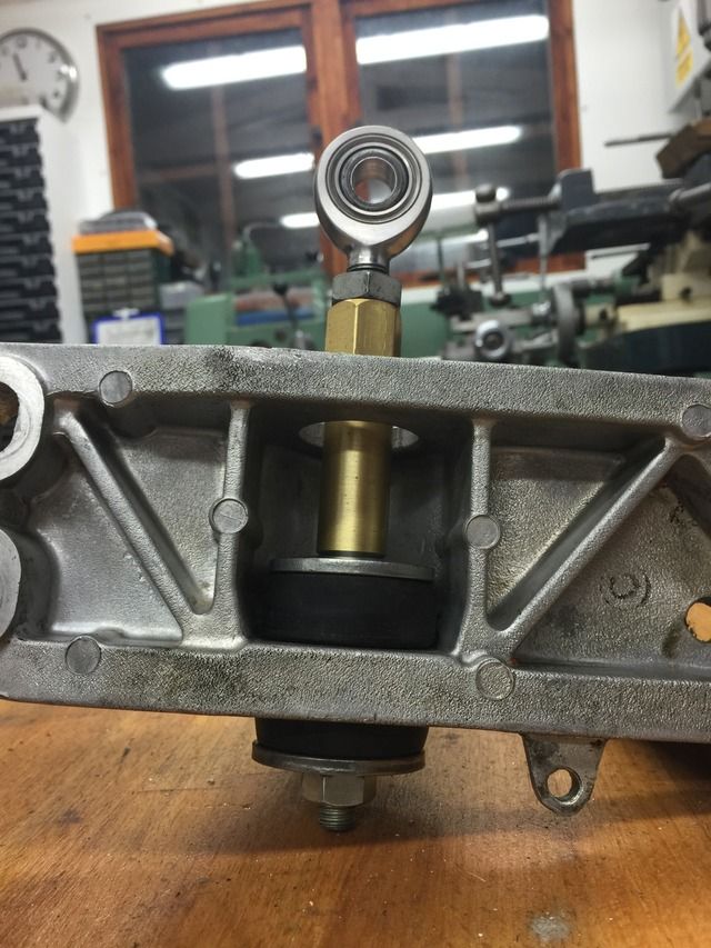

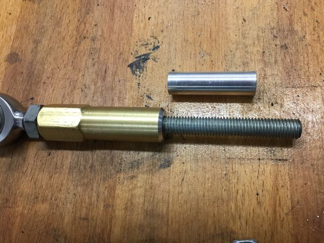

Time to then get on with the transmission stabiliser bar; still not got a definitive answer as to whether a steel part can be replated if there's a bonded in rubber insert...or whether it dissolves it. My plating shop don't know until they try - the trouble is, it's a pretty expensive part to experiment with, so I'll drop over some other rubber bobbins to try with....it all may be an academic exercise if my Plan B turns out OK, i.e., making a new one with a pukka rose joint.
First off, a waffer-thin sleeve needed making to reduce the ID of the joint to that of the M12 bolt. Something like 0.5mm wall thickness, but surprising how wobbly it felt without it. It's now spot on to the 1/100th mm.
Spacer next; some doodling on the whiteboard....
...and I had the dimensions for the stand-off needed to put the RJ in the correct position....
And that's about it for tonight, getting too late to carry on machining, but the next job is to shorten an old steering arm....up-cycling....then make another sleeve for the rubber donuts to slide onto inside the crossmember.

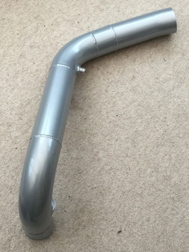

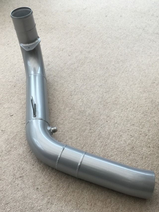

4) The 3" inlet tract is now powder-coated, ready for collection tomorrow lunchtime.

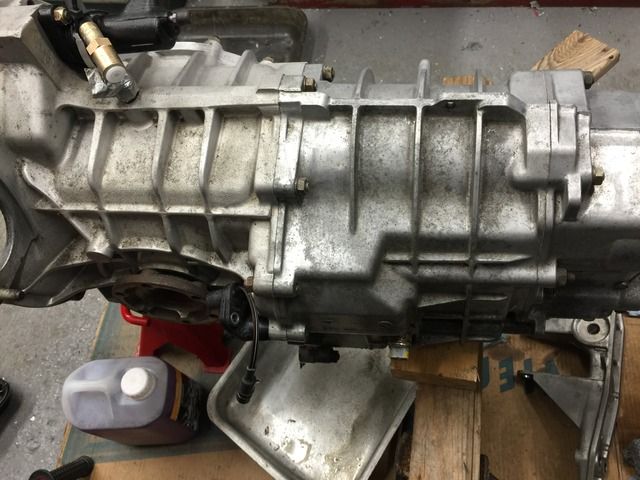

5) The AluBright arrived via courier this afternoon - it stinks, so it must be good. And so it proved to be when I got stuck into the gearbox this evening. Now, bear in mind that I'd already spent HOURS cleaning the casing when I first removed it almost 4yrs ago...this is still way cleaner than it came out of the car, but in true "detailing forum" style, a 50/50 shot....
I don't think the photo's really do it justice, in reality it does look a lot nicer. I wouldn't say it quite looks like a factory fresh casing (as some of the "reviews" have said) but I could see it lifting the staining as I applied it. The clean side had perhaps an hours worth of work, keeping it wet and scrubbing with some hard nylon brushes and brass wire brush for the really stubborn spots. The rough cast casing has come up a lot less yellow, so it's clearly removed some of the deep grime. It's also very good at removing surface rust; the case nuts are coming up quite nice, as are the output flanges where the acid has dribbled onto them.
AluBright cleaned side --->
Other side --->
Of course, this is just a filler job and doesn't need to be finished until the 'box is reinstalled, so I'll recommence this tomorrow evening.

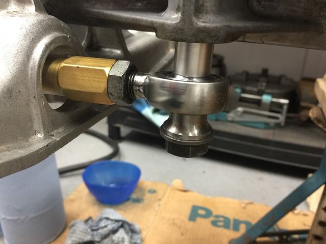

6) The job I did need to finish this evening is the transmission stabiliser bar, so that I can drop it off for plating tomorrow lunchtime.
Very pleased how this has come out - I really hope I'm not doing something stupid by fitting this, or that it makes driving the car half a step removed from a track car.
The gold rod that was a steering arm was shortened and an M10 thread cut into the non rose joint end. A piece of M10 studding was also turned to length, this will be thread locked in place. An ally sleeve was next to be made (13mm dia) for the rubber donuts to sit on.
The stabiliser bolted onto the crossmember....
The gearbox end attached....
Finally, another piece of up cycling, a spare rose joint spacer that I must've made about 20yrs ago was modified to remove a locating diameter, then bored out to the correct 11.8mm ID. This sits between the bolt head and the RJ, to allow full joint articulation without fouling the bolt head. I also hadn't realised that this bolt is an M12 fine thread until this evening.

3) ...And whilst there, I collected the freshly coated intake pipe. Chuffed to bits with this, it's come out exactly as I wanted, another superb job by Butterworths.

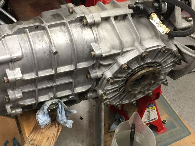

A quick coffee break update from last nights activites.
Well, so much for the easier evening and putting my feet up and watching TV! I seem to be on a roll at the moment, probably the light at the end of the tunnel meaning that I'm right in the middle of "the big push"?
Anyway, I spent the evening inhaling AluBright fumes and cleaned the other half of the gearbox casing...and some of the first half again....and the inside of the bellhousing....again....
Once that was done, a great opportunity to then swap out the corroded nuts and washers on the casings, for the freshly plated ones I got back last week. Could also get the 2 brackets on there for wiring retention, plus the two brackets for the hall-effect sensors used for traction control.
And that's where I'm now going to draw a line and stop cleaning. The crossmember is also gleaming again, and I reckon it's ready for a coat of Dinitrol clear; eager to try this and see what it looks like; I'm pretty sure it dries to a solid waxy finish, but will test on a scrap piece of ally first.
A pic of the intake pipework quickly plonked into place on the engine ---->

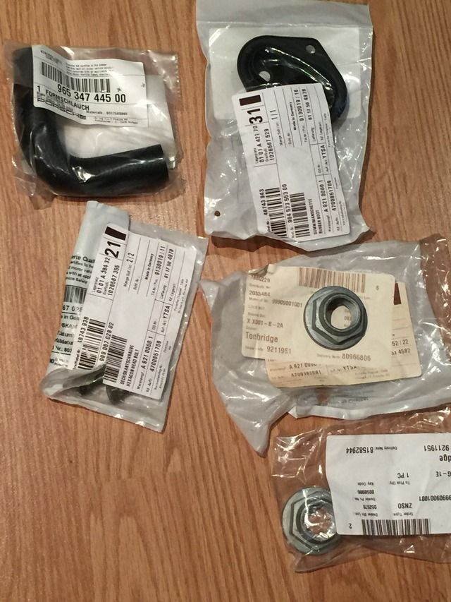

Managed to get there just before they closed....I've said it before, but it still amazes me how little you get for $130....hub nuts, $30 each! They're not even shiny!
And as you can see, the clutch line - for the most part - comes un-formed. Bugger. OPC are happy to take it back if I don't want the faff of bending it myself; I'm sure I don't have a tool for this diameter tubing (its bigger than brake lines), nor am I confident of getting it accurately bent to the shape of the original. And it looks too long.
Hmmm....maybe time to revert to Plan A and get a custom single-piece hose made using braided line.

Last night, I had a think about how best to make a new crank position sensor bracket. I'd decided that it'd be a quick job just to use some right-angle ally extrusion, but upon removing the OE bracket, it turns out it's not a flat surface to mount onto. Neither are the mounting holes conducive to a piece of right-angle stock. To use it, I'd need to make 2x spacers to sit the sensor in the correct place; these would then need welding into place...all a bit over complicated.
Then it struck me over a cuppa this morning....dead simple, just make a new M6 threaded boss and get Pete to weld it in the correct orientation for the magnetic sensor. Unlike the Honeywell 1GT101DC sensors that we're using for the crank phase detection and TC wheelspeed, this sensor does need correct orientation.
I'll cut off the old mounting hole once the jig is finished with, thus removing any chance for mis-installation should the sensor ever need removing/reinstalling.
I forgot to mention, despite me wanting to switch back to using a HE crank position sensor, it turns out we can't...to many unknowns with how a new sensor behaves electrically, i.e. the rise and fall of the signal. Of course it's critical to the timing of the engine, so if this is "out" versus the sensor we mapped with, then it could easily be game over in a big way.
So, I'm sticking with the sensor we used a few weeks ago and tidying up the mounting (it was quickly knocked-up at the 11th hour, to get the engine fired on the dyno), and Simon will fettle the harness on Saturday to tidy that up too.

Crank position sensor bracket now welded up - bit of a tough job just being able to get the torch in there, but Pete managed to get a sufficiently strong weld on there to hold the new boss.
Some filing and fettling and this is how it now looks....
And then installed onto the engine....
Fairly unremarkable, but....cross it off the list.

I decided to replace the engine bay sound-proofing pad the other day; most of it is absolutely fine and in good condition; the odd tear but would be hidden once the engine's in. The part that I wasn't happy with is the edge that hits you as soon as the lid is opened - it's gone brittle and has broken off in places, and has sagged inbetween the plastic fixings. I did try and stick it back, but it looks rubbish.
So, a quick call to Tonbridge OPC to get one ordered - last night after I got home from work, their Service Manager very kindly hand delivered it to my house on his way home! What a good guy!
Now, the first thing that struck me was that it's of a completely different construction to the one I already have.
Curious - there's no part number succession, and only one part number for all models of 964 (964 556 281 01)....so whether my original one has been replaced with another type at some point in it's life, I have no idea. Logic says that the harder shell/skin of the original one *probably* reverberates noise rather than absorb it. The new one feels a lot lighter in construction, and softer on the surface, so will be interesting to find out if this will perform differently - it'll certainly be thinner once glued in place, so a few extra mm of space for A/C lines and the air filter.....perhaps.

The latest batch of parts sent for re-plating was ready for collection this lunchtime - a quick jaunt down the road to collect and I now have the parts needed to re-assemble the gearbox stabiliser and cross member.
Loads of other sundry fixings plated as well; transmission cover fixings, tunnel fixings, etc.
The re-plating of the original stabiliser bar - with the rubber insert still in place - was successful. I'm going to run with my new custom rose jointed setup to start with. If it turns out to be more aggravating than useful, then I have a freshened OE unit ready to go.

  • Remove front stub shafts and install the timing rings
  • Finish the transmission stabiliser bar & crossmember

Good, productive day so far.
I finished off the stabiliser bar for the transmission early this morning, then another thorough tidy up of the workshop before Simon arrived. By mid afternoon the harness was finished, including making up the auxiliary harness for the variable boost, traction control and the outputs for a shift light and boost gauge. As I had to remove the original dealer fit immobiliser system (it was wired into the harness that I no longer needed, thus removed), we've also now re-installed "a certain amount of new security" - not going into details of course, but today was the ideal time to do it.
The sound pad came out without too much of a fight. Some tidying-up of old glue and foam took an hour or so, and I'm now ready to wrestle with the new pad to get it in. I was trying to save effort by not removing some of the pipework and hoses that run along the back, but as is always the way, save 10mins by not removing them, but spend 30mins working around it.....so, now fed and watered, the evening shift begins and it's coming out.
Back soon with another progress report....
