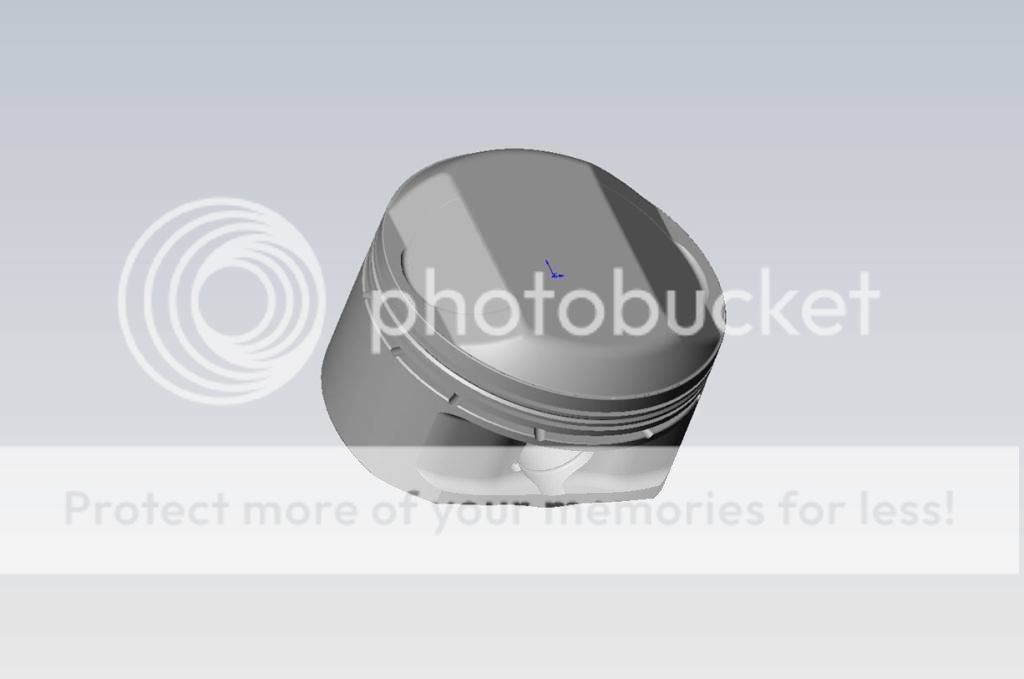

James,
Are you trying to get to a place more like this?
If you have a good piston vice for your mill you could get closer. This was a piston done by CP to my spec.
Good luck.
Stay Tuned,
PFM

Checking with J&E is certainly the sensible thing to do. But I, too, think there must be room there for this. It is the obvious way for the pistons to be made with the potential for a wide range of compression ratios. They build enough meat into these pistons so that the valve pockets can be made in various widths and depths.
I'm fascinated by the math one would need to calculate how much to cut to remove what volume of material. Where the cut widens at the valve pockets, that would be simple I think. But those rounded sides! Maybe computer modeling can deal with all that so you don't have to cut and try?

Of course you have to measure it, that's not tough if you can mill.
I wouldn't cut the valve pockets- you want to cut the ridge at the top, making the piston as flat as possible, to make the flame propogation easier.
If it were my engine I would stick with 10,5 to 1. When you twin plugged, did you CC the heads to take account of the increase in combustion chamber volume as result of the second plug? That will lower CR.
