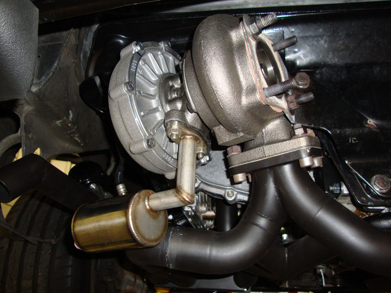

Rarly8 Headers Change Silikon hoses to Aluflex
The Silikon hoses with the heat insulation tape was not mine.
I have made an aluminum adapter for the Aluflex.
but first comes the 3ldz out

Adapter for Heater Box (new all in Black)
New Paint in black with Adapter
New K27/29

New Aluflex Tubes
I like the Aluflex vs Silikon Tubes (with heat Tape)

Modification Air Filter Box
I still had problems with the fitting between the TK intercooler and the Air Filter Box.
Again i cut some Piece out and fix it together.

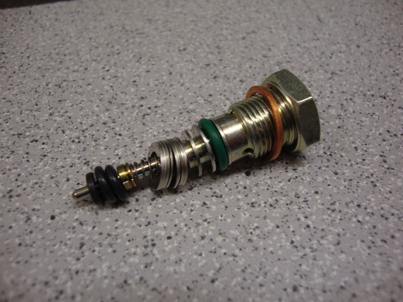

CIS Testing
CIS Test:
System pressure was too low:
I have ordered a new system pressure regulator to fix the Problem

Installing Fuel Pressure Regulator and Damper
I have also ordered the Fuel Pressure Diaphragm Damper (was installed in the 930/66 S)
New Parts:
