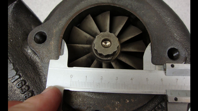

930/66's Avatar
Join Date: Sep 2011
Location: Switzerland
Posts: 307
I have send the Turbo back to Brian for check it
I have found a picture of my old K27/7200 (sold a few years ago) see at the oil outlet no hole
The K27/29 have a rectangular hole that looks not original, maybe thats the Problem.
K27/7200:
K27/29:
I talk with a turbo Guy from here. There are 124 versions of the Bearing housing with 4 different slide bearing for the K27 Turbo.
Then came the Turbo back from the repair:
The bearing housing was replaced as the original had been modified for use in a racing application requiring more flow than the standard 930 system.
Brian has reimburse my shipping cost as well
The Support and Help from Brian is absolut amazing!!!

Again Blue Smoke
3 weeks ago I have set the boost pressure to 1 bar for 50 Miles all fine / Turbo works good!
After that I've noticed the boost pressure builds on stutterly......an then blue smoke...oil.oil...oil.
First i cleaning all and change again the turbo to my old 3LDZ = test drive = no blue smoke
I have send the Turbo back to Brian for a second one....
we will see whats happen...now I'm waiting for a response

Brian has given me an answer:
The failure #2 was due to the compressor nut coming loose.
A new turbo wil build and come to me for installing.

2.New Turbo
Some Weeks ago ich have received a brand new Turbo from Brian.
Thanks again for your support!!!
after 1300 miles i recheck the valve clearance, all good.
I let you now when i make my first test drive with the new turbo
87 930 3.4, BW EFR 7670, TK Long Neck IC, Fabspeed Headers, 964 NW`s, Ported Heads, Tial F46 (0.4Bar Spring), Turbosmart EBC, BL WUR with rpm switch /solenoid, SDS CPI Ignition, modified Muffler, and many other little mods
Old 11-27-2014, 12:26 PM
  Pelican Parts Catalog | Tech Articles | Promos & Specials    Reply With Quote #139 (permalink)
930/66's Avatar
Join Date: Sep 2011
Posts: 307
It goes on
So the second new turbo is in the Car, he is different to the first one....
Hotside is smaller / Coldside as before:
Old new
New
K27 has 2 Version
