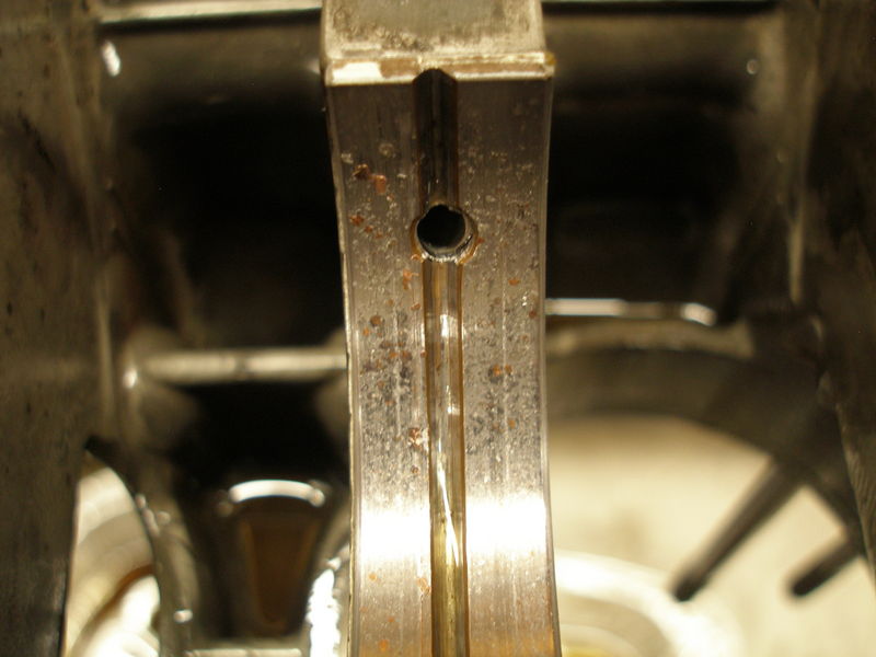

Did detonation kill my bottom end?
Last fall I blew 5 out of the six head gaskets due to detonation. Rebuilt the top end and was running it in the shop last week when it suddenly locked up. Engine would not move either way. Pulled it out AGAIN and found two rods had spun the rod bearings. Numbers 3 and 4. I had gone to great lengths to insure I would always have oil to the rods. I had cross drilled the crank, grooved all of the main bearings and installed a 993 oil pump. It had good oil pressure when I was running it, ie 25 psi at idle.
I was wondering if this failure didn't start last fall when I detonated this 12.5:1 compression engine. Here are some pictures of the bearings,

I don't see evidence of detonation on your bearings; I do see a lot of FOD caused by metallic debris and possible evidence of incorrectly sized big ends on the rods. I'd have to measure the latter to be sure.
Detonation manifests itself on piston crowns, ring lands, pin bores, upper rod bearing shells, as well as other places.

The FOD is from the bearings that spun. I had the rods resized and checked them with plastic gauge. Does the fact that the two outer most rods spun have any significance? What is odd is I didn't hear any knocking and it had good oil pressure.

#2 & #5 are the weak links; i.e,..the last part of the whole engine to get any oil.
FOD shows up at #1 & #6, first. Doing the forensics is a very detailed complex process that also involves cutting the oil filter(s) open with a special cutter and laying the paper element out on a clean sheet of butcher paper to inspect everything VERY closely.
I don't have anywhere near enough information here to offer something constructive, but if you really want to know what happened and in what order, you need a pro who specializes in 911 race engines to do this.

I went to my machine shop today, bad parts in hand to discuss what happened. Looking at the bearings and the crankshaft my guy surmised the rod bearings did go dry. It was hard for me to believe since I had done so much work to get oil to the rods. He agreed but, pointed out all that work I did was the problem. The cross drilling of all the mains, grooving the main bearings, not running the restrictors in the heads and notching the rods to squirt the bottom of the pistons was all good....for over 4000 rpm running. It is all terrible for idle. He said this has been dying a slow death for some time. My oil pressure at idle was low but I thought that is what the sixes do. He said nothing lower than 20psi.
So a little medicine is good, a lot not so much.
To add more damage to my wallet he said I had to replace, not flush, all of my oil lines. He has seen the metal bits imbed themselves into the rubber liner only to come loose later. Oil cooler replace. Oil tank complete disassembly. Clean, clean, clean.
I feel he is correct The new crank I will cross drill the center bearing only, run the head restrictors and use a case with piston squirters not notched rods.

I see some questions in the photos first you have grooves cut in all the mains, when cross drilling the crank I have seen the center main grooved AND the feed in the case bored a bit larger. Why are all the main bearings cut? What was done to the crank? What was drilled?
As Bob pointed out flow is what keeps things happy bearing wise. When you did your build what clearance did you go for on the rods? The side clearance is one "control point" but the bearing clearance is THE BIG control point. When set on the tight side I have seen some of what you show on the bearings.
If you have factory oil squirters in the case why did you add the rod notch? Install larger squirters, they limit low pressure flow the notch does not.

Yes all the mains were drilled and I drilled them all the way through. I was trying to maximize the oil flow to the rods. I built the engine two years ago so my recollection is a bit dimmed. I think the rods had a clearance of 0.0015. I do not remember the side clearance but I have to assume it was within spec.
The case did not have oil squirters thus the notches.
Neil,
Sorry to hear about your failure. I know the feeling. Been there done that on my last engine build. I quoted the above not to add insult to injury, but to reinforce the importance of cleaning everything. You can't risk an "encore presentation" like Steve often says. You have to clean absolutely everything. EVERYTHING.
Engine case needs nearly all the plugs pulled to get junk out of all the oil passage.
Factory oil tank can be ultrasonically done by aviation place like Pacific Oil Cooler or the like. Oil passages and the screen in the factory tank are big enough that ultrasonic will get it clean and it'll come back looking like new. I recall your oil tank is a Peterson style, so that should be easy peasy to clean yourself.
Oil cooler(s)? I wouldn't risk it. The passages in them are tight and I would think the potential for junk hiding in there is high and can dislodge in the future. Replacement coolers are expensive, sure. But a lot cheaper than another smoked engine.
Oil lines? Yep. Take all your braided stainless hose and junk it. At least you can reuse the fittings.
Crack open your thermostat(s) and clean those. I found all sorts of FOD in my factory '78 external t-stat that would just be waiting to trash my "new" engine.
