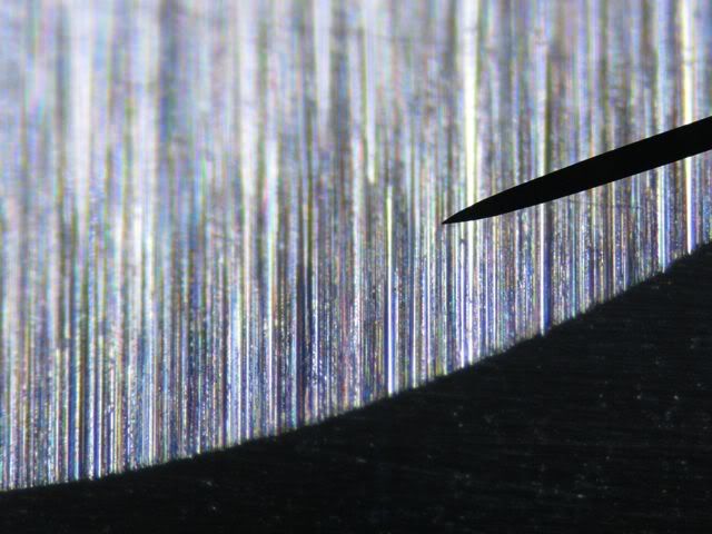

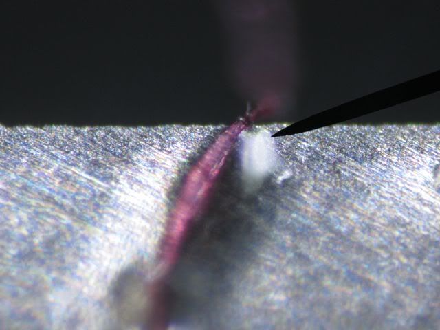

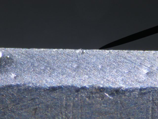

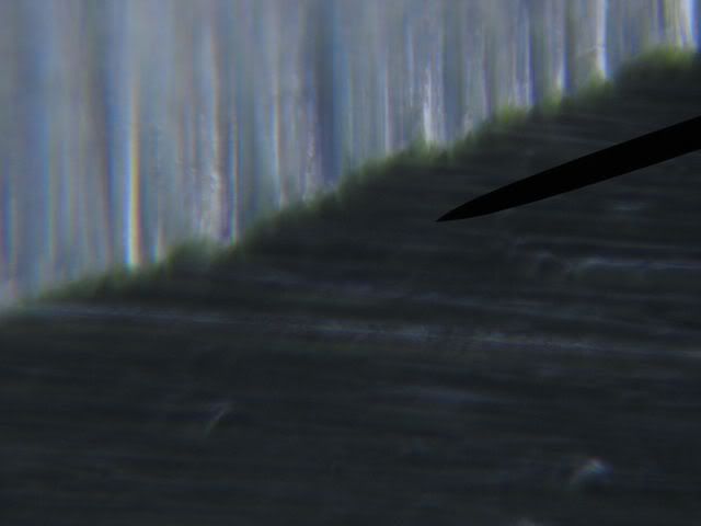

Dredging up this thread because I took some photos that might be interesting.
They show the micro-serrations on knife blades.
This is a Victorinox serrated bread slicer, pretty new, never sharpened. You can see the factory sharpening is rough (intentionally, I think), and leaves tiny serrations on the wavy edge.
serrated mag 1
Here is a more magnified photo. It is hard to focus at this magnification, I didn't do a good job, but even so the micro-serrations are clearly visible.

By contrast, here is an old (50 y/o?) carbon steel slicer, about 14'' long, that has been re-sharpened and honed on a waterstone, the last time maybe a couple months ago. Even at lowest magnification you can see the edge is smoother, with minimal micro-serrations.
carbon mag 1
This more magnified picture again shows the relative smoothness of the edge. It also shows that I need to clean my knives better, I think that's a tiny (not really visible to the naked eye) bit from the last meat this slicer cut.
