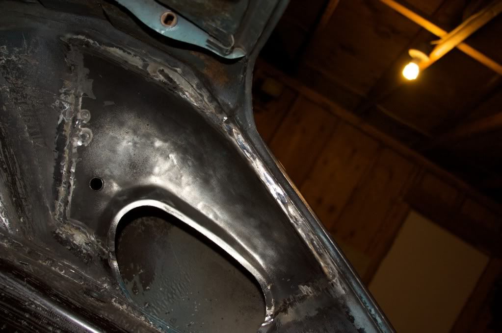

At this point, I'm doing some rust repair prior to having the whole car media blasted. Some was completed by the PO. When I got the car, it came already mounted on a homemade rotisserie and boxes and boxes of parts.
Like some others on this site, I'm a better grinder than welder...
If you sub to this thread, be prepared for about a year or so. The immediate goal is to have the car painted by this time next year.
Suggestions, advice, comments are welcome.
Enjoy!
The car
Typical rust area repaired!

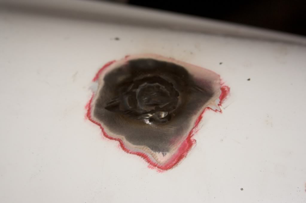

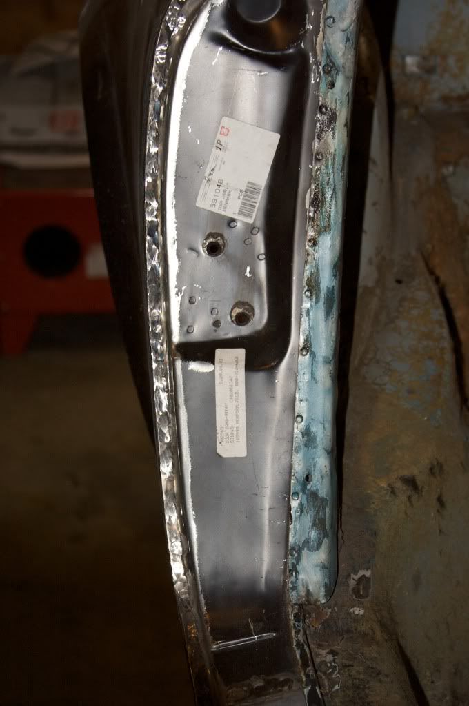

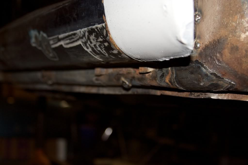

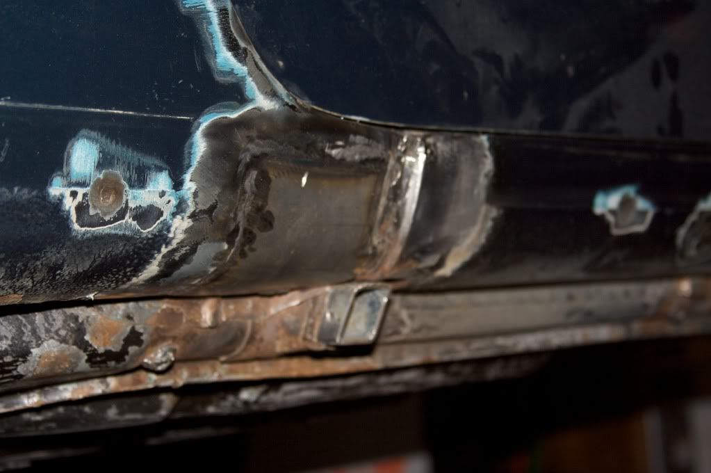

The following pictures tell the story of how I spent my two week vacation. I didn't work on it every day but at least every other day. Some things are more time consuming than others. Things don't always go as planned. All of the work being performed is in order to erradicate the cancer and prepare the car for the media blaster dude.
This one took awhile... rusted panel around oil tank replaced!
A bit of rust repair on the right rear quarter and trimming of the jack receiver. You can kinda see the nuts I welded on for the installation of the oil lines.
Passenger side door striker plate now welded in place.
Antenna hole... gone! Found some bondo on the fenders I bought, ugh!
Another patch repair made.
And finally the last panel to be replaced. It may not look bad but it's rusted badly from the other side.

I found more rust... the worst yet. The heavy duty bracket that the rear bumper mounts to (drivers side) is beyond repair and needs to be replaced. You can see the bracket in question in the previous picture before I cut into it. Unfortunately the rust has found it's way into the frame rail. I can get a couple of the parts needed new, but if anyone has that rear bracket, let me know. I need it!

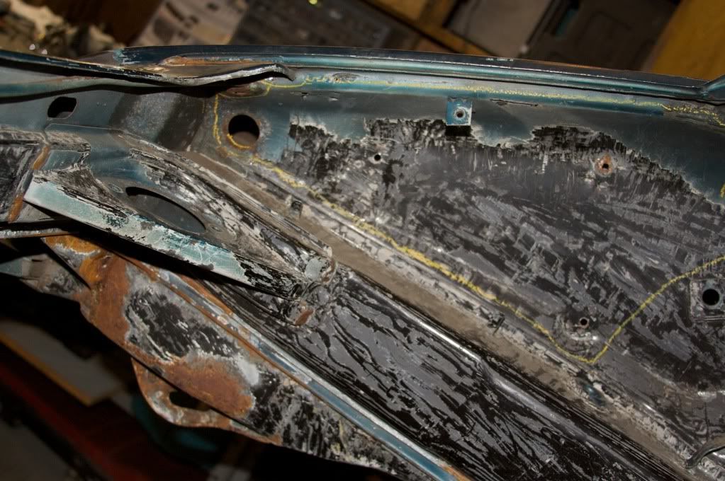

Today, I got out the heat gun for some fun with that tar like crap on the floor pan... weighed it when I was done to. 14 lbs. is what the trusty bathroom scale came up with. I'm sure there's a thread on weights but I thought I'd post this here. I will be putting some sound dampening materials back in the car but hopefully when all is said and done, it will be a net loss of some significance.

Part no. for the striker plate?
It looks in your photos that the part nos are
591048 for the (R) passenger side and
591047 for the (L) driver side
But this is not Porsche catalog format eg
911-502-042-03 (R)
911-502-041-03 (L)
Old 02-09-2010, 11:35 AM

And yes, the parts are NON-Porsche repros. They came with the car when I bought it. Do you need the part nos.? Supplier? I have the receipt... somewhere.

? Spotwelding the outer stricker plate seam to fender panel ?
Derek one more question please,
How do you spotweld the stricker plate to the rear 1/4 along the fender outer edge? (Not the 3 ply seam in the middle)
You have access from the door sill on the one side and the wheel well on the other. It seems you can't apply a pincher there - so says my shop technician. His electro-spot-welding gear is like a pincher and is applied as a clamp. You can't fit tongs around the fender wheelhouse, is there other equipment?

I don't even have a spot welder. I use a mig for everything. I'm hoping your shop technician is a body guy. If not, you may want to take it to someone qualified to do this. There is quite a bit of trimming to be done on the new piece to get it to fit properly. If it's not done correctly, the door gap will be off and the 1/4 panel curve (profile) won't be right.
That said, the flange for the new panel fits in behind the quarter panel. So, once the spot welds have been drilled out and the new panel fitted, the spot's can be filled from the jam side with a mig welder. In places where the new panel would not quite draw tight to the quarter panel, I drlled a small hole through both panels and used a sheet metal screw to close up the gap. After welding, the screw can be removed and the hole filled with the mig. After all that, the welds are then ground flat.
Also there are a few spot welds along the B pillar that can't be welded using a spot welder. They are near the top of the door jam.

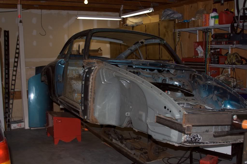

More photos re: rust...
Rusted wheel house panel... Ick! Notice the dirt clod lookin thing I found inside the frame rail. It looks like it was made by Bees/Wasps and is made from dirt... how'd that get in there??? I found another one inside the rear shock support tube. I had to cut it open to remove the mess!
Prepped and ready for some fresh metal
Here's the new (used) panel ready for install
The replacement panel has been welded in and the body is back on the rotisserie. I have to bump (I think that's the lingo) a small piece that the donor car was missing so I'll post some photos of it all when it's finished.

Derek great thread. How difficult was it to replace the fender support in picture #1? Once you drilled out the spot welds how did you trial fit to make sure it fit?
