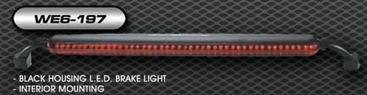

Resurrected this thread b/c I finally installed a third brake LED light in my 911.
Bought the same exact light at Autozone ($18) and also picked up some clear 5 min epoxy ($2). Steps: Mounted the light bar with epoxy, removed the back deck lid, tucked the wires in the rear window trim, snaked the wires through the firewall hole (with coat hanger), hooked 'em up. By the way, the brake wire is also black with a yellow stripe on SCs. Grounded it right next to the ignition box. Good to go.
The hardest part was getting the epoxy to stick. When I applied the epoxy the first time only one side stuck. The second time I made sure not to press very hard. The side I did twice actually came out looking better b/c it is totally clear, i.e. all you see it the black plastic. The side that stuck the first time is kind of hazy, oh well, next time, don't push so hard.
I didn't time myself but it seemed like it took about 2-3 hours, or the time to drink four Newcastles. I bet I could do it in half the time a second time around.
Here's to safety...
EDIT: I ended up cutting the wires after I mounted the light and snaked them through. I didn't want any extra wire-age hanging out back there.

I bought one a few weeks ago, but haven't gotten around to putting it in. I'll have to try the coat hanger...I tried some braided wire and couldn't get it through the opening. Now the roll bar blocks the upper part of the window anyway, so I won't even notice the install.

Yeah, use a little electrical tape to secure the wires onto the wire coat hanger and push it from the inside out. It is actually reeeeally easy. Looks like Ghia pulled the wires through... whatever works.

Anyone have one of these installed in a coupe? If so, lets see some daylight pictures of the install. I have an oem light mounted to the bottom of my window and am not happy with it; I'm still contemplating this LED light. The targa bar will hide the light, but the coupe doesn't have anything to hide it. Also, in a coupe, where would you hide the wires?

wires would be tucked into the rear window seam. At least that's my plan.

Please excuse the picture quality. I installed mine on a coupe. Installed on the top of the rear glass. From there I started feeding the wire into the rear window rubber. I thought it would be tough getting the wire in there, but it literally took me 5 minutes. The only thing that slightly bothers me can be seen in picture three. A tiny section of the wire running from the window seal into the engine compartment is exposed. I was thinking of coloring that part of the wire black to blend it into the interior, but I'll probably end up leaving it as is. It's not visable unless your looking for it.

Hey guys, this is my car (UTKarmanGhia's former car) now and attached brake light. Just an FYI the light is still working fine but one of the mounts cracked and broke.
So I removed the mounts and by coincidence used "Scotch CLEAR Mounting Tape Heavy Duty" as described in a post above (from 2003). Works fine.

I have a coupe and mounted the same bar. I originally tried a top of the window mount - but found it obscured my rearward vision - even when I took the feet off and heavy duty velcro mounted as high as possible. Got to see the gendarmes in the rear view mirror at a distance.
Instead I velcro mounted it to my parcel shelf - again without the feet, to keep it as stealth as possible - it blends in well against the black.
Totally stealth when off.
