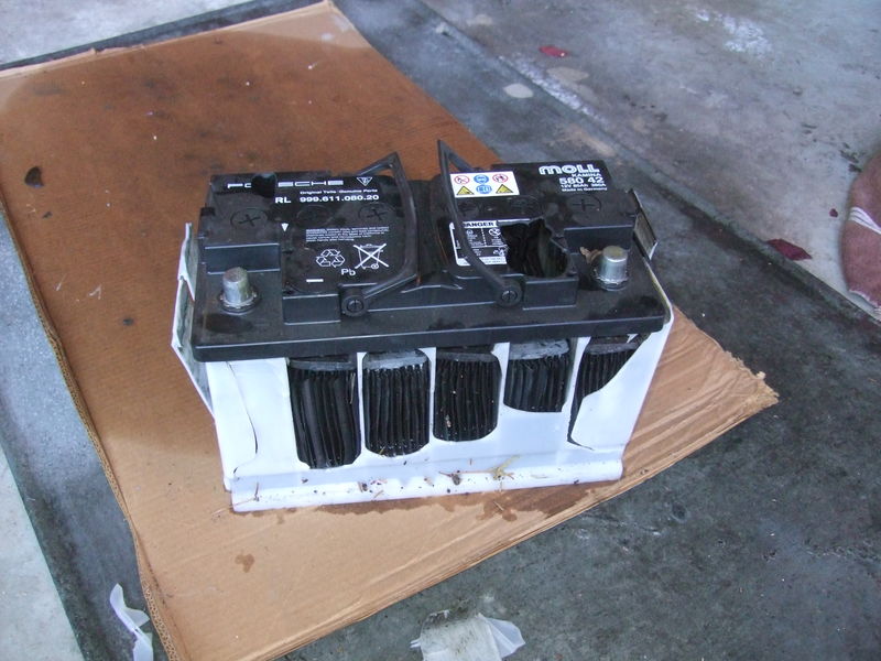

Posts: 1,486
I leave the hood up, either all the way or propped up with a scrap piece of wood. The frunk light has been disconnected. I've never had a charging battery explode (or heard of that happening), but that's what the instructions warn about, so I don't bother chancing it.
Good idea about keeping the lid open, I do. Here is a picture of what happened to one of my neighbors 996 battery on a trickle charger with the frunk lid closed. Went kaboom with the turn of the key.
What a mess to clean up

Perhaps he should have invested the $25 in a smart tender...and an AMG battery...
There isn't much reason not to leave your battery on a modern tender if you aren't gonna drive it for a week, and the frunk isn't air-tight.

I have a battery tender on my 911. I have it plugged in, and the trunk lid lowered, but not locked down, the extension cord has plenty of room to not get squeezed.
I figure hydrogen is 1/2 the molecular weight of helium. There is plenty of space for the hydrogen to float off into the air with the trunk not sealed shut.
After 25 years of doing it that way I have never had the slightest worry. It is just maintaining the charged battery. If I was doing a full charge from flat, I would open the trunk and disconnect the trunk light. I have never had a flat battery on my 911 since I use the maintainer.
