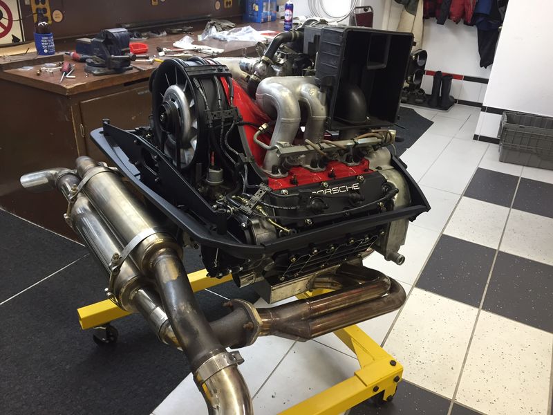

I've always used an ATV jack with some 2x4s across the top to support the headers. From there I lower the 2x4s onto stacks of wood, then pile enough wood on top of the ATV jack to get it up to the right height to get the engine on an engine stand. If you're splitting the case you really want the appropriate Porsche yoke.
This is an excellent time to convince yourself to buy a quickjack or other lift to get the engine in and out. It's sooooo much easier just going up and down precisely with a button while also keeping the body level.

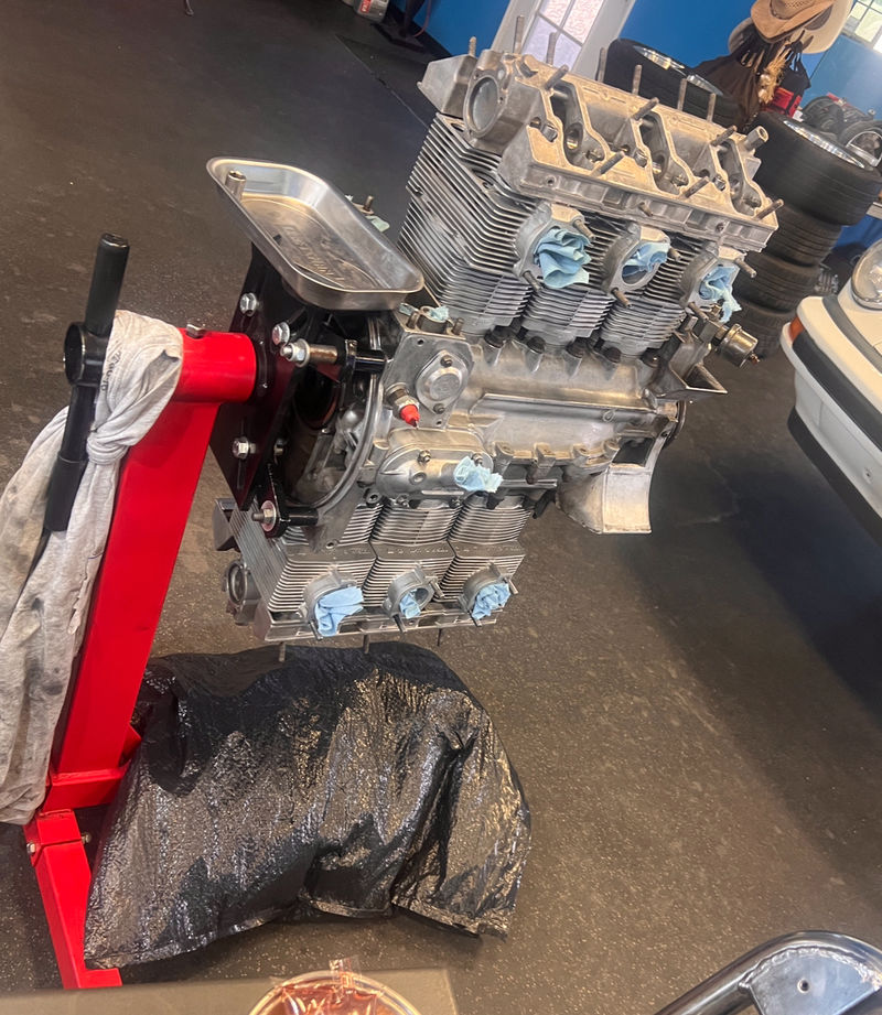

Should I get the engine yoke to mate the HF stand to the engine? PP has one but it is out of stock. The engine stand seems to have some sort of generic one.
https://www.harborfreight.com/1000-lb-capacity-engine-stand-59201.html

You really need the proper yoke. I like the heavy duty stand for stability and you can put a tray under it.

I bought the 1000lb unit from HF and it worked great. One slight mod a friend helped me make is to re-mount the folding handle so that it folds away from the table deck instead of towards. This allows you to not have to worry about clearance under the rear bumper/chassis. It requires you to use two hands to activate the lowering lever when the handle is lowered (one to hold tension on the cable guide and one to squeeze the lever) Easily reversible if needed in the future.
I already had a geared head 1000lb folding engine stand I bought from JEGS 10 or 12 years ago when I needed to R&R the 5.0L in my 928 S4. The key is to get something with a very stable and wide leg structure to minimize the risk of tipping the whole thing over when rotating the engine. I have a washing machine drain pan that I toss on the legs when doing engine work to keep the mess off the floor.

You can drill slots in the harbor freight engine mount to fit.

No offence, but there is now way I would do this. You are now holding up the engine by the 4 holes in the case. When you use the proper yoke it presses against 2/3 of the case and spreads the weight out. The 4 bolts just keep it in position.
