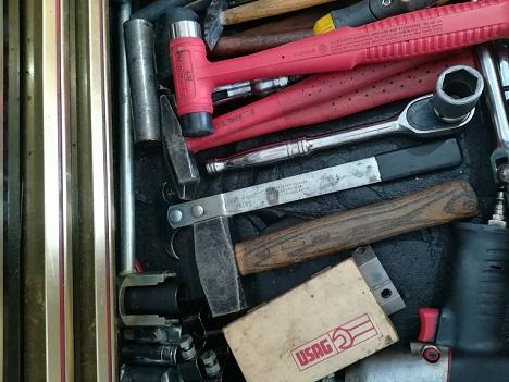

This helped:
Sorry to revive an old thread here, but this really helped me with a stubborn flywheel seal.
The picture shows the tip of an extractor/slide hammer tool.
I inserted a wood screw in the back end of the tip, screwed it in and
then tightened the tip with a hose clamp. It did not work to secure
the screw with the hose clamp alone, it needed more of a mechanical barrier.
I think it also helped that I crushed the seal lip at the 1 o'clock position.
