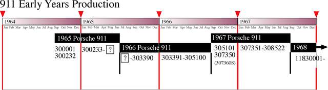

Will this help the discussion?

Bob,
Pretty good chart. Very clear to understand.

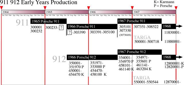

Does the 912 numbers differ from the 911 numbers. As I understood it the 912 is a 911 with a four cylinder engine? My 912's numbers are 351907 and paint code 6606 and is registered as a 1966. Looking at the charts posted the 351 number seems to be way out?
Any comments?

Yes, the '12 numbers are all different.

The 912 expands the number range because both Porsche and Karmann were making bodies and each have a unique serial number.
Starting in calendar year 1967 is the "Targa" body style, with its own numbering.
There are further model breakdown by 911 and 911S but there are no records for separating the two in 1966/67 as both used the common sequence of numbers. Bruce Anderson was able to talk with the factory and has probably the most accurate numbers for 911S from this period.
Bob
