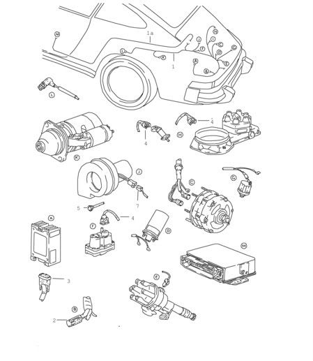

All right guys, you've changed your 02 Sensor only to find the male connector crumbled as soon as you pulled off the old sensor rubber cover. Revealing a green wire and stab. What the Duck
What the Heck do you do? Take out the electrical tape, silicon glue, or even cut the brand new O2 Sensor rubber sleeve so that you can insert the stab?
Unfortunately that yellowish plastic part is not replaceable and one must invest $800-1300, yes $800-1300 to replace the entire harness which is connected to the DME, UNACCEPTABLE! (Thanks SloDave for the info) Part area #1

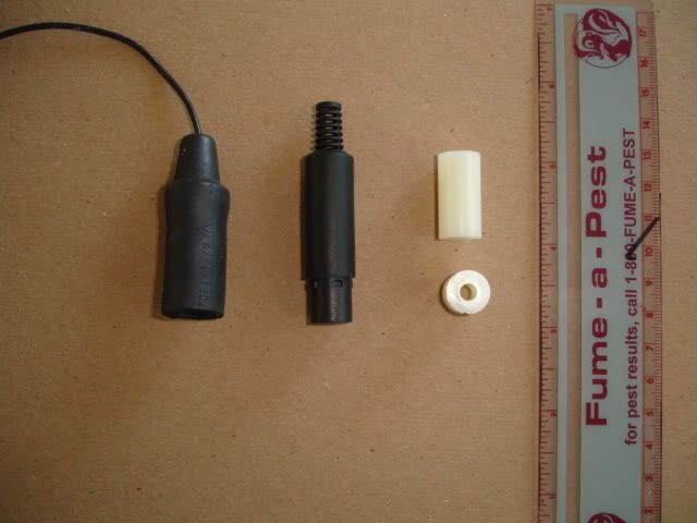

Here is my humble fix:
Total Cost = $1.29 USD
1" Nylon Spacer $0.33 (1"x1/2"x 1/8 dia. whole)
1/2" Nylon Spacer $0.30 (1/2"x1/2"x1/8 dia. whole)
Male DIN 8 Pin Connector $0.63 (only need the sleeve to fit the 1/2" outer diameter of the spacers)
Sales Tax: $0.03
1. Take off the rest of the yellowish plastic, it is dust anyways.
2. Crazy Glue/ Epoxy the the spacers together
Note: There must be a good reason for the engineers to put so much rubber around that connection. Errand sparks i.e. electrical fire? I do believe it is the heating wire for the O2 Sensor (Vets please correct me if I am wrong)
3. Using a carving/engraving Dremel tool, cut an 1/8' slot down the side center and a divet to match the locking divet in the New O2 Sensor. Use a clamp for better support
4. Bevel the the two ends so it will slide into the new O2 Sensor's protective rubber sleeve and the DIN 8 Pin Sleeve, It will make your Mod Part slip on more easily while working in the engine compartment. You may choose not to use the DIN 8 Pin Sleeve but I figure I would add extra insulation for this area.
I used a bit of lube on the DIN 8 Pin side to make sure it won't be difficult to slip on inside the engine compartment. The new O2 Sensor side is perfect, just don't over dremel the divet, test to fit.

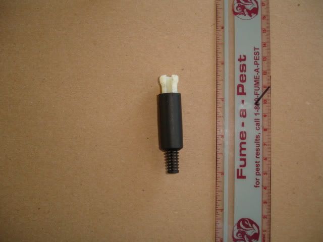

5. Test with old O2 Sensor
Note the stab is a hair wider then the 1/8" whole but with the slot, it will fit. I decided to use liquid electrical tape to ensure the stab and wire will stay in place.
Caution, It is tight in there becareful not to damage the 3 plugs on the brass harness, the one with the CHTS and Ref/Speed Sensors. I detached and moved them out of the way. It allows more room to manuveur.
I tested this with only a 1/2" sloted spacer it worked but was too short to be supported by the bracket. this new 1.5" length is almost the same length of the OEM.
Break a Leg.

Caution, make certain the crimp is not falling apart.
I ended up using insulated male and female "Bullet" connectors. I had some shorting issues so was forced to solder mine crimps to allow for a good signal.
I understand from some that you do not want to solder, but in my case I had to,

For future reference, Bosch makes a universal O2 sensor that mathces the characteristics of the OEM sensor. THe part numbers are:
15725 ( 0258005725)...universal type
15726 ( 0258005726)...universal type
I forget which one I got (one has a longer harness than the otehr). This kit includes a very nice, sealed connector that will perform as well or better than the stock. I got this for a bit less than $50 at the local auto parts store. These part numbers were recommended by Bosch as a replacement for our engines.
They use the rubber connectors because the O2 sensor is designed to pull reference air through the wire. The best practice for designers is to keep the wire connection air tight through the harness and let it pull air from the intrior of vehicle. This is way it is suggest not to solder, as the rubber can melt and possibly hamper the air flow through the wire. The sensor does not require much air and it is able to pull what it needs through the wire.
