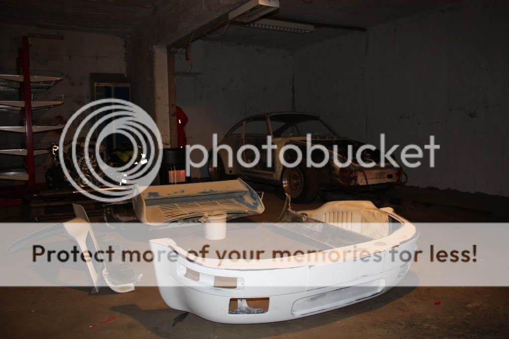

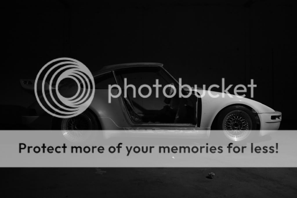

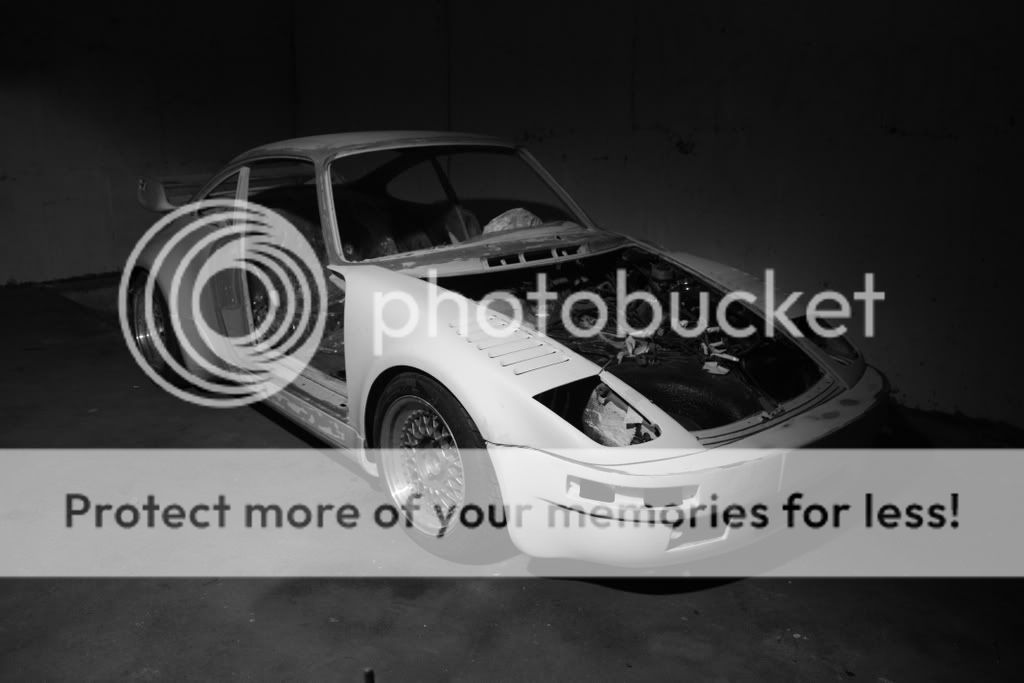

3.6 v.ram conversion + modify rest of the car
Now its almost one year since my last post here.... Almost finished all of the upgrades on the car. Suspension, brakes, bodywork and transmission.
The plan is to get the engine in next week.
During the last year i have moved my project to another location, took up too much space at home.
Finally start to see how everything will look like when its finished.
Also having big plans for the transmission side-cover, bught a piece of titanium and made a 3d model in SolidEdge, hopefully i will find some time to produce it in the cnc mill this summer, WHEN the car is finished.
Espen

I've got to say: your photography skills for those indoor shots are impressive.

yes way cool, l don't normaly like the slant nose but the pictures make it look sooo good! Lets say around 2200lbs with 250 bhp.......NICE

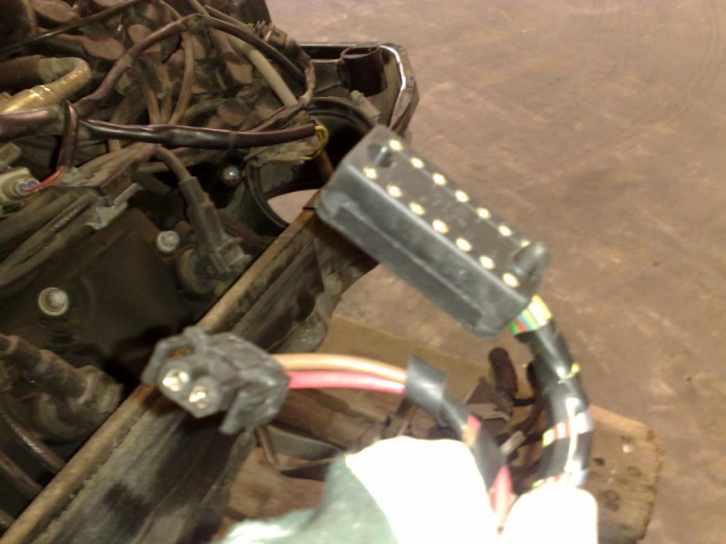

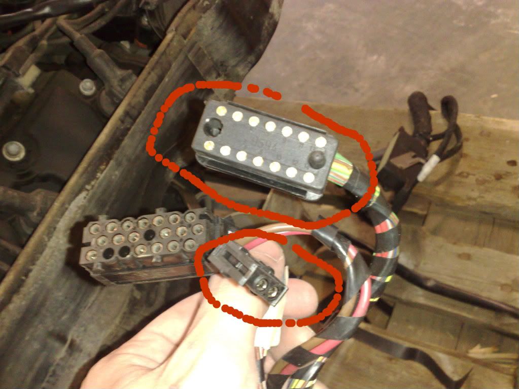

I just bought my engine (1997) on thursday, anfd now im thinking about ordering the modification kit from Timmins.
At this point, if I may "steal" your thread", I have one question:
What are the 2 connections in engine wiring harness for? I only have the the engine to ecu harness, and it doesnt include anything for these two:

Those look like the heater fan leads, and I'd do some research on Timmins before spending money. There are options for the necessary parts.

The 14-pin connector goes to the old harness, there is only one pin to change, i found out when i used amperemeter to check ALL the wiring, reading connection pin by pin, one side to the other.
Patrick harness came with easy instructions, installed in 1 hour... Pms has diagnostic port as well, forgot to say that when i answered your pm.
Good luck, if you have more questions, fire away
