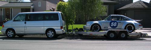

I have a Trailex Ct7541, the bed is 12'9", 19'6" overall, 880#. I wouldn't want to go smaller
I completely agree with BV's suggestion. Although a 12-footer could haul a 911 conveniently, a longer bed will offer better stability for cross tie-down straps. A single axle could carry a 911 too but very close to the load capacity and a two-axle with electric brakes feels better in hi-way driving.
My trailer (steel) is a 14-foot bed, double axle with electric brakes and very happy with it. But I wish I could afford and justify buying an aluminum trailer like what BV's has. That's the perfect size for my need (CT7541).
Tony

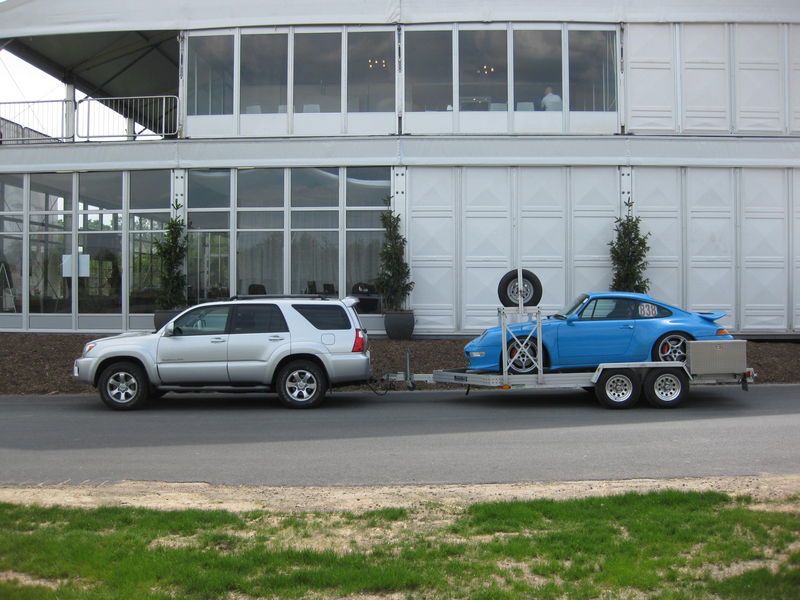

I have a custom built single axel aluminum trailer that weighs about 500#. It has a 3500# axle. It is about 1 foot shorter than the Trailex that Bill posted a picture of. The axle is set back such that it is just about where the jack receptacle is located on the car. I am towing with my wife's 97 Pathfinder and it rolls along the interstate at 75 with no problem. The car is light (2000# track car) so I am well within the capacity of the GVW of both truck and trailer capacity. I do not typically haul much for spares to DEs. No extra wheels or large tool boxes.
Here is the only picture I could find of the car on the trailer. This was my targa at the soda blaster.
Oh yeah, I used to tow the car with the Volvo Wagon (my parts chaser).

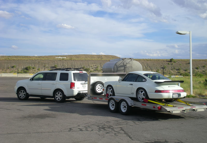

Here is my Featherlite 17' weighs around 1650 lbs with dual axle brakes, air dam and two spare tires.
I would never tow a car on a single axle trailer.
