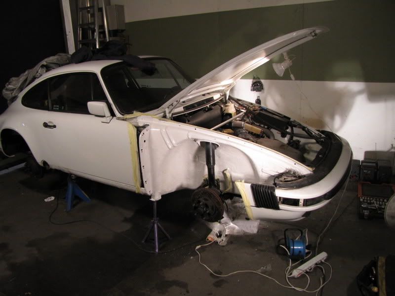

Thanks for the advices!
ATM I´m running only one carrera cooler with a big scoop under the spoiler as well the foglight removed. Plus fan offcourse. It is not enough for the track.
What is the exact size or model of the coolers you are using? It would be great that the fittings would be on the top or bottom.

Can you fit an 993 cooler to the right fender? I think that might do the trick too? The i could use the original carrera cooler as a plan B to the drivers side.
Simpler is always better.
But the place looks a bit thight:
I might have to measure my friends 993´s cooler.
964/993 oil coolers are mounted sideways, the chassis has ducts built in
passenger side
drivers side
they are mounted in series, one wasn't enough to keep my 3.8 oil temp under control on hot track days.
One valance mount has been fine for street use w/ both 3.6 and 3.8
the guys that track similarly set up early cars need a bigger valance mount and often a second fender mount, again usually in series, the only problem w/ parallel plumbing is that you will get proportional flow which depends on the cooler internal resistance, you also see less rise in pressures. W/ series all the oil goes thru all the available cooling but you also see a rise in pressures. the pressure rise doesn't present a problem. Randy's 2 fender mounts are in series and the valance mount is in parallel. Probably a good way to go if you have 3
