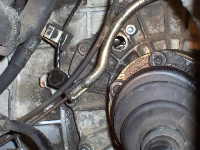

G50 Speedometer Sensor Problem
My speedometer ('87) was dead below 30 mph and then would spring to life and work properly. The odometer has always worked right.
I found this and replaced the $70 sensor:
http://forums.pelicanparts.com/uploads15/G50impulse1248984991.jpg
I still had problems. The speedometer would come to life at lower speed, but then would operate erratically with no real relation to actual speed.
I figure the problem must be within the speedometer so I sent it off to North Hollywood Speedometer, along with $147.
I reinstalled it and now the needle bounces below 20 and registers erratically above that, generally settling around 40 mph regardless of speed.
What do I look at next? Dirty or missing magnets possibly? How many magnets do the G50's use? I know that earlier transmissions use eight. Any tricks to getting them clean without disassembly?
Thank you.

UPDATE:
I was going to try swapping back to the original sender and try it with the refurb'd speedo. I had originally swapped it from underneath with the car on ramps. This time, I put it on jack stands and removed the driver's side rear wheel. Much better. I was able to remove the sender through the wheel well. After removing the bolt, I pulled it out and tried cleaning the magnets (eight). I used a small piece of dowel and a rag. I poked the rag through the sender hole and turned the brake rotor by hand. I decided to pop that sender back in and test it out.
I was a little surprised and very happy to find that the speedometer now worked much better. It was a still few MPH off from the GPS, but I expected that and, overall, I'm satisfied.
Next time, I'll clean the magnets first and maybe I can save two hundred bucks.

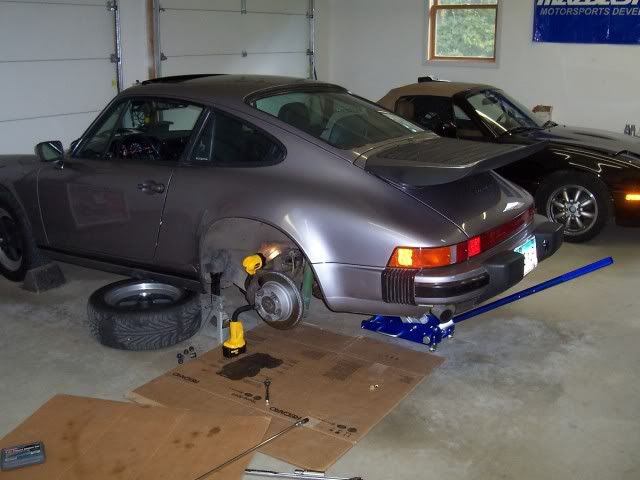

David,
The only difficult part was snaking the wire up and over the transmission.
When I disconnected the old sensor behind the front seats, I tied a string to the end and pulled it up and over the transmission housing. Then I pulled the new sensor wire back over with the string. Just pull gently and help it along with your hands, as there are a lot of places where it can get snagged.
Use jack stands, not ramps, and remove the driver's side rear wheel (G50 cars). You'll be able to see where the sensor goes into the transmission from the side of the car.
Actually, I had a hard time pressing the rubber grommet back into the hole in the floor pan as well, but eventually it went in.
Photobucket
Photobucket
The second photo shows the hole with the sensor removed. The sensor wire DOES NOT go through the plastic clip as shown. I just put it through there to keep it out of the way when I cleaned the magnets.
When you install the new sensor, put a little oil on the o-ring, make sure the area around the hole is clean and make sure the sensor goes in straight. I used a new spring clip ($6) and I put some Loctite on the bolt. It's a small bolt so don't over tighten it. The the wire goes up and over the top of the transmission and back through the floor pan into the back seat area.
