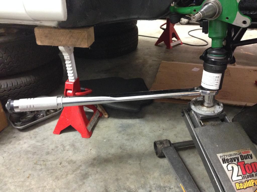

I torqued mine with the $12.57 tool from Amazon. Free delivery with Prime membership. It worked like a charm. I will say that I had tightened the ring nuts with a pipe wrench first and when I used the tool I got in the mail, one side was tight enough and the other was close (it only turned slightly).

Can someone explain what is happening in this photo?
Is the torque wrench facing up or down?
It looks like you're screwing in the jack plate!
Originally Posted by RD911T View Post
[IMG][/IMG]
1986 Bosch Icon Wipers coupe.
Old 11-26-2014, 10:02 AM
Join Date: Nov 2009
Location: London, Ontario
Posts: 278
My guess is that he put a loose socket under the head of the torque wrench so that the torque wrench didn't bind against the jack
Old 11-26-2014, 11:04 AM
Join Date: Jul 2010
Location: Cape Girardeau, MO
Posts: 1,087
Quinlan has it right. The torque wrench is connected to the ball joint socket on top of it. The socket underneath is to reduce friction against the jack plate. The jack puts pressure upwards to keep the ball joint socket from slipping off. This was a one foot in the wheel well and two handed torque job. I didn't want the wrench slipping because the stopping point would have been my nuts!
